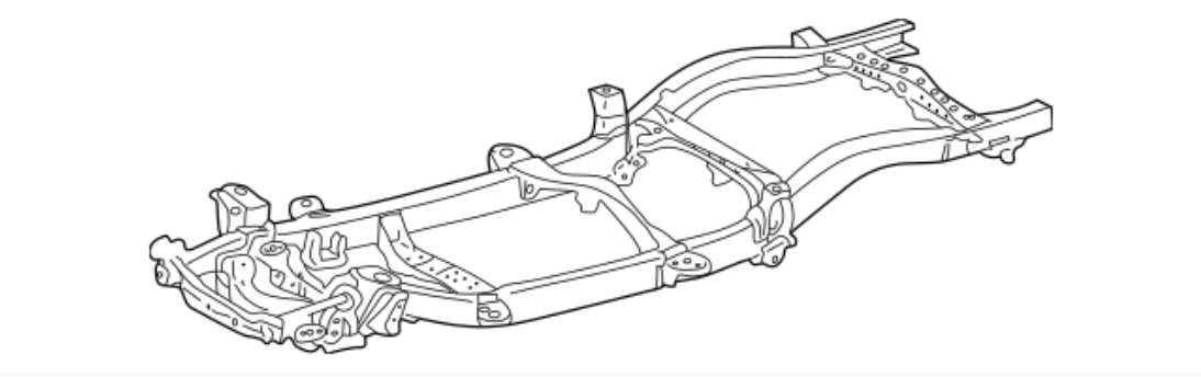

    Looking at the parts diagram "the frame assembly" is what you see on the picture. So the pieces holding the rear bumper are not part of the frame, I guess. But I might be completely wrong.

    I may be having trouble interpreting his photo, but I was thinking the rot was in the section after the rear spring hanger (at the top of the shackle) but ahead of the bumper brackets. If it was just the bumper brackets then I agree, that's not part of the frame. But there's a section of open 'C' frame that extends to the rear. The spare tire hanger crosses there and the rear of the box bolts through there. You can remove the bumper and brackets and still be left with frame all the way back.

    Yes, that is the exact section. C-channel. I'm not referencing the bumper bracket, which is a separate, bolted on part. This is certainly on the frame. It is the most rear 8 inches of it.
