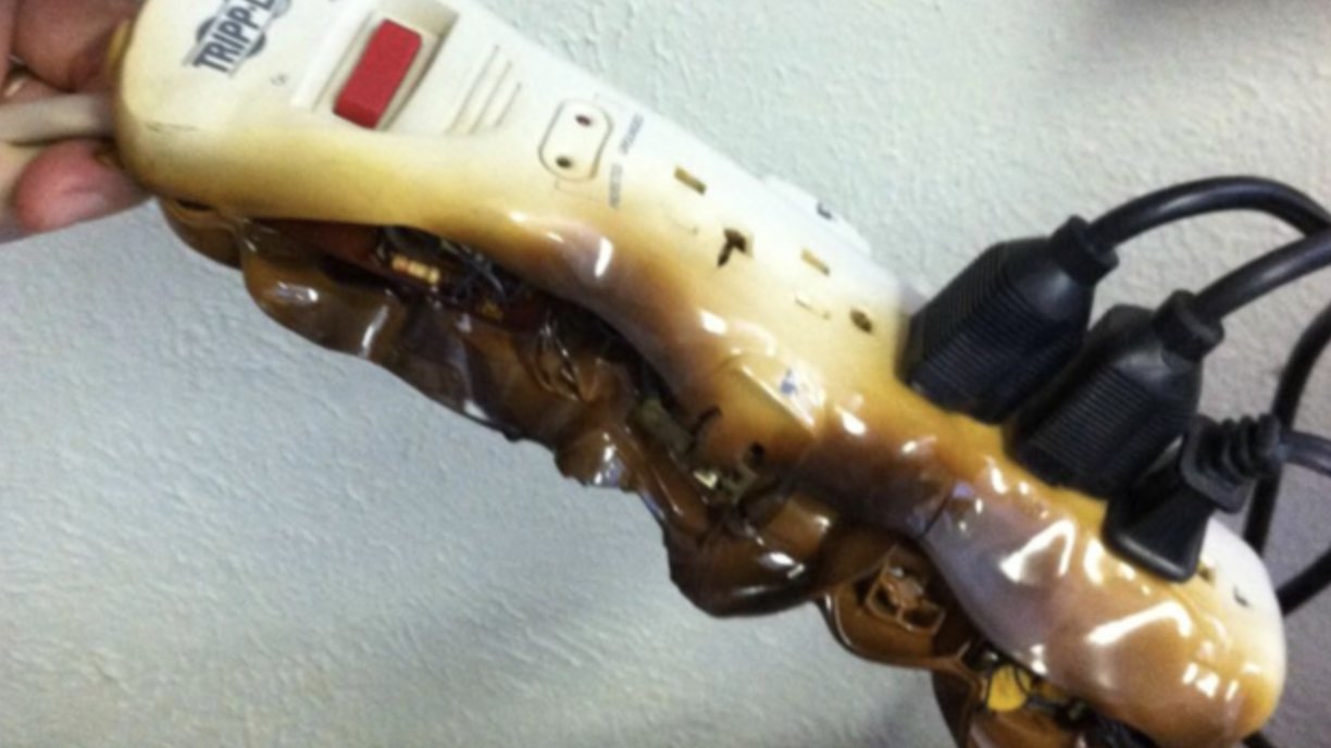

  15. Oct 21, 2023 at 8:38 PM
    #35
    RichochetRabbit
    RichochetRabbit Bing Bing Bing
    Mar 6, 2023
    #419488
    6,318
    Among my standard orange extension cords for the average project, which are 16 or 14 gauge, I have a 12-gauge (matching house wiring) extension cord for those times I CANNOT AFFORD overloading due to power tools.

  17. Oct 21, 2023 at 8:50 PM
    #37
    RichochetRabbit
    Mar 6, 2023
    #419488
    6,318
    Screen Shot 2023-10-21 at 8.49.26 PM.png Screen Shot 2023-10-21 at 8.49.50 PM.png

    That outlet was junk long before it finally burnt up you might notice the supply cord is still intact and it most likely is a #14.
