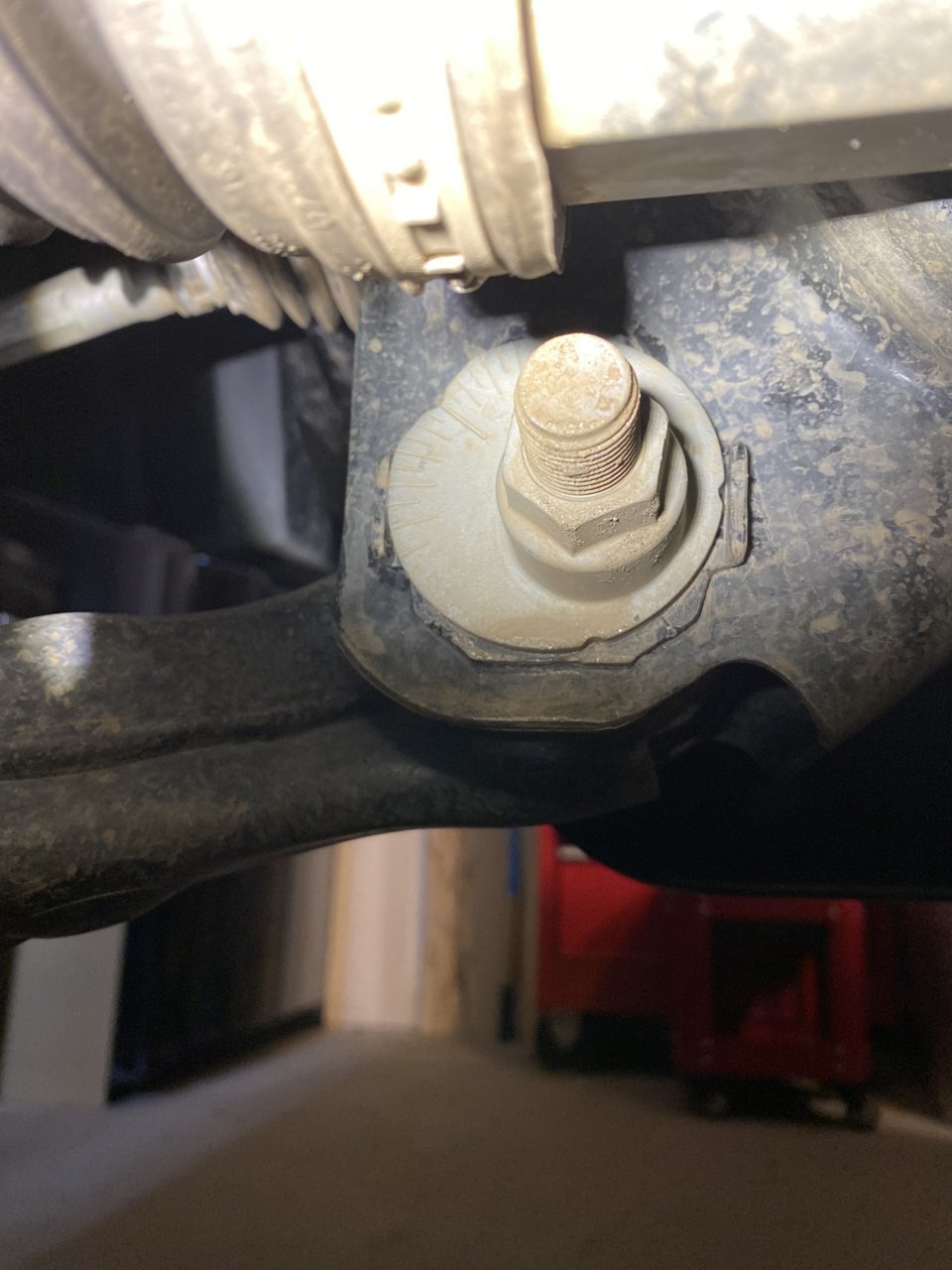

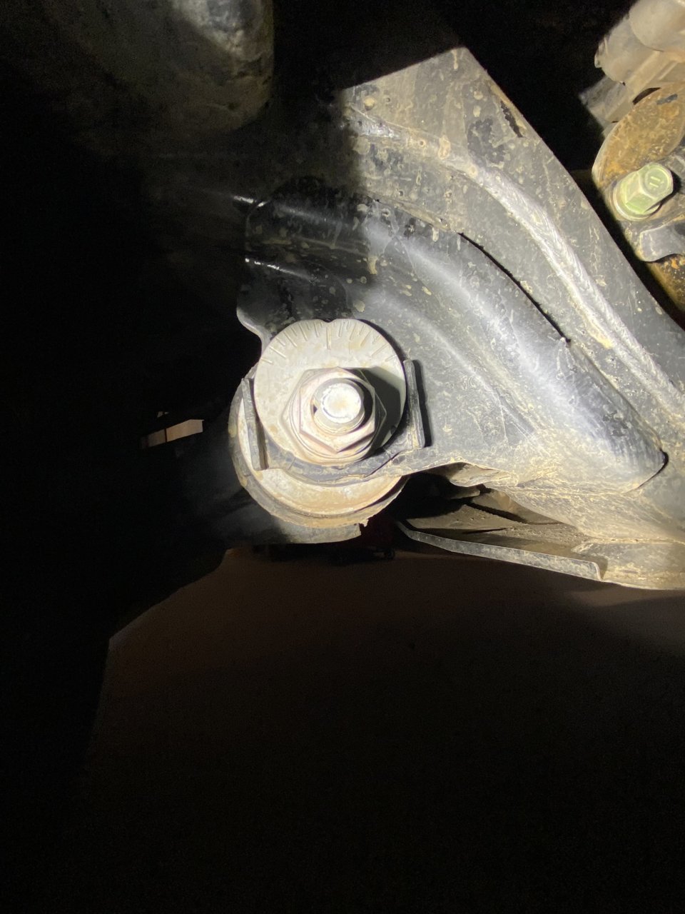

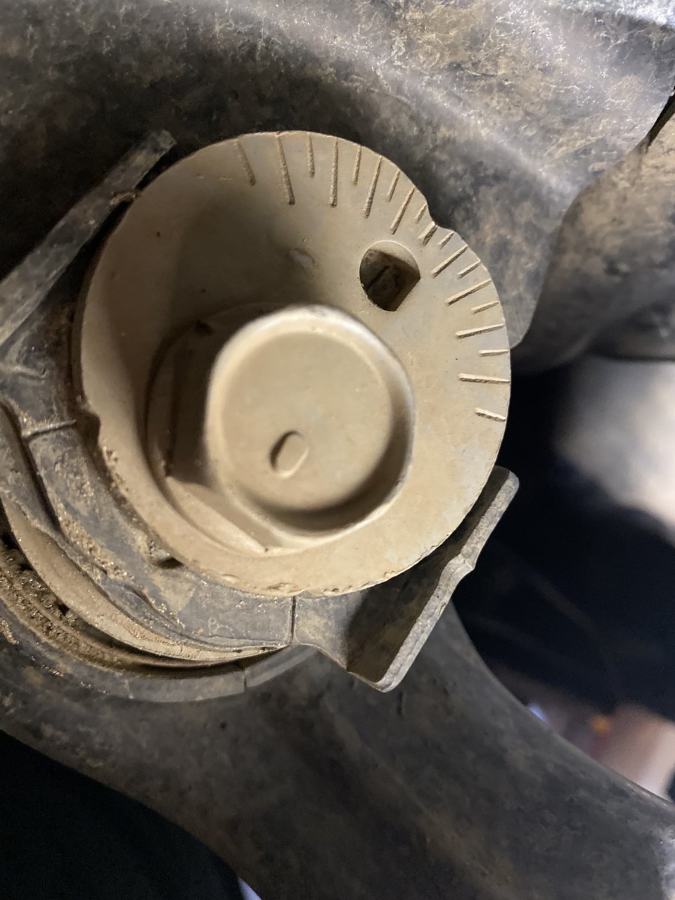

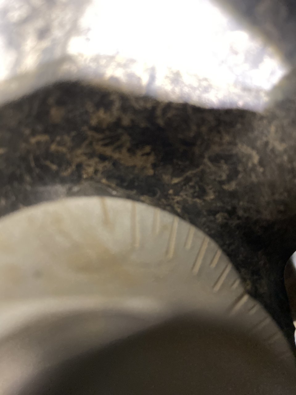

    As am I one of the lucky ones. I have no rub with the same size tires, 2 inch lift SPC adjustable UCA’s. Here are the caster settings. Running TRD Pro 17 inch SEMI. B5BC780D-C55F-4A30-A0FB-CE53B8E166F9.jpg7F1CC9F0-9F2E-49BA-8689-4CE1485AA4E6.jpg63016371-6F1C-43F3-83C8-C2A26648439F.jpg50659389-1EFC-4A10-9145-2756D5F99A3F.jpg
