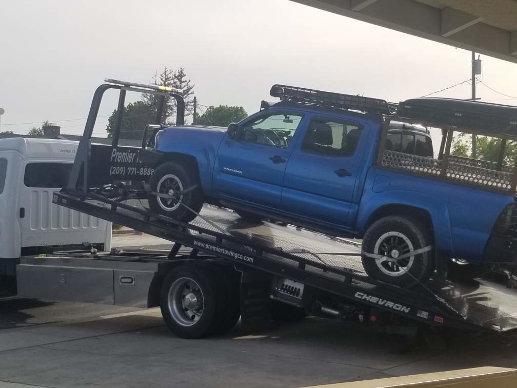

    Just looked at my sons 08 with TRD bead lock 17"'s with 275 70 17. I believe they are 0mm OS with 1" spacers. They do stick outResized_20230509_080754.jpg
