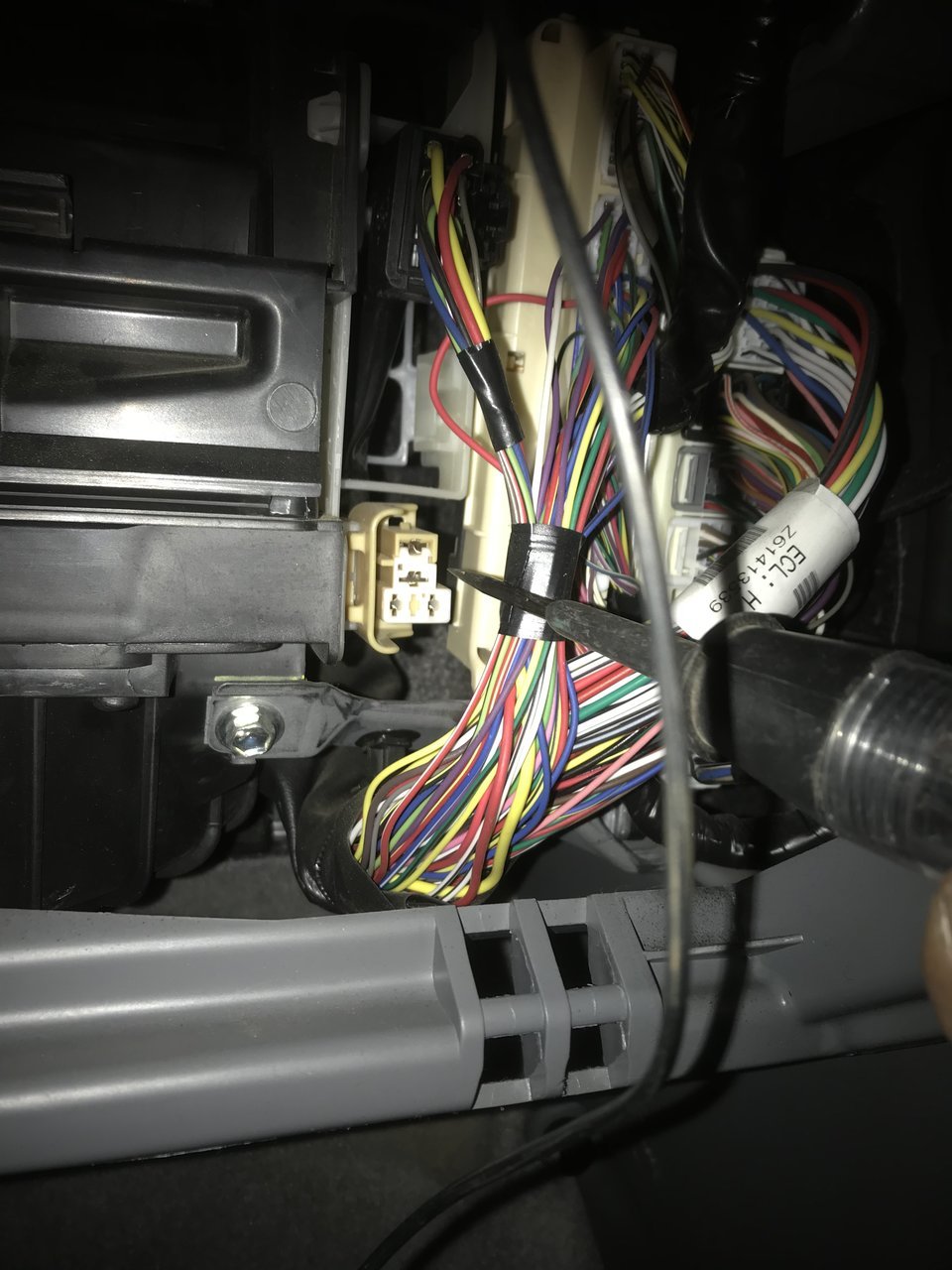

    Looking for a spot to steal keyed power from. I found this sort of spade connector next to the cabin airfilter. Need power for 2-way radio. Can i use it? See attached picture. Thanks.

    It looks like an unused relay location. If no one here knows where it get's it's power from, figure it out yourself. 1 of the terminals should be constant power, 1 key switched trigger power, 1 ground and 1 going to whatever location is not used in your truck. Put your test light in the constant power terminal and start pulling fuses. When the light goes out, see what fuse it is, and if you want to add a load to that circuit. If everything seems cool, snip off the wire that is the other switch contact and run it to your radio. Then just pop in an OEM relay. This is all just making assumptions based on the arrangement of the terminals. If you burn down your truck, it's on you.

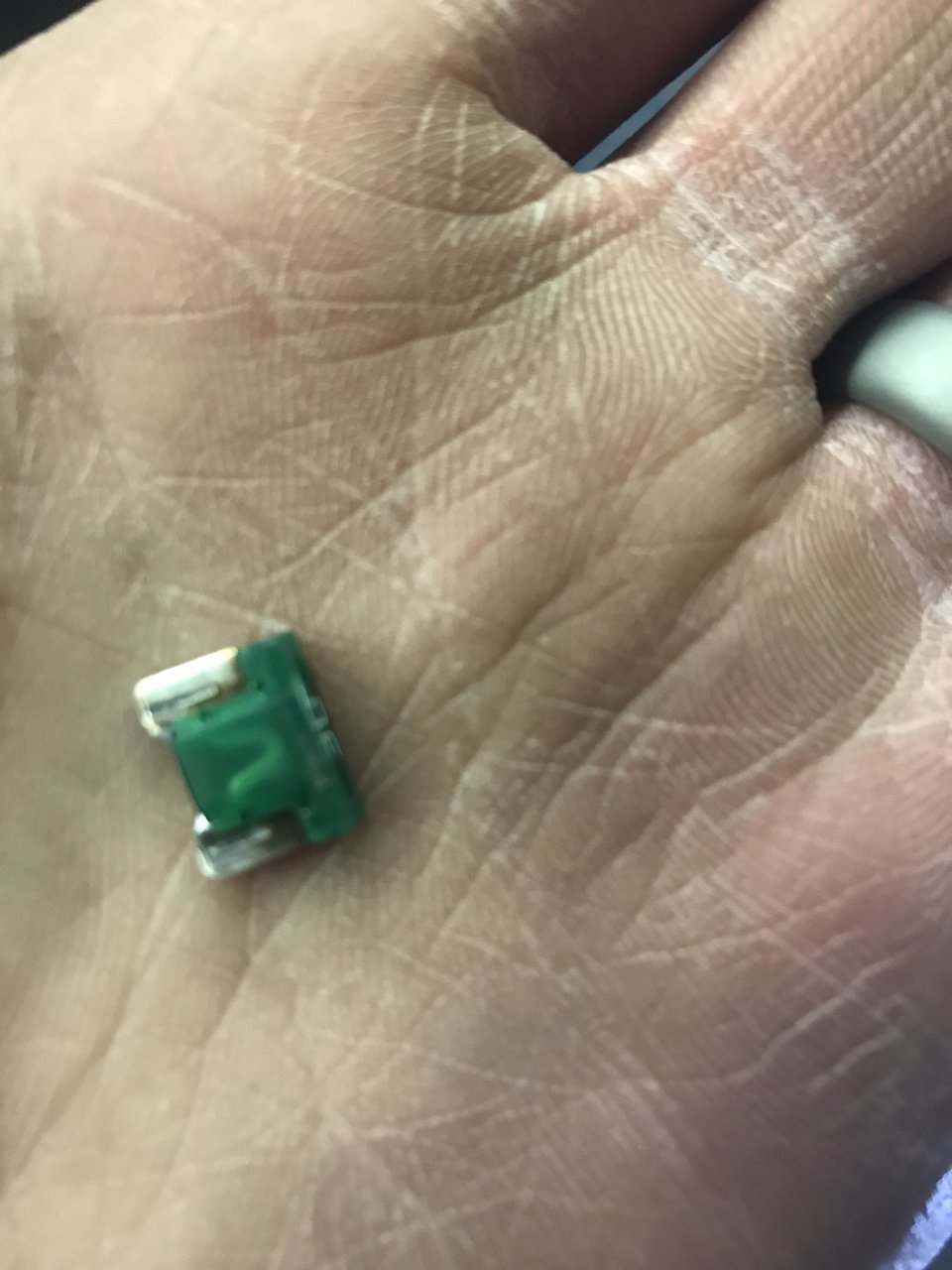

    image.jpg The radio guy told me they sometimes us something like the “add a fuse” but i cant imagine they r available for this style fuse?

    Originally planned on a rear power window until i saw the style fuses. Then started lookung at plan b.

    Well i went to town and found a brass deal that slides in with fuses and leaves you a male spade terminal to connect to. Its not made for micro 2 fuses, its made for regular mini fuses. So a little grinding and trimming i shoved her in. (Never been a fan of two males in one female!) so far its all working good! Thanks for all your advice, and yes i tapped into supply side of rr pw.
