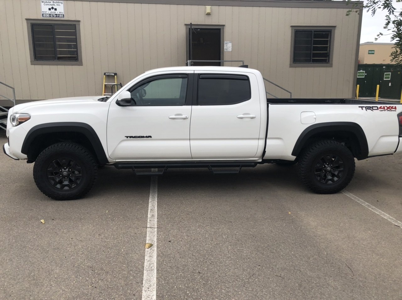

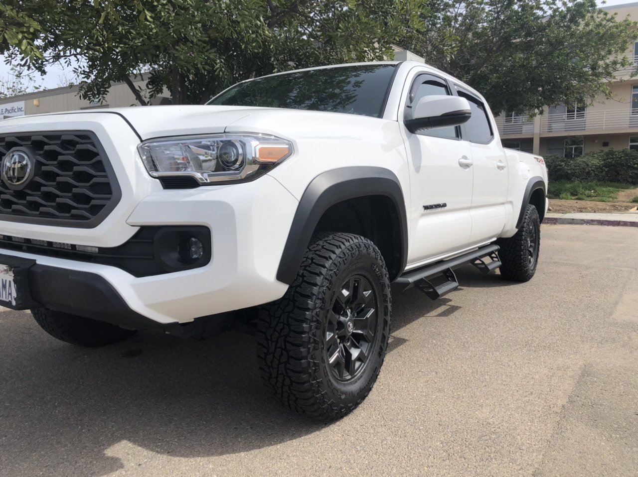

    5100s on middle notch up front and 5100s on rear will raise the front 1.5+” and level the truck. Like this with stock size Ultraterrain ATsB40AF331-8103-4D08-9D05-6C7557BD88B0.jpgAC530338-CC6A-4979-BAA0-8D91624BC7AC.jpg

    Ok. I was thinking that the TRD OR springs on the factory shocks may add some lift. I knew the springs would do the lifting, and not the shocks themselves, but I might should've worded that better in my initial post. Sounds like the OR shocks and springs are not what I need then. Thanks for the input!
  8. Apr 1, 2022 at 8:30 AM
    JHF4X4
    JHF4X4 [OP] Member
    Apr 1, 2022
    #393985
    9
    2016 Tacoma SR5
    That's exactly the stance that I'm wanting! So this is just shocks, and factory springs? Or did you also upgrade springs?

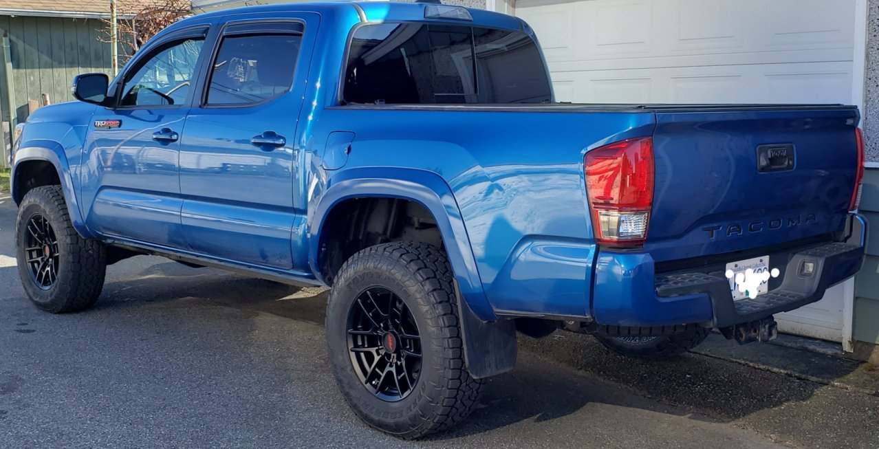

    Another quality entry level lift option is the Eibach Pro-Truck Stage 1 lift. Very similar setup as the Bilstein 5100. Would require a block in the rear as well. As supply issues are out there, thought I would atleast mention an option.
    I am running the Eibach Pro-Truck Stage 2 kit with 1" rear blocks, myself. I am very happy with it.20220309_113958.jpg

    Very nice lift
