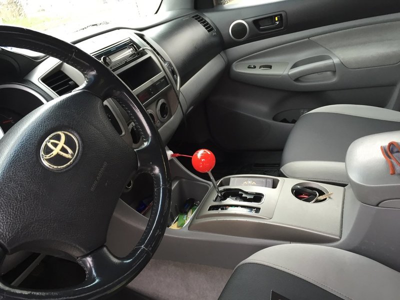

  3. Dec 31, 2015 at 10:05 AM
    #23

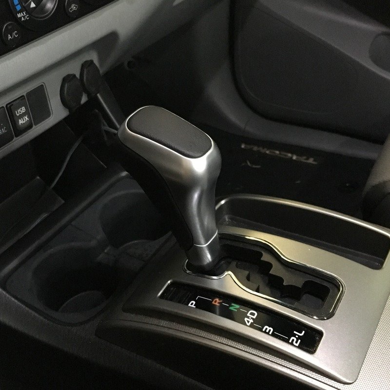

  9. May 1, 2016 at 7:35 PM
    #29
    shuwtist
    shuwtist Enthusiast
    Jul 20, 2015
    #159928
    69
    John
    Northern Virginia
    2015 Tacoma TRD OR magnetic gray
    In development!
    Thanks guys. Added this knob, and love it. I used two nuts, rounded the edges and screwed them on as a stop. I was able to tighten the knob down, and it stopped at the perfect spot. I used a screw in hook to pull the bottom piece off. Very happy with the result.

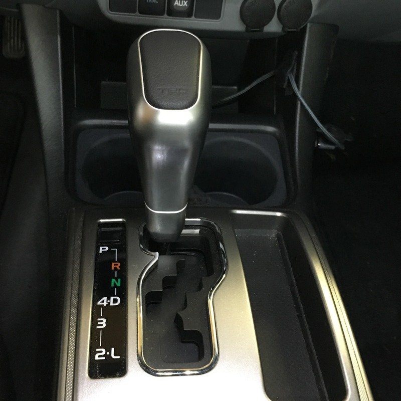

  10. Jun 8, 2016 at 1:06 PM
    #30
    TRD2010SpeedwayBlue
    TRD2010SpeedwayBlue Well-Known Member
    Sep 12, 2015
    #164039
    1,814
    Brandon
    2010 Speedway Blue TRD Offroad
    ok so got my knob today. do i just need what an 8mm locknut so it will fully tighten. it fits and screws on it just spins once i get to the bottom threads so i want to know what i need to get so it will screw on and be tight
  11. Jun 8, 2016 at 1:23 PM
    #31
    shuwtist
    shuwtist Enthusiast
    Jul 20, 2015
    #159928
    69
    John
    Northern Virginia
    In development!
    I used two 8m x 1.25 nuts to create a locking nut to stop the shifter where I wanted it to stop while tightening. Worked out great.

  14. Dec 6, 2017 at 9:28 AM
    #34
    hemitruk
    hemitruk Old man , young boi truk
    Oct 17, 2009
    #24461
    2,302
    Kurt
    Hawaii
    2010 Dbl Cab Sport,
    A few
    Getting exact height would be hard . Maybe piece of vacuum hose might lwork better because it has some give so you can line up knob straight. But if need to might be hard to get hose out .
    Check out out post 10. Second part # seems to work with out modifing. Or you could just cut 7/8 in off bottom of the one I brought more easy .The cut is not that noticeable..Also note top say1/2 in or so gets tight when you tighten knob so you can line ut up and it will stay tight.
