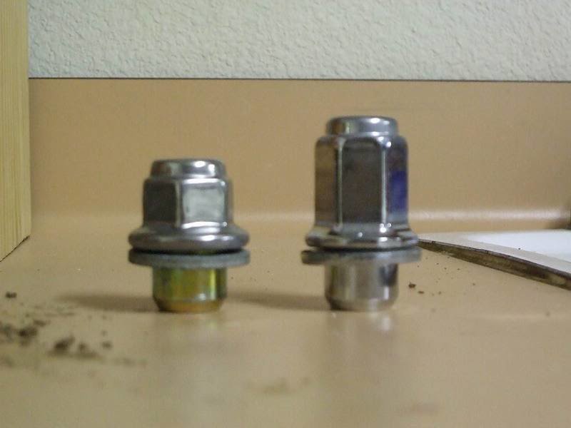

    Thanks for the quick replies everyone! So the lugnuts I need look like this:

    I was lucky when I bought my used wheels they came with the original alloy wheel lug nuts.
    The OEM alloy wheel lug nuts are crazy expensive.
