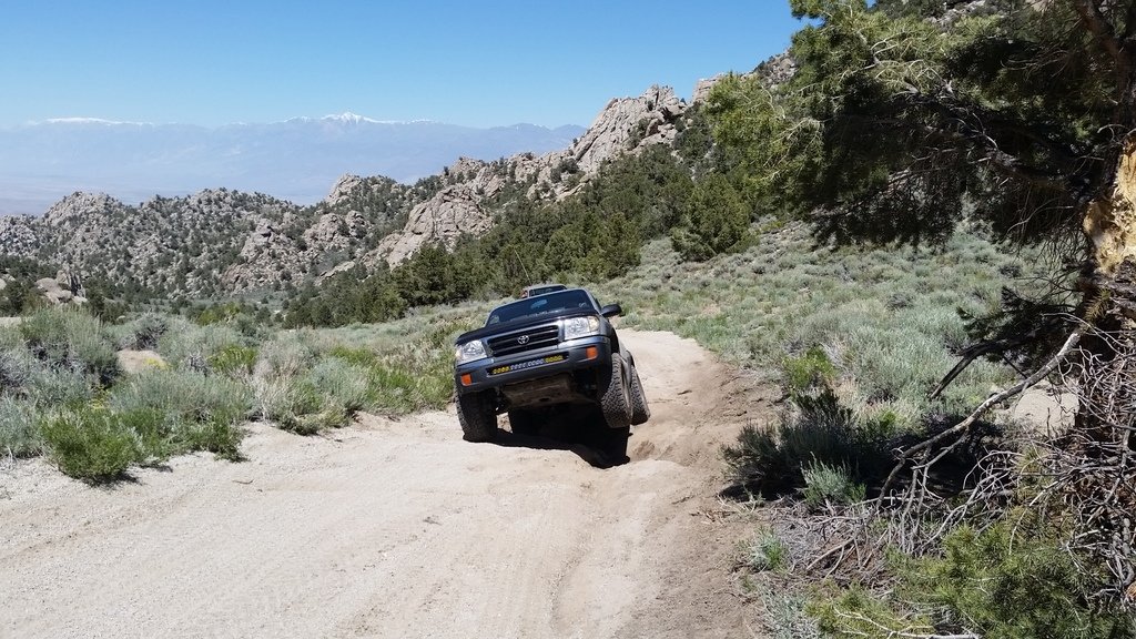

    5100s. eibach coils. 285/75/16 km2s. leer cap
    is it just me or are you guys set up on a hill?

    Haha, just picture angle

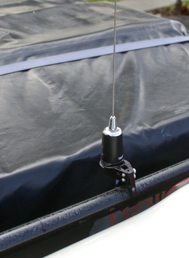

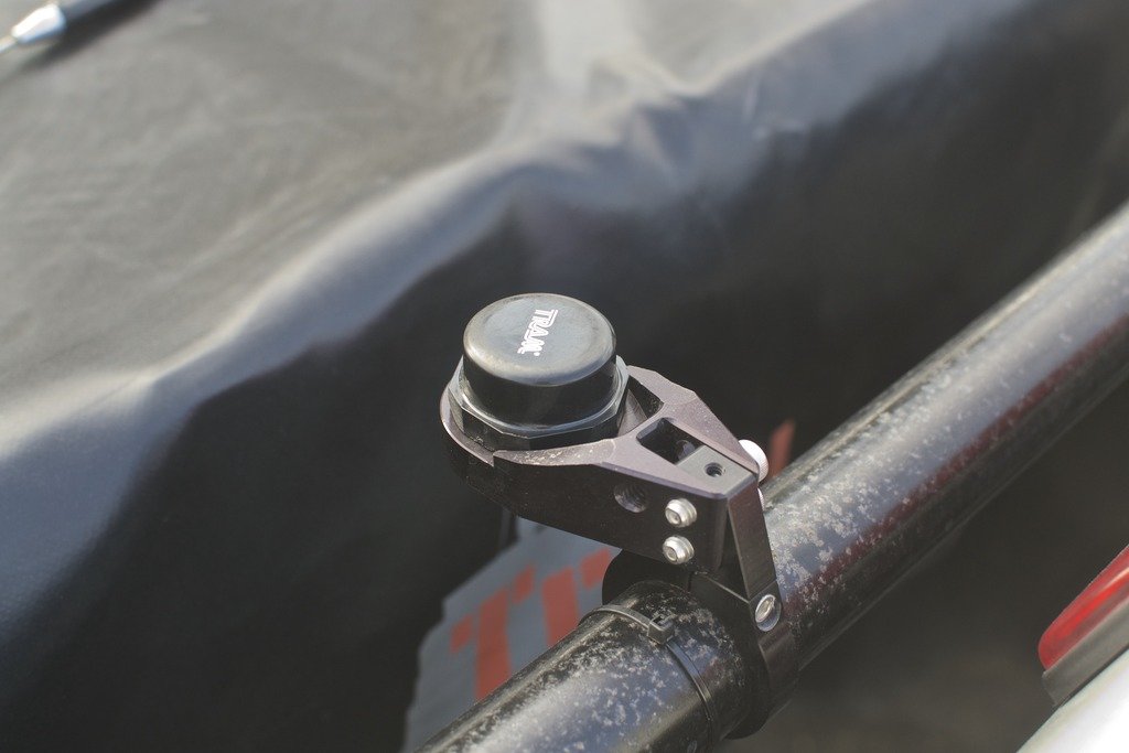

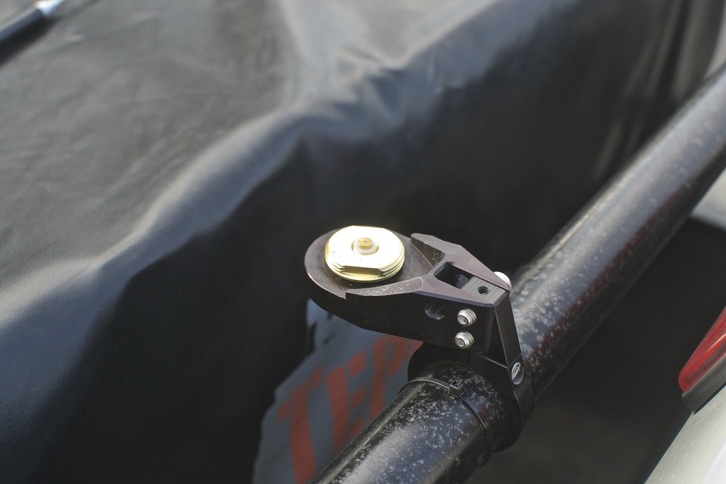

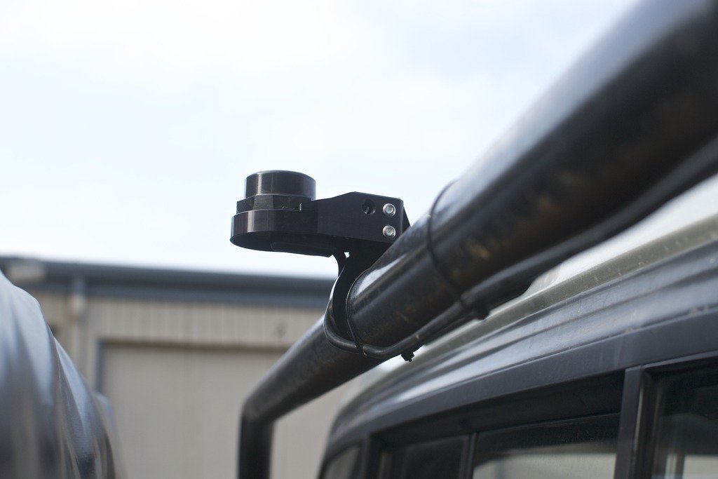

    I hard mounted my antenna to the bed rack. This way i can keep the rear window closed, and possibly even replace it with a one piece window. This also allows me to take the antenna off so i can fit in my garage, parking garages, drive throughs, etc without the fuss of trying to feed the coax under all my stuff etc.

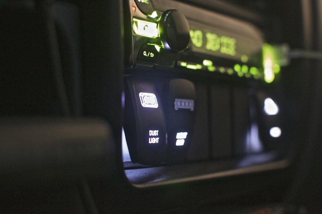

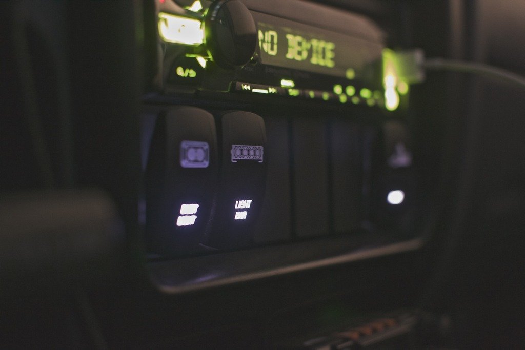

    Finally got around to wiring up my switches so that the lower LED's are illuminated whenever accessory power is on. I.e. whenever the truck is running. I wanted to wire them into the gauge backlight, so they came on when i switched on the headlights, but i could not find a suitable power lead for that.
    The top part of the switch illuminates whenever the accessory is powered on.

    You can get them to turn on with the dash lights and also dim if you splice into the dimmer circuit. Biggest trick is that they dim on the negative side, so you can't jump the negative posts on the switch.

    Thats the issue we were having. Couldn't find a good lead off the dimmer. The switch LED's dim with the dimmer switch when the headlights are on, but are always on otherwise. I already hate electrical, so Toyota's crazy backwards polarity makes my head hurt.

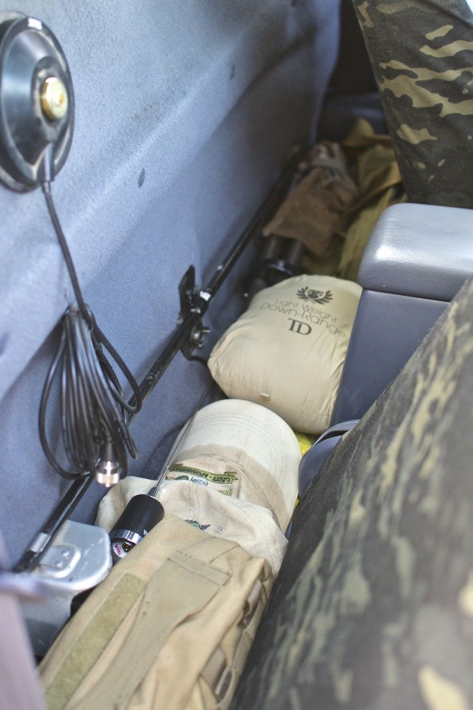

    The area behind the seats is surprisingly spacious. Just a quick list of things currently stored permanently in the cab.
    Behind the drivers seat;
    Large tool bag
    -Jumper Cables
    -ARB quick deflator
    -E-Tool
    -Small tool bag with sockets, ratchets, wrenches, small spares etc.
    Tripod Camp stool
    Behind the Passenger Seat;
    ARB 30,000lb snatch strap in its own bag
    Misc things i leave back there are usually a full nalgene bottle with distilled water
    Spare hats
    Warm down jacket that stuffs into it's own bag
    Gortex parka.
    Radio antenna when not mounted
    I frequently also carry a wool blanket, a pair of 5w handheld radios, granola bars and a small backpack.
