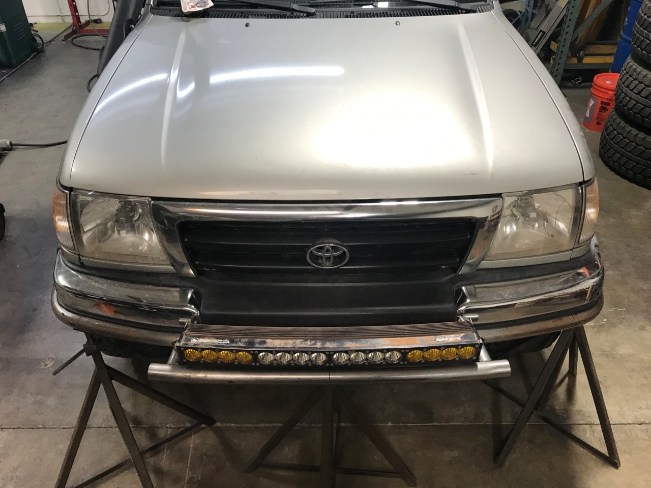

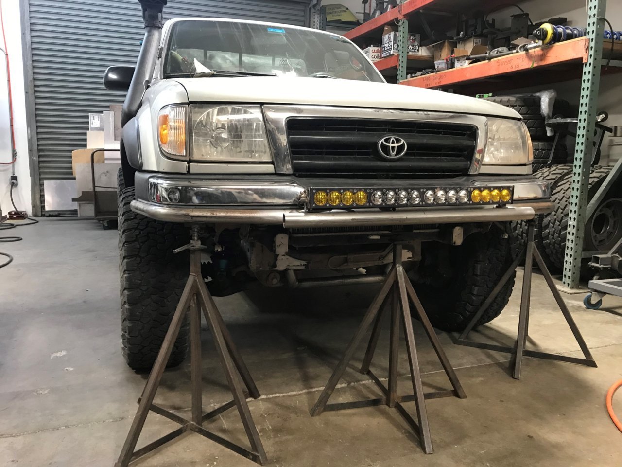

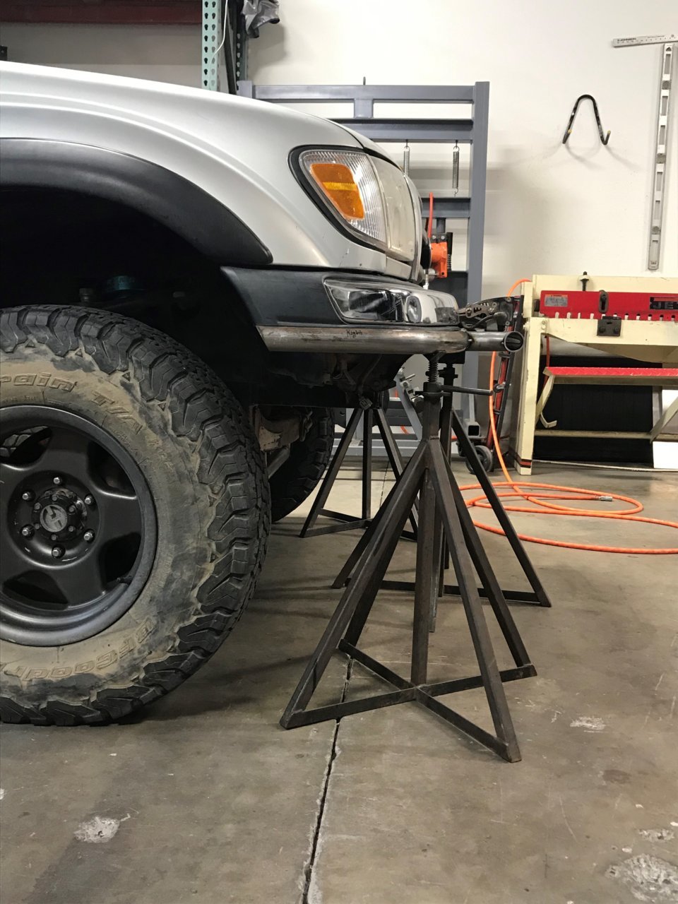

    Finally making some small changes.
    I converted over to the shorter 2.4L radiator a few months ago in preparation for a bumper build. The shorter radiator eliminated the need for a wonky hump in the skid plate.
  10. Nov 30, 2018 at 10:37 AM
    #310
    boostedka
    boostedka Well-Known Member
    Sep 29, 2011
    #64367
    5,997
    James
    NM
    2013 DCSB 6MT, 2004 4runner
    Are you going to retain the upper portion of the stock bumper or are you just using it as a sort of template?
    And what it supporting it with the frame mounts removed?
    Looks like a cool idea so far

    yes, i will be retaining the factory plastic that's left in the pictures. The factory bumper has a stamped steel backing plate that attaches with two bolts to either side of the frame. We left this system intact, so it is still mounted exactly like it was when stock. We will also be adding tabs to the back side on the ends, and using rubber fender washers to keep the end from flopping. Something like the below:

    I like where this is going..
    I don't really love the LED bar part. Sticks out too far. Would have been cooler if you fit it right between the two chrome sections and kept the approach angle down. To me anyways.

    gotta have the nerf bar for maximum bro-points.
    we talked about how far it sticks out. I'm waiting to see what it looks like with the ends capped etc. maybe i'll ditch it, maybe we'll keep it. I didn't want to cut up the remnants of the factory plastic only to change my mind and have to buy another one.
    I love the main bar radius work, and i like where the skid plate angles are going to land. The rest of it can be cut and changed down the road.

    Nice. Stoked to watch. Radius bar is perfect.

    he had to roll the middle, then roll/bend at increasing angles as it got towards the ends, it's not a constant curve. took him most of a day to get it perfect, but that's why he's the one building this for me.

    Yeah man the more I look at the cooler it would be to stick the LED bar In the bumper. Just trim the plastic to let the lens show not the top though. Your outside reflectors would get cut off about 50% but man would be sweet.

    or just mount it so the face of the bar meets the face of the bumper? But the curves don't match perfect, so it'd look a smidge goofy. I have 2 S2 Pro's I'm considering mounting underneath as fog lights, but i may gift them to jeep buddies that need adequate dust lights...

    Kind of what Im saying just that the mounts for the bar would be under the stock bumper so the LED would be between the two chrome pieces and the element of the LEDs would probably be flush with the stock bumper yes.
