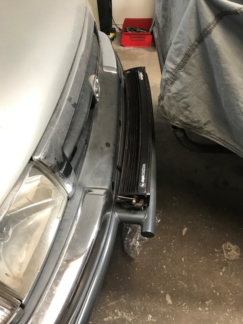

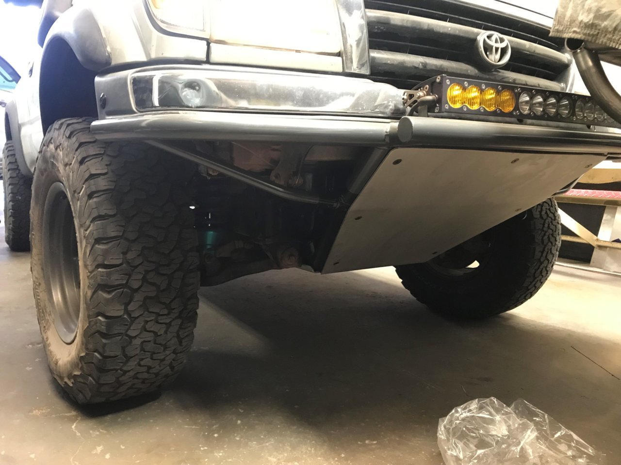

    Wrapped up the front bumper build, just need to wrap up the rear shock relocation kit from @ARCHIVE

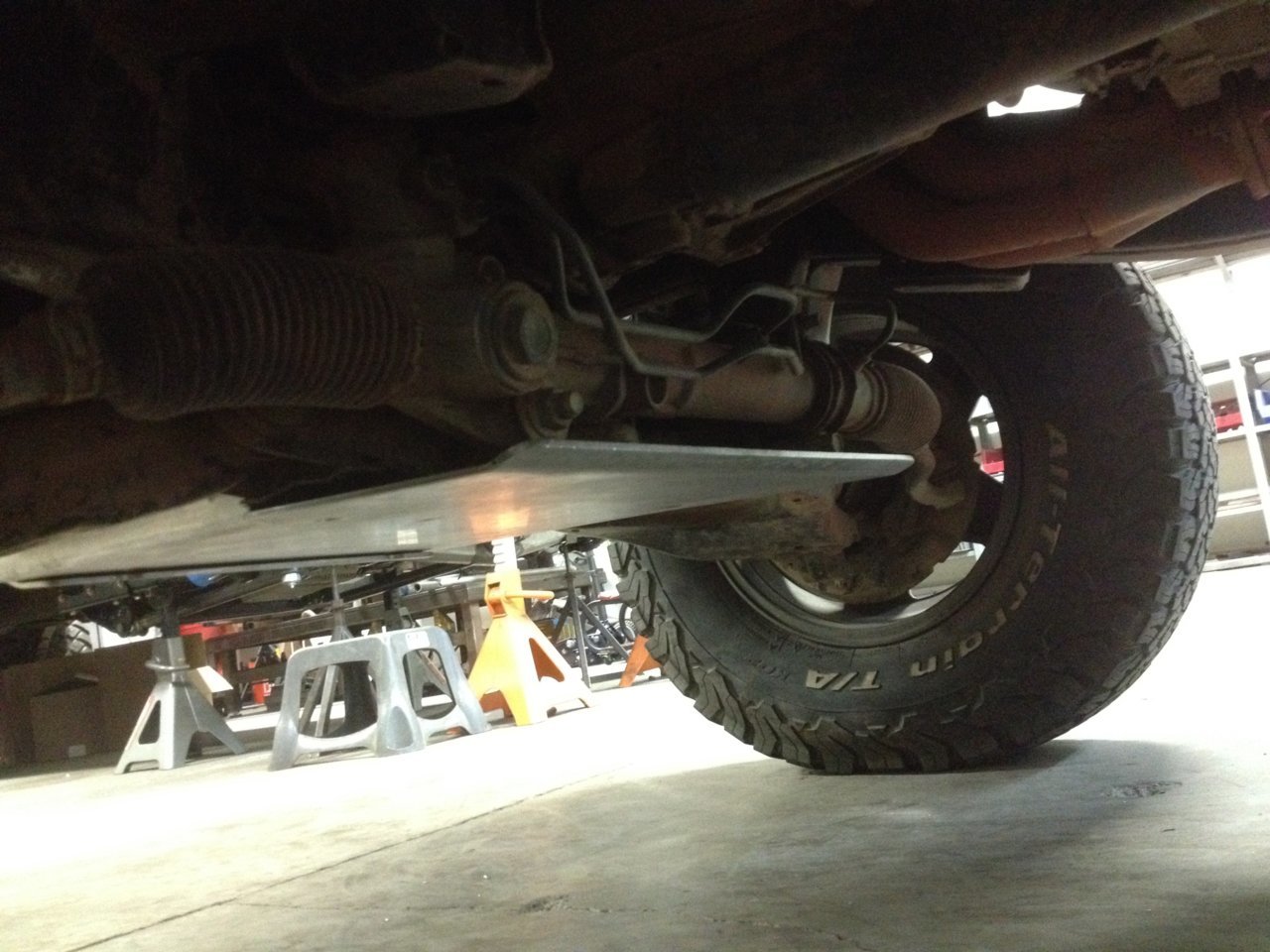

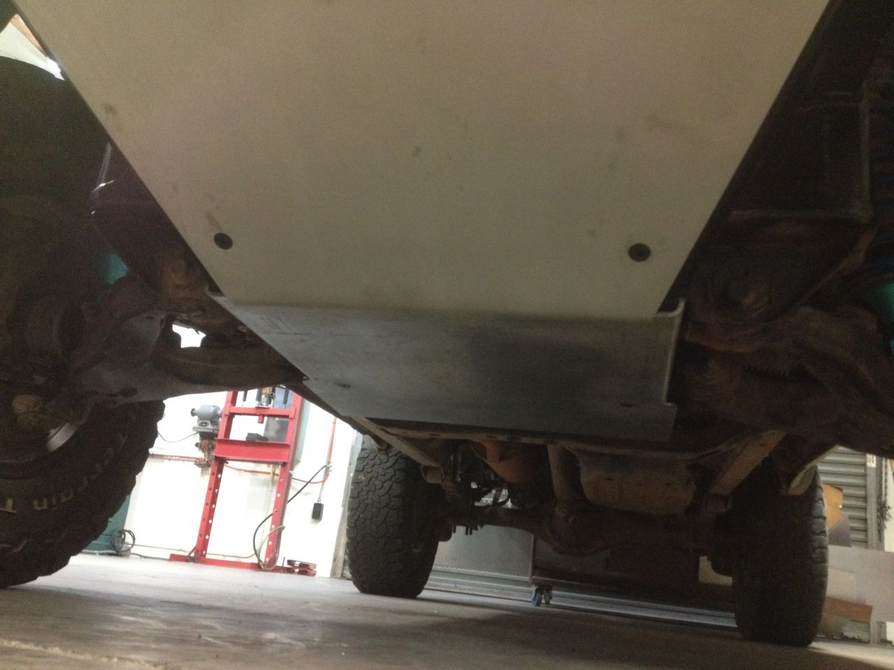

    How’s the rear of that skid plate mount? Doesn’t look like you’re using the steering rack mounts...

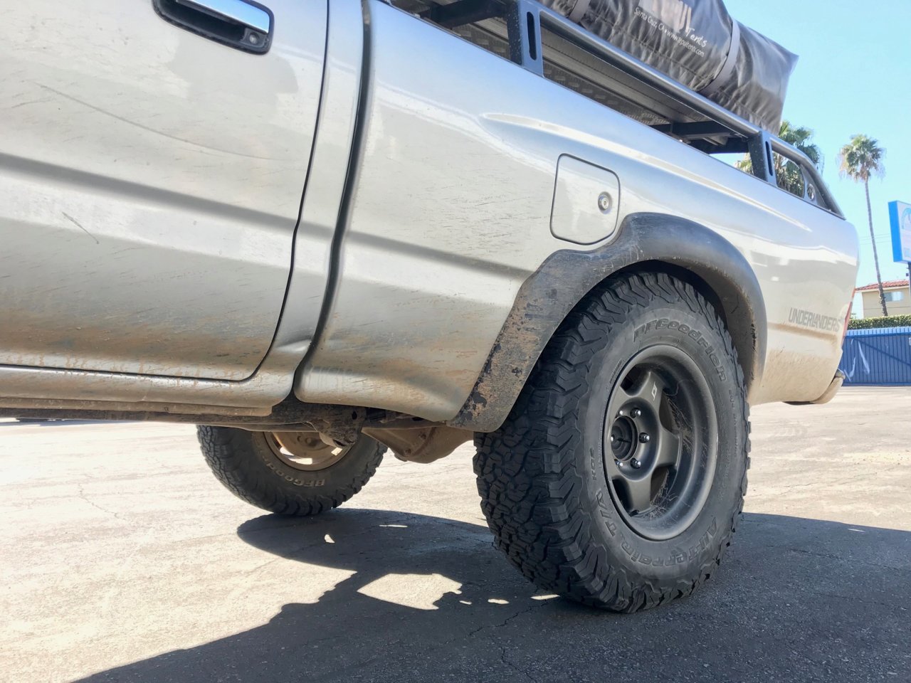

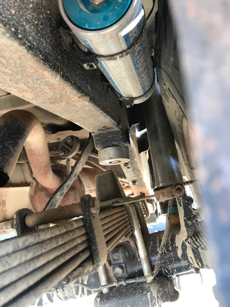

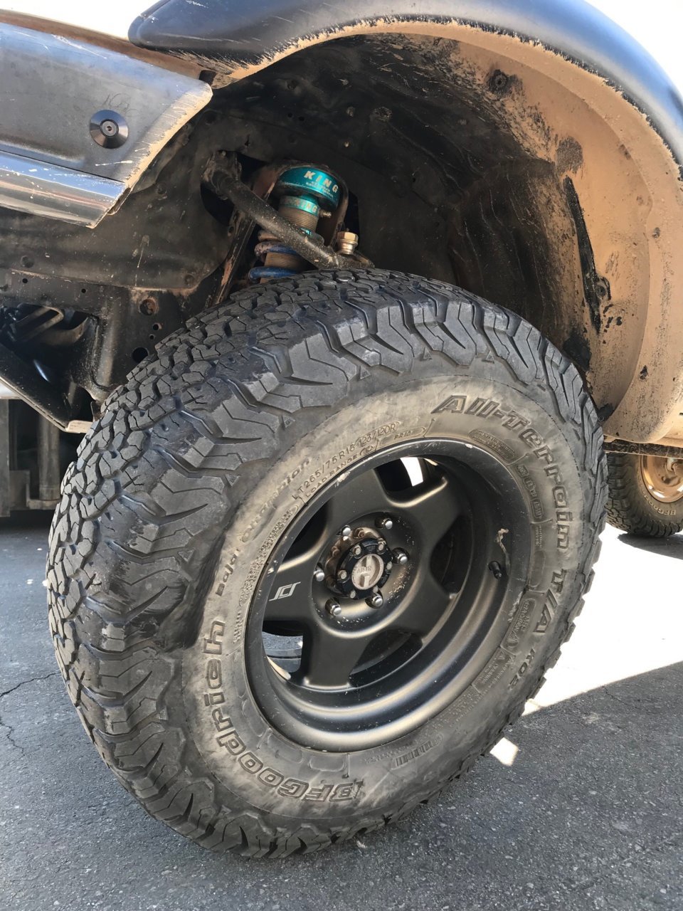

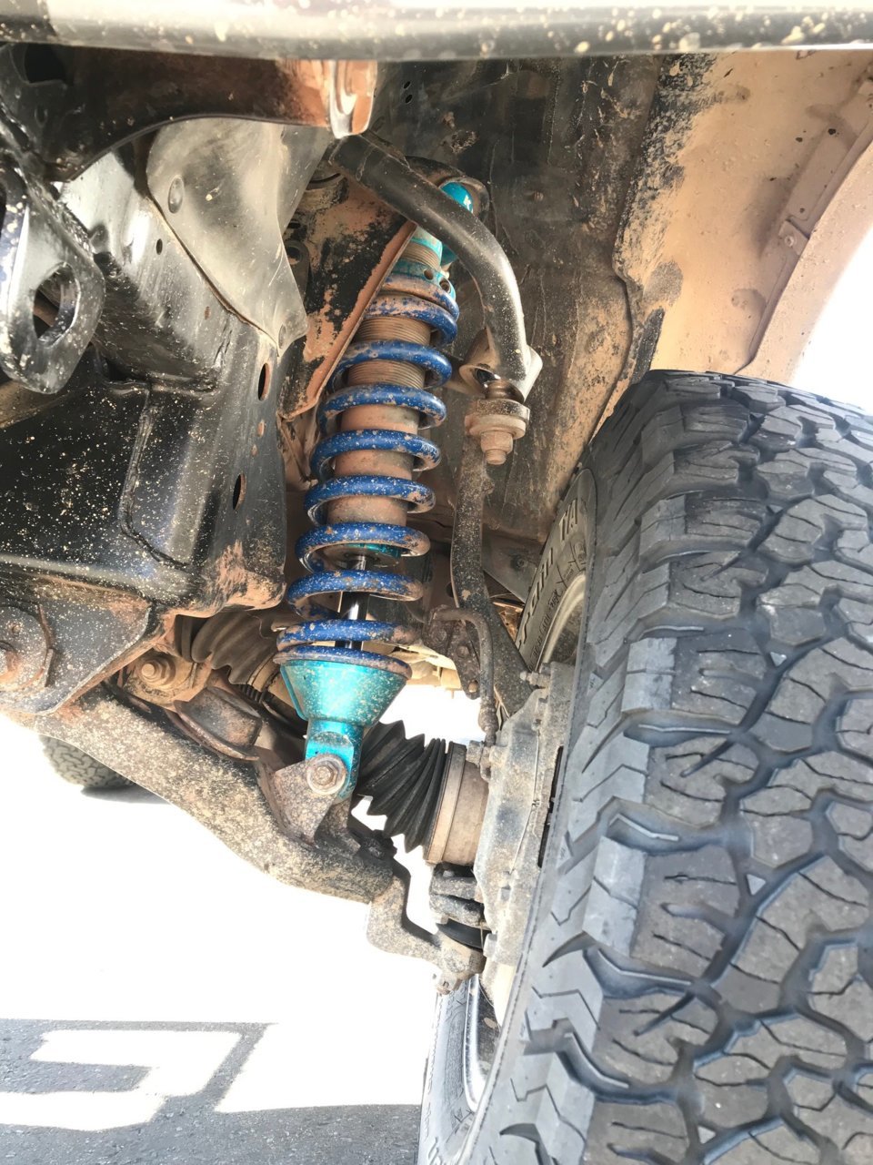

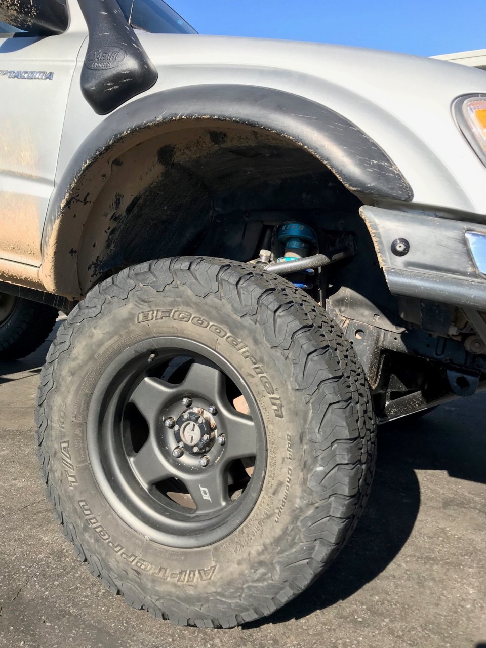

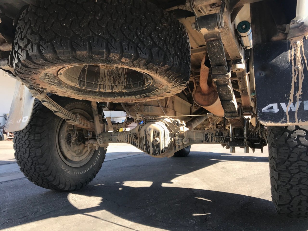

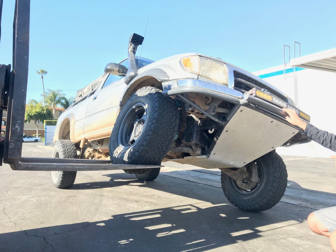

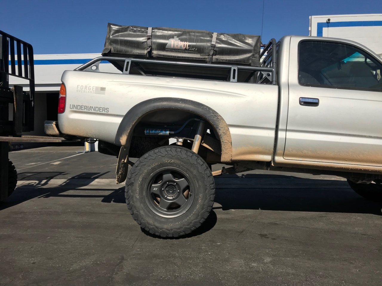

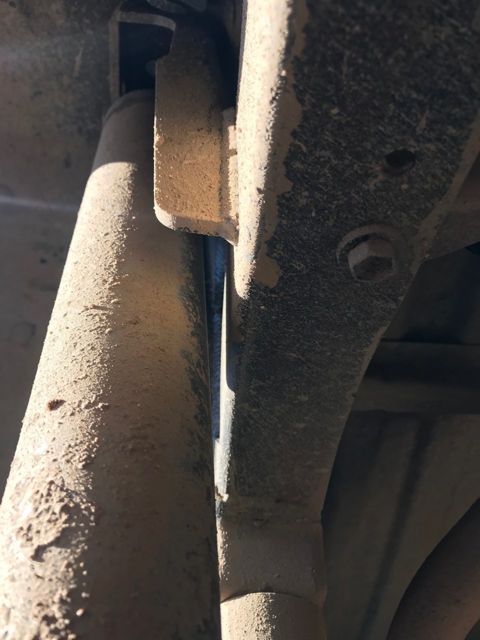

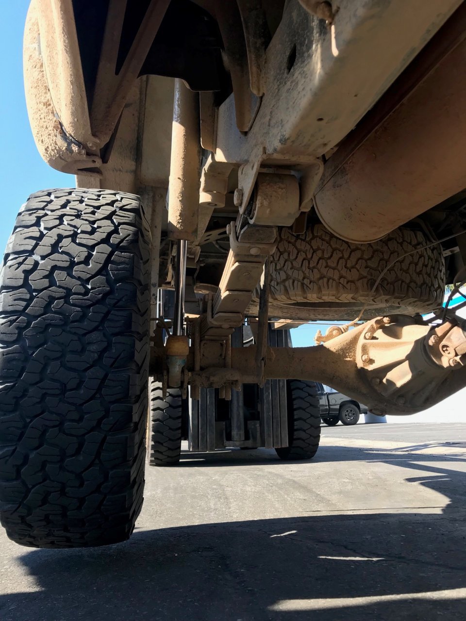

    The new @ARCHIVE 2.5" shock relocation kit for the first gen has been installed. I need to clean and take pictures when i get back from a 5 day trip starting tomorrow. Awesome kit, happy as hell with the new setup.
    Warning, photo dump: Also, my bumps and straps are not set up for articulation. They should be, and that is now on the list of things to work on. But they are perfect for straight droop/compression while moving fast.
    EXCELLENT frame clearance
    LOLOLOL

    So you are rubbing hard at full stuff then right? Going to run spacers?

    Bug deflector
    Yep, but only at full flex. I’m going to try some .5” spacers and see what difference it makes

    Bug deflector
    Sorry, i missed this. There are tabs welded to the lower cross-member and frame that the skid bolts to.

    Why did you scrap the Solo shock mount kit for the archive?
  12. Feb 20, 2019 at 10:12 AM
    #332
    Willbeck
    Willbeck [OP] Well-Known Member
    Feb 8, 2015
    #148190
    1,588
    Will
    Huntington Beach
    00 Reg Cab 4x4
    Bug deflector
    To gain clearance for hydro bumps outside the frame, and because it helped Eric with feedback.

    Does one have more shock/tire clearance over the other?
  14. Feb 21, 2019 at 11:30 AM
    #334
    Willbeck
    Feb 8, 2015
    #148190
    1,588
    Will
    Huntington Beach
    00 Reg Cab 4x4
    Bug deflector
    The Solo kit was designed with 2.0's in mind. The Archive kit was designed for 2.5's so the frame side clearance is much better. Tire clearance is about the same. The Solo kit is more of a builders kit, you need to know what you're doing to install it for sure. The Archive one also takes some knowledge to install, and welding skill, but is much easier to place on the frame etc.

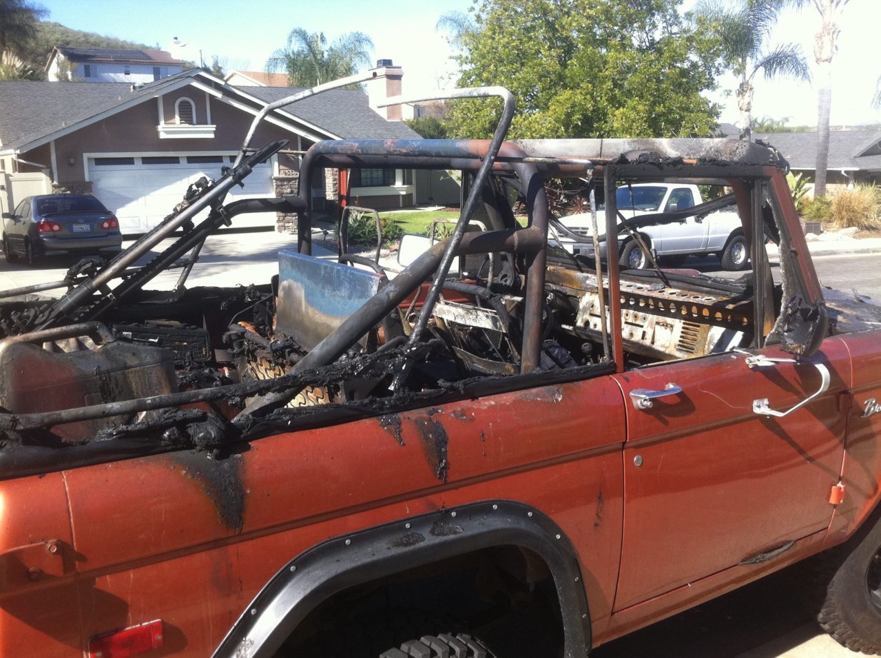

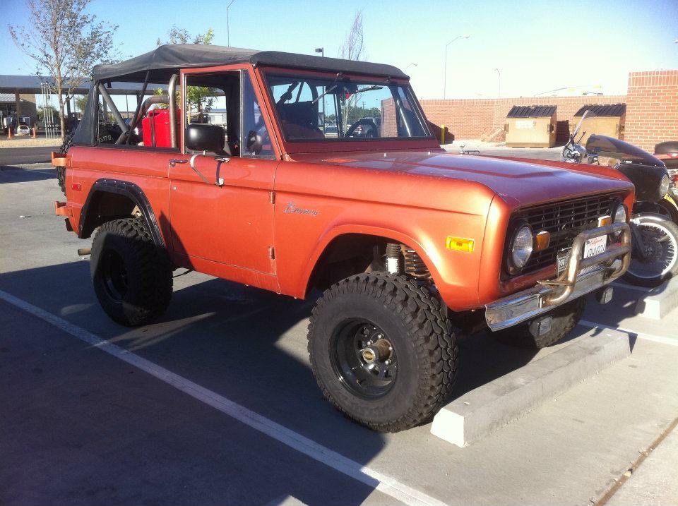

    I loved and miss my old Bronco, but sometimes a Taco is all you need. A336F580-B7C2-46BE-B1F4-F10CEB74C3BE.jpg 3464D70B-BC0A-42BB-B2C2-331B6FC61575.jpg

    Fire in the hole! What happened?

    Took off the carburetor and installed a fuel injected throttle body. One of the spark plug wires were damaged apparently and it arched on the engine and exploded..

    aw man that's a huge bummer. Those early Broncos are starting to get nuts in value.

    Yeah they are and at the time there was a law in California that said I couldn’t buy the salvaged truck back after my insurance paid me because it was a “smog” vehicle. Anyways this is my Girl now. I’m image.jpg
