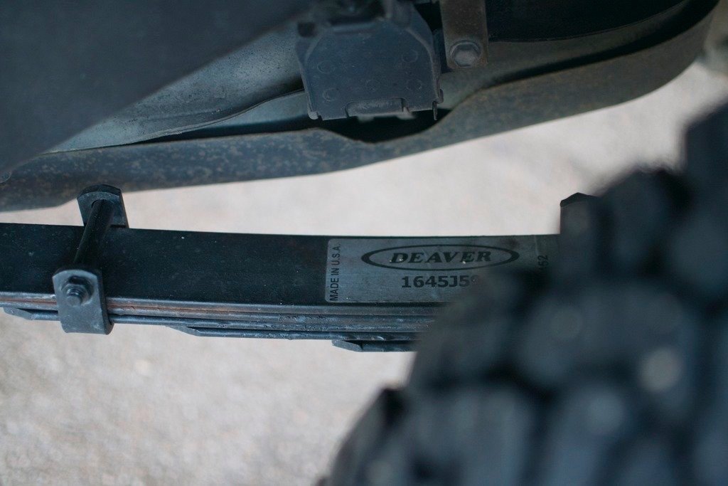

    I’m considering these springs for a daily driver.
    Any input on ride quality?
    How many leafs do you have?
    How much lift?
    I’m not looking for a lift tho

    J59s will give you some lift.
    I think it would be best to call Bill at alcan and ask him for the 4 pack springs he used to make for wheelers. Shouldnt have any lift.
    Otherwise my single cab has dorman springs on it. They ride fine and no lift. Though doubt they will last very long.

    EXCELLENT ride quality. 8 leaves, about 1.5" of lift. I am sure you can remove a leaf or two and dial in the ride height you want without much impact on the ride quality, if any. Recommend good shocks, Bilstein 5100 or better to maximize ride quality, even on road.
