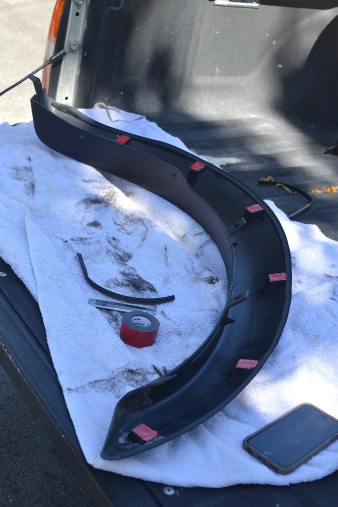

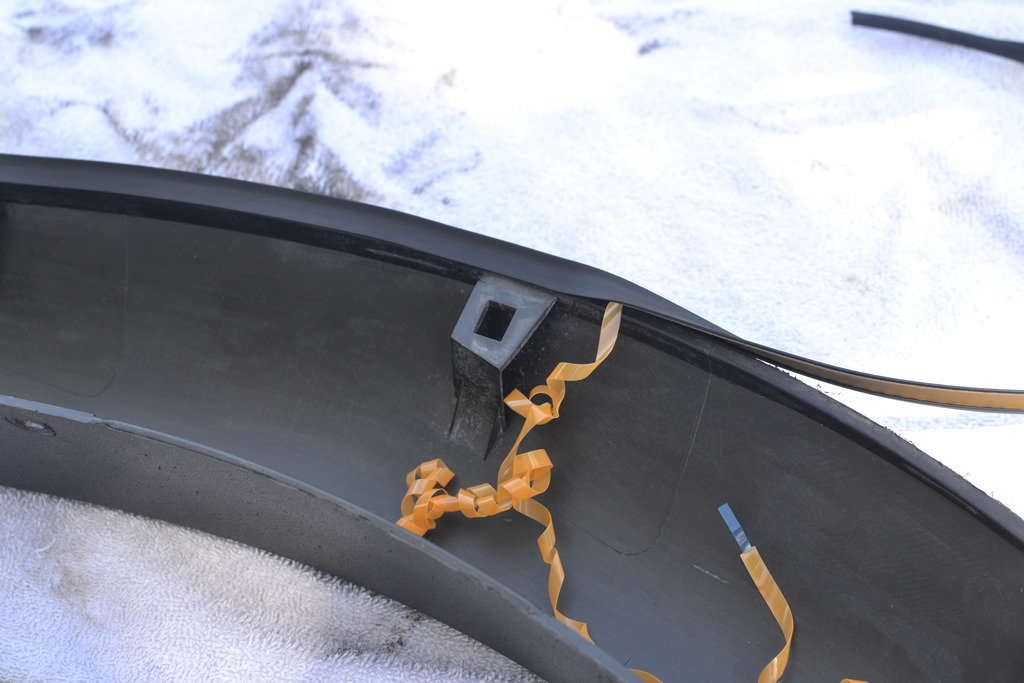

    Spent most of the weekend painting and installing a set of 01-04 fender flares i managed to snag from someone who's truck was totaled with front end damage.

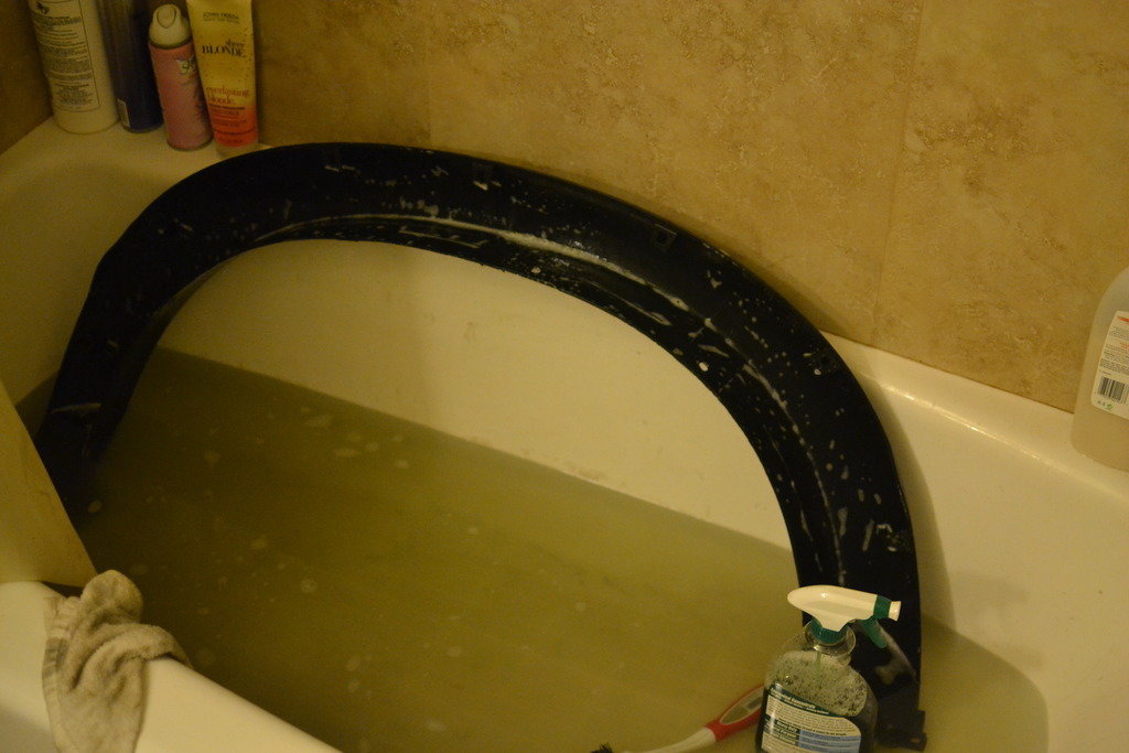

    My GF was super impressed by my genius idea to wash them in the tub. Once I got the flares clean, i grabbed some satin black paint, and spent an evening putting a few coats on one of the front flares, as they are smaller and wouldn't waste as much paint if i didn't like them. Ended up being a good call, because it was more gloss than not, and every flaw, nick, and scratch showed through brilliantly. Time for plan B.... Plastidip. Worked awesome. Even has some nice little texture to it. Will be relatively easy to touch up from trail scuffs.

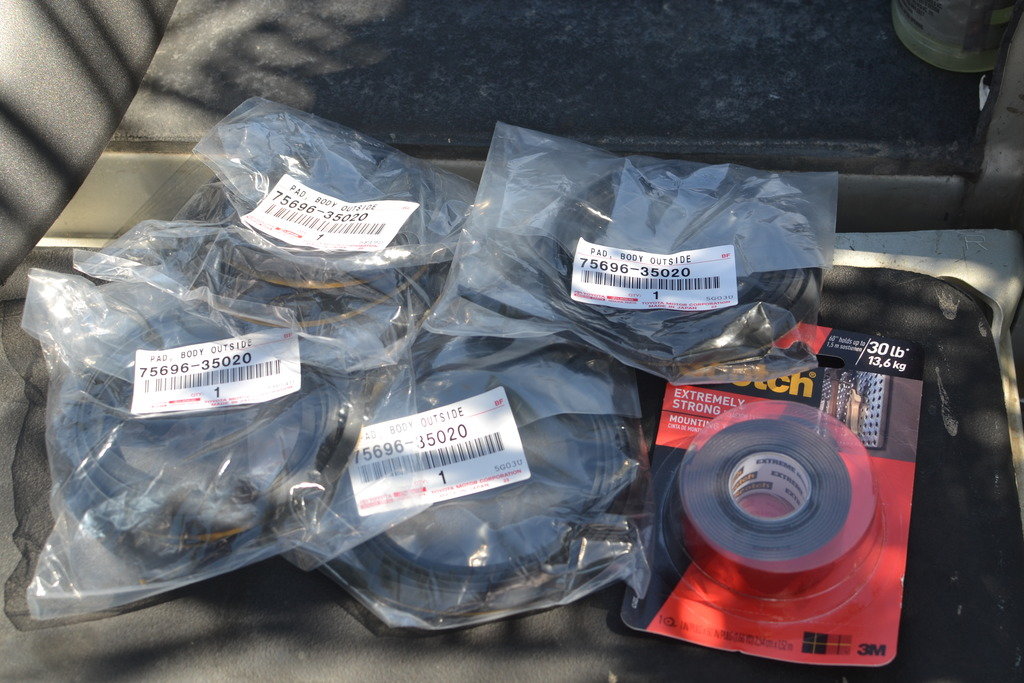

    Also, i ordered new flare pads online. Took some searching, and digging around, but i was able to find part # 75696-35020. I thought this was for the rear fenders, and would be longer than needed for all of them, so i ordered four. More on this mishap later.... Also, since i don't have the pre-punched holes in my fenders, but still wanted a little more piece of mind, i grabbed some "EXTREMELY STRONG" Scotch double sided tape. We will see how that claim holds up over time.

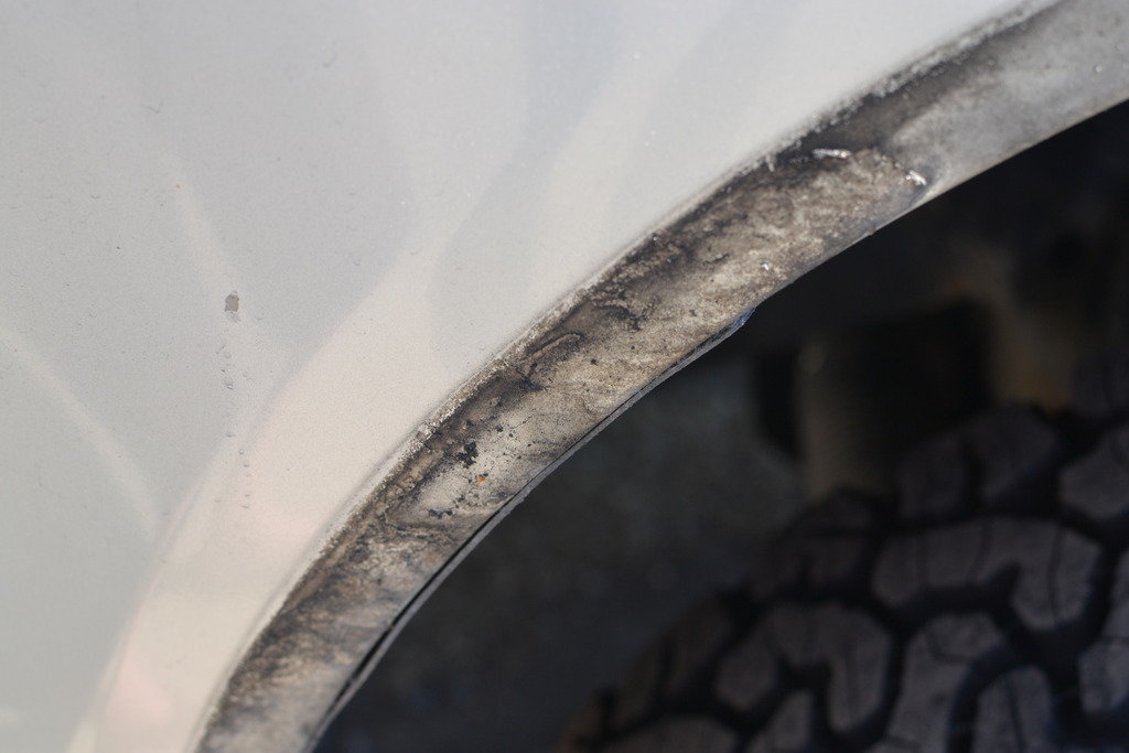

    Before i could install the new flares, i had to take off my dinky OE DLX chrome baby flares. More like cholo fender trim than anything else, but a 10mm wrench and some time, and they were off. Not surprisingly, the fender behind it was filthy with 15 years of dirt and dust. These wonderful flares are up for sale if anyone wants them. I'll hold onto them for a while, but they'll eventually go in the trash.

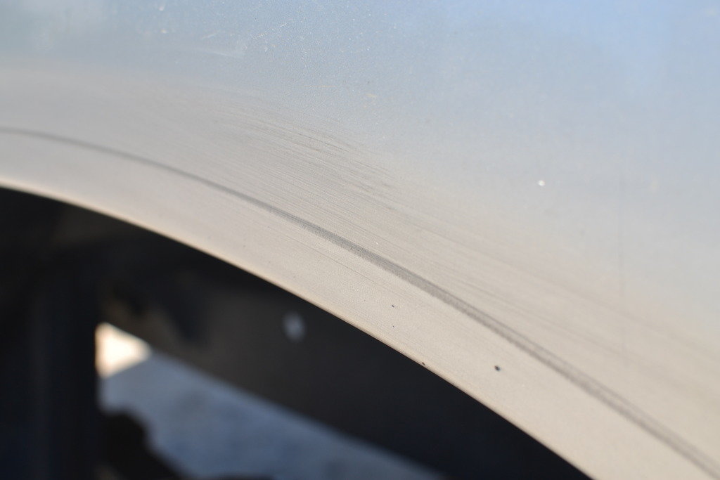

    Took a little simple green, water, and quick detailer to clean up the paint. The old trim doesn't have any pads, so there's a wonderful scar in the clear coat on all four corners now. Not a big deal, its not through the paint so it won't rust, and will be more than hidden by the new flares.

    Now to put on the new to me flares...
    The "Pad, Body Outside" as Toyota calls it, comes with a thin strip of self adhesive foam on the back side. I decided to put the pad on before i installed the flares, but i have a feeling at the factory they put the flare on first, slide the pad in, then remove the adhesive backing. Doing it my way was tedious, and it wanted to keep rolling under even though i peeled and stuck as i went. I can't imagine anyone in a factory getting paid to take as long to install them as i did, so there has to be a better way.
    I did the front two flares first, and there was about 4" of extra pad. Trimmed it off, no big deal. However, the front flares are substantially smaller than the rears. Doubtfully less than the 4" of leftover i had. This is where i realized that there must be a different part # for the rear. After installing the pad on the rear flares, i had about 3" of flare left without pad. Luckily i saved the 4" cutoffs from the front, and was able to bridge the gap. I would recommend finding the rear part # and ordering two front, two rear, or just four rear ones. Doesn't really make a difference in the long run i imagine, but i kind of wish the pad were one continuous piece.
    At first i tried installing the flares without the Scotch double sided tape, but the holes don't all line up perfectly (within an 8th of an inch, but not perfect) so the flares didn't really want to sit exactly right in the front. Pulled them back off, slapped on the sticky tape, and now they're fine.

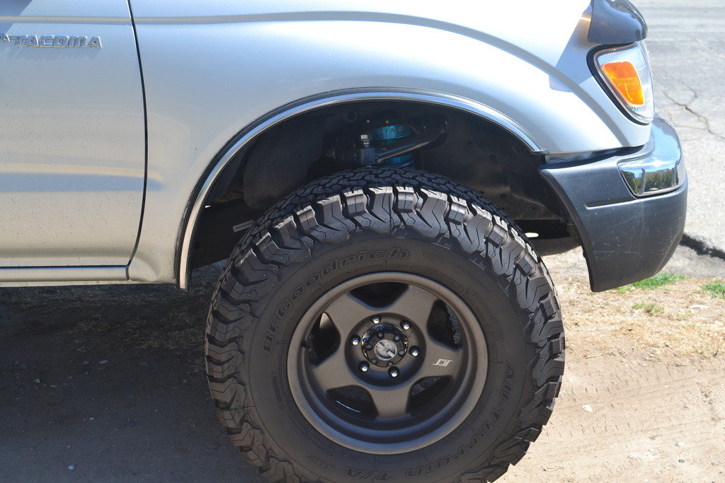

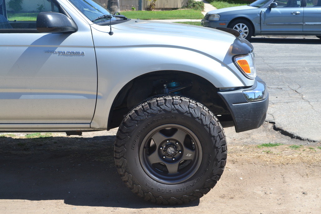

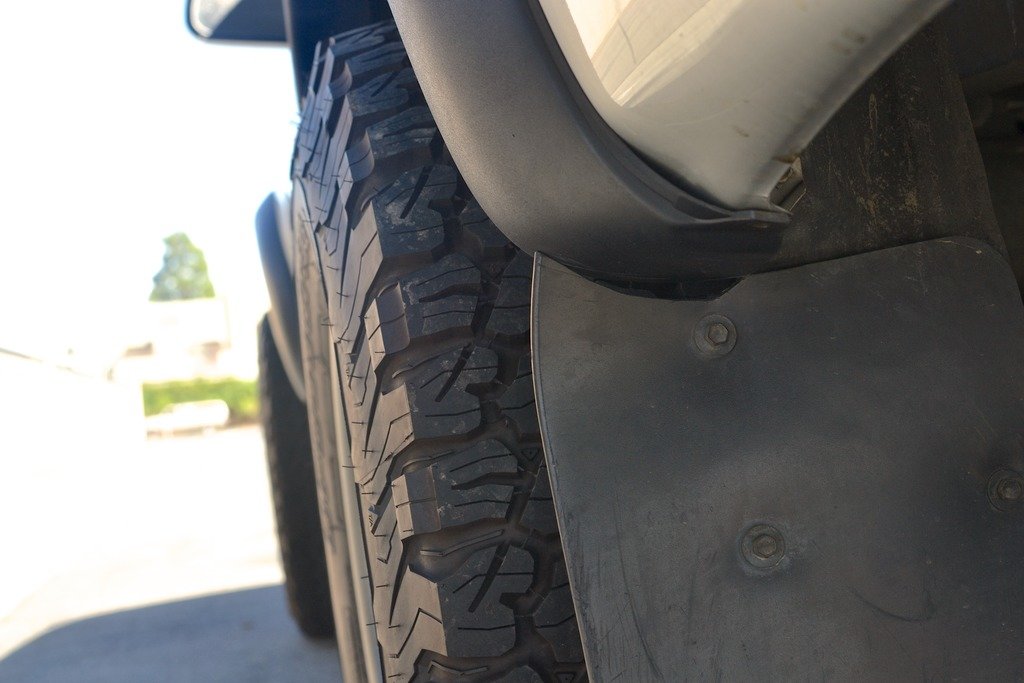

    The coverage on my tires is now much better. Not to mention the truck looks a little more modern, and more aggressive. Had to trim my mudflap a little in the rear to clear the flares as well. I wonder if the 01-04's have different flaps or brackets?
    Before
    After
    97xtracab, ARCHIVE, Dalandser and 6 others like this.

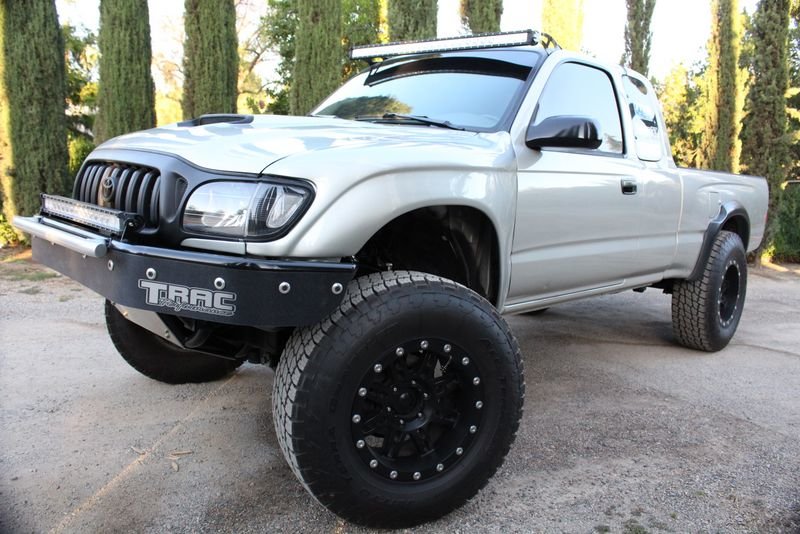

    Goal is a kinda trophy truck style bar and valence. Thinking of using an 01-04 upper fascia. Hard to explain. Rear bumper will be the Demello Offroad tube bumper.

    Oh I gotcha kinda. I'll be curious to see how that turns out

    Kind of a bumper like this...
