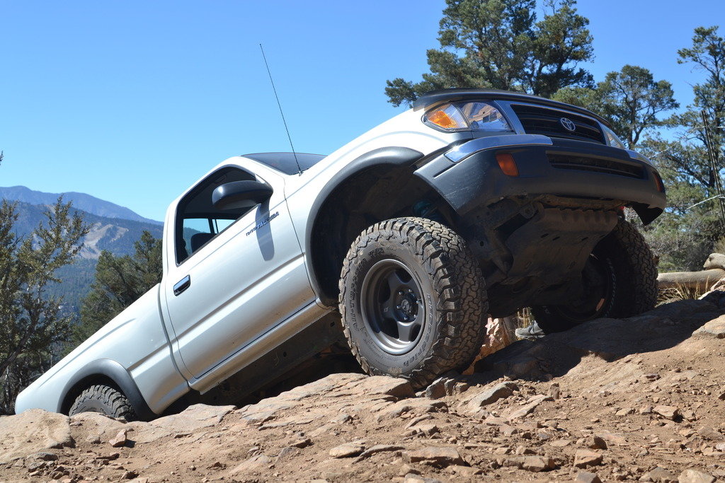

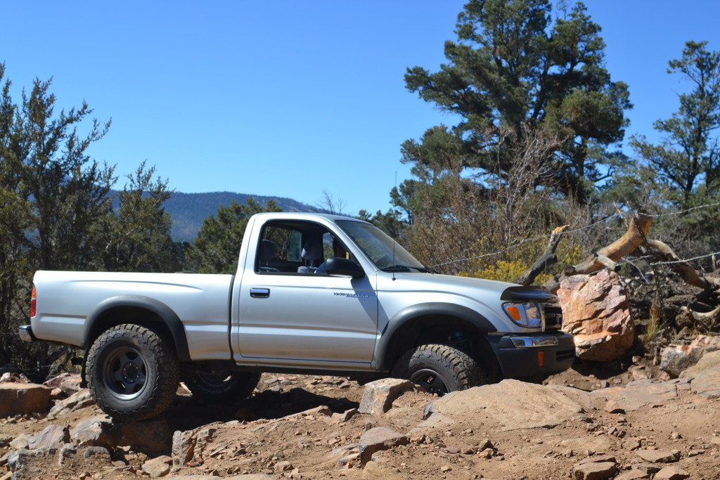

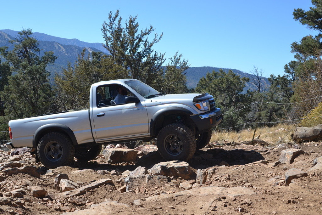

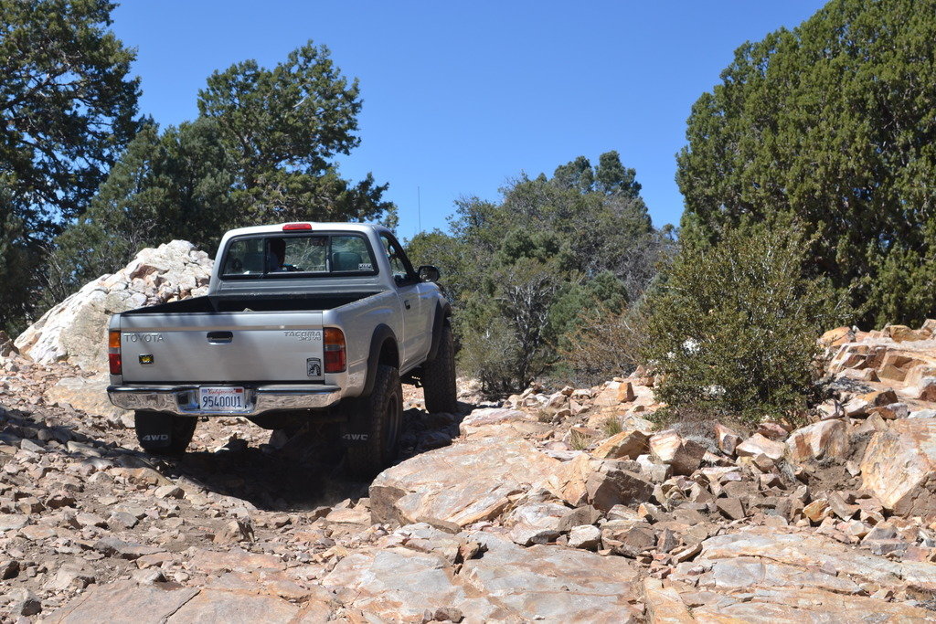

    Spent the past weekend in Big Bear with some wheeling friends. Did Gold Mountain Trail, and Heartbreak Ridge / Pontiac Sluice. The Tacoma did an awesome job. Great wheelbase, and plenty of power, grip, and ground clearance. I'll post some pictures;

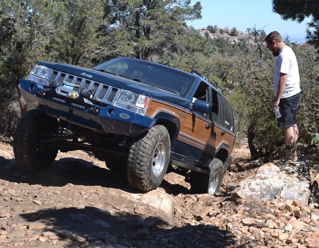

    Of course the jeep broke down ;)

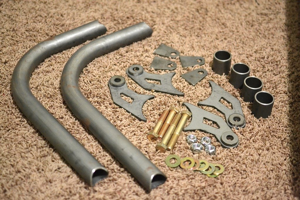

    Shock hoop kit as it comes from Solo...

    Aren't those shock hoops from solo for 2.0 shocks not 2.5?
  18. Oct 20, 2015 at 9:56 PM
    #98
    Willbeck
    Willbeck [OP] Well-Known Member
    Feb 8, 2015
    #148190
    1,588
    Will
    Huntington Beach
    00 Reg Cab 4x4
    Bug deflector
    Spent a long time going back and forth with Solo over this. The hoop doesn't care what size the shocks are, it's the space between the tire and frame that matters.
    With my extra inch of backspacing, but wider wheel/tire, I should have an extra half inch of clearance. With the shock bodies being only 1/4" wider on each side, I figure I'm within about 1/4" of similar clearance to a 2.0 on stock width wheels/tires. Ballpark guesstimate.
    That being said, Solo thinks I will get some light tire rub in the shock bodies at full stuff/flex, but nothing serious. Truck isn't designed to be a dedicated crawler, so full flex is not likely to happen often.
