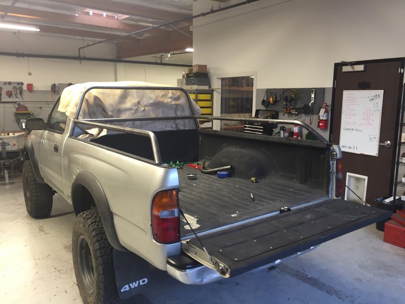

    Doing bed rack things with my friends.

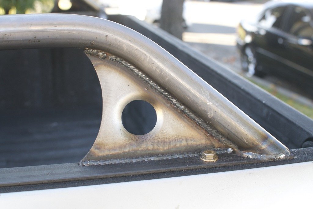

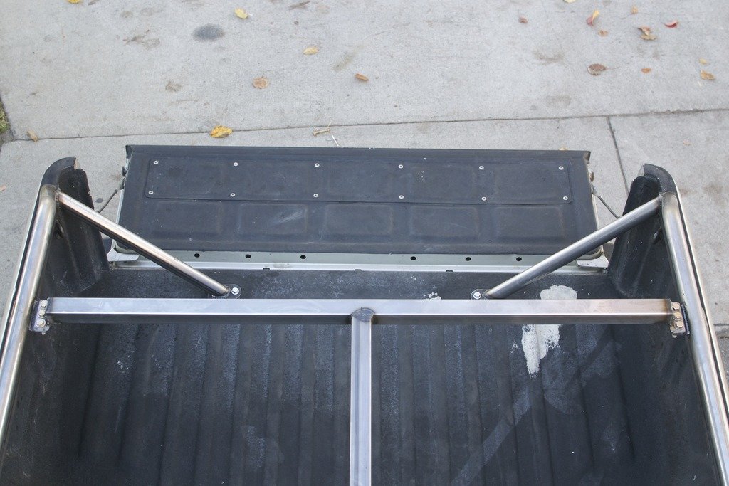

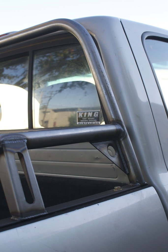

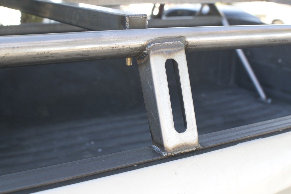

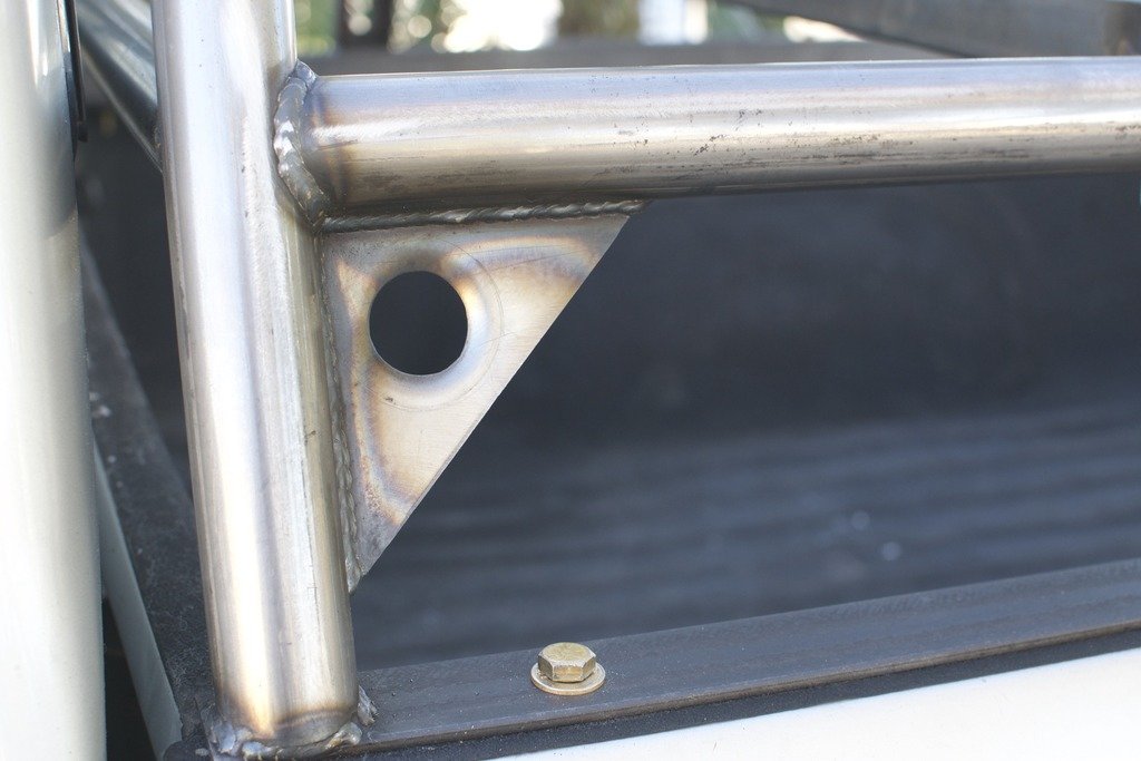

    Will
    Huntington Beach
    00 Reg Cab 4x4
    Bug deflector

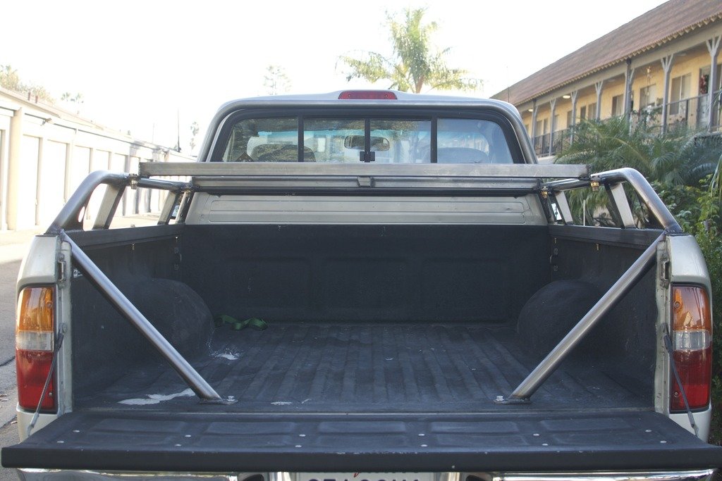

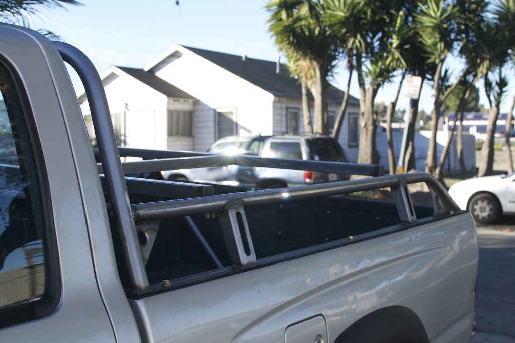

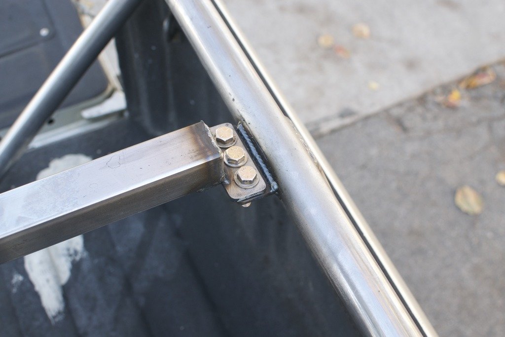

    Picked up my truck from Creative Fabworks in Anaheim last night. They always surprise me by taking care of all the small stuff. Threw in the bed re-inforcements without even asking. Offered them extra $$ since it wasn't part of our original negotiation, but they said no. Super stoked on how it came out, and it makes me really happy to be able to support friends.
    The amount of hardware used to anchor the cross rails shocked me, but i am not complaining. This thing is rock solid, and will probably outlive the truck. It's not painted because i haven't decided on light tabs and antenna mounts yet.
