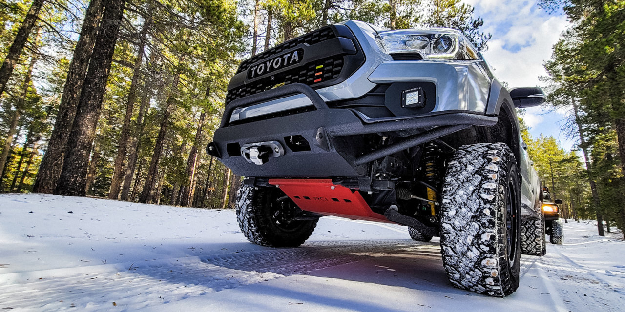

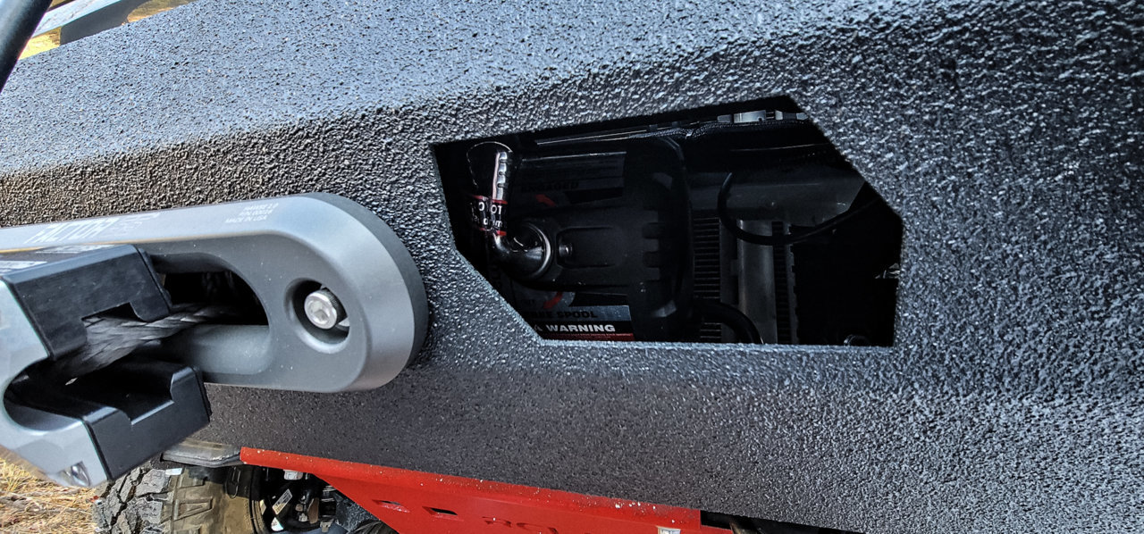

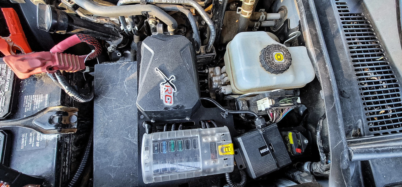

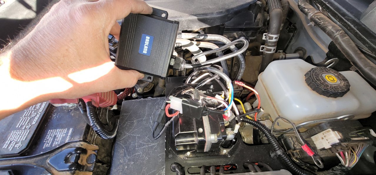

    So this was a concern of mine when I purchased my sso bumper. I ended up clocking my winch to rotate the clutch lever forward to access it from the bumper opening. And me being shorter 5'7" access the stuff via grill was going to be a pain. So I ended up relocating the control box to a Rago bracket. Then I also wired in the badlands wireless winch controller as it seems to be a little better quality then some others.
