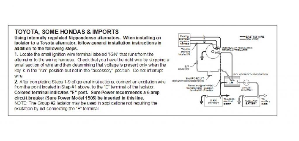

    What??
    Post up a diagram on how your setup is wired. Your making it sound like its in parallel not isolated..

    So your isolator is automatic that switchs back and forth between the batteries.
    With that setup basically like having two starter batteries. So that way works. But I think most newer systems don't do it that way. They have the alternator + go to starter battery then a + cable to an isolator that goes to second battery. So when the isolator is on it links the batteries and charges both or you can use them when winching. But then turn off the isolator and you can still use your fridge lights or whatever that is on the secondary battery so it'll drain but the starter won't.

    yep, dependent upon demand.
    except the Aux batt. is removed from the vehicle's e-system.
    And I'm not using starter type batteries.
    I'm old... so that's my excuse. (old dogs suck at new tricks) :p
    I'll leave that newer digital age stuff for you youngsters.
    Tho' I do wish I could afford a diode type isolator.
    That would bring the efficiency up a notch.
