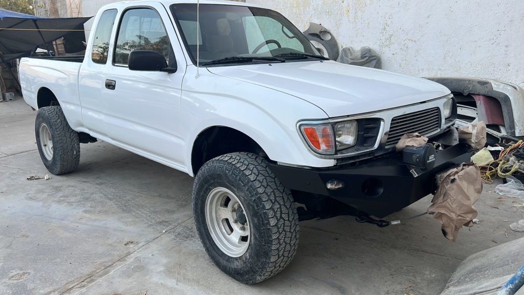

    Guys, I want a good front bumper to mount a winch. Anyone got a set-up I could get a few ideas from. My main goal is a clean factory look. Below is my build. Thanks in advance

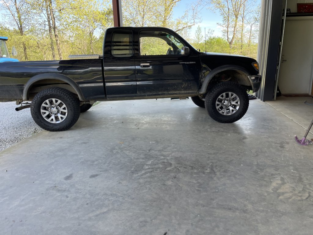

    You have few options, something prefab = $$$$$, plate(s) bumper but some people dont like the angles plus the weight. Tube bumpers are easier to make but are dated. In the photo is a Flatland bumper kit on my 96.
    billychadbones and Wulf like this.

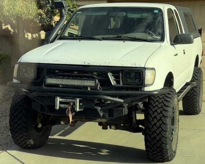

    I dont know of any off the shelf winch bumpers that will retain any sort of factory look. Theres just not a lot of space to hide a winch, especially on a 95-97. Plate options such as the one above are probably the cleanest.
    I am partial to the Trail gear rock defense low profile tube bumpers myself though
