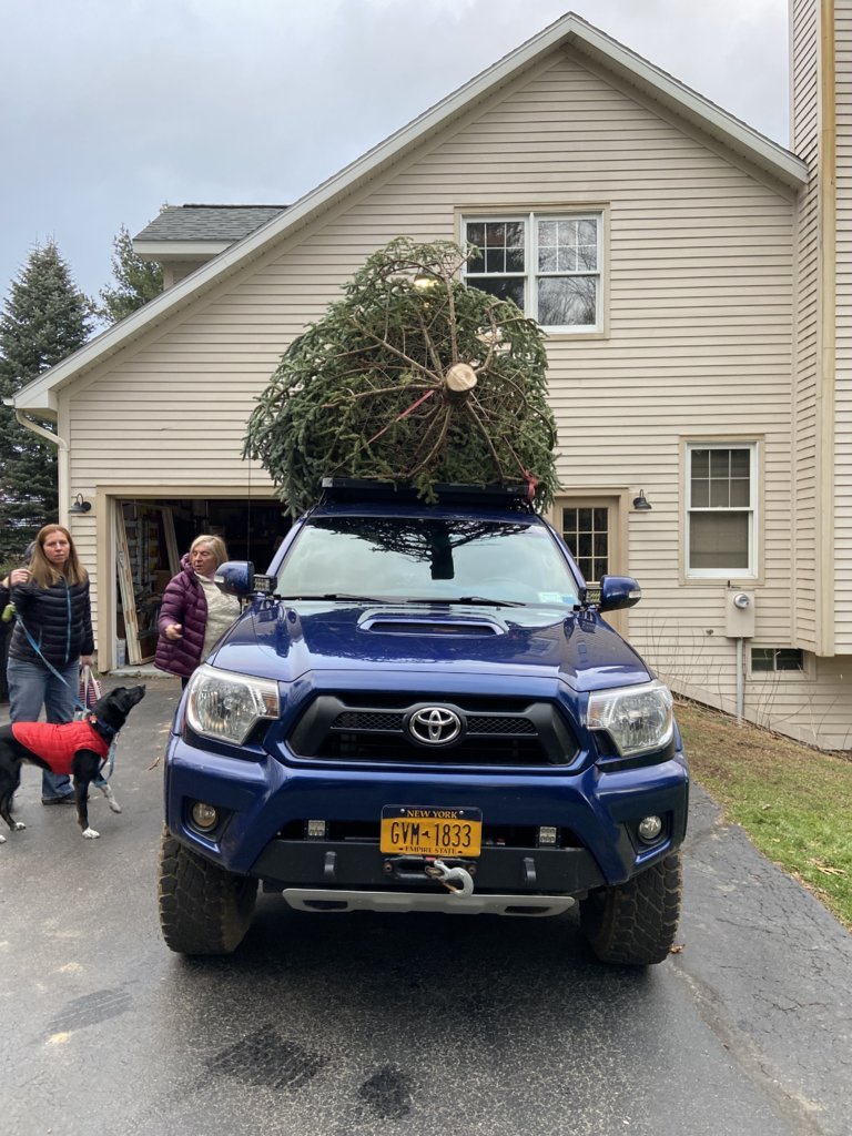

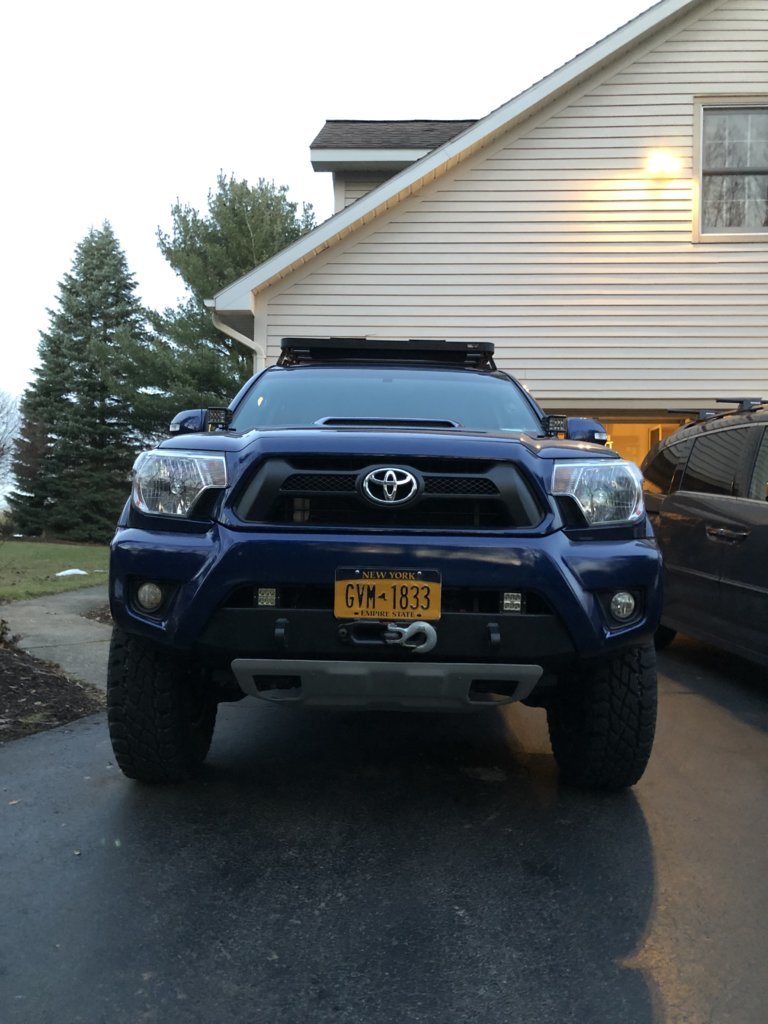

    Love the US Off-road set up… easy to install, looks clean, adds some skid and front end protection. I ended up putting my OEM skid plate back on but not necessary. Paired with a warn synthetic 8500# (not the evo, don’t recall the exact model) and it fits and operates perfectly.
