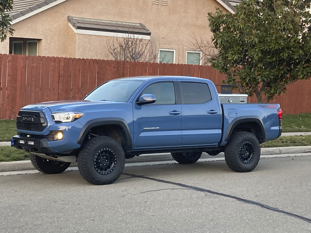

    Yes. I did a recovery in the snow using a tug'em strap. Wasn't stuck bad, but the Toyota frame is thin compared to the 4x4's of yesteryear. The way the Victory bumper bolts to the frame's "ears" (similar to a lot of other bumpers), the frame's ears just bent and the bumper pull about 1/2" off one side of the frame. I removed the bumper, bent the ears back into place, reinstalled the bumper and installed the C4 Fab front bumper supports. They fit perfectly with very minor modifications. The bumper reinforcements tie the bumper back further into the frame and have through bolts that run through the frame. If my front bumper moves now, it's going to rip my truck in half....
