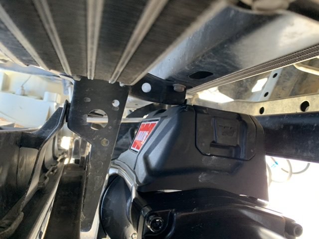

    Install/removal with an ARB will just require dropping the front skid plate. Like others have said, it is a minor pain in the ass but it can be done without removing the bumper.
    Tight squeeze fitting a VR10 in recently...
