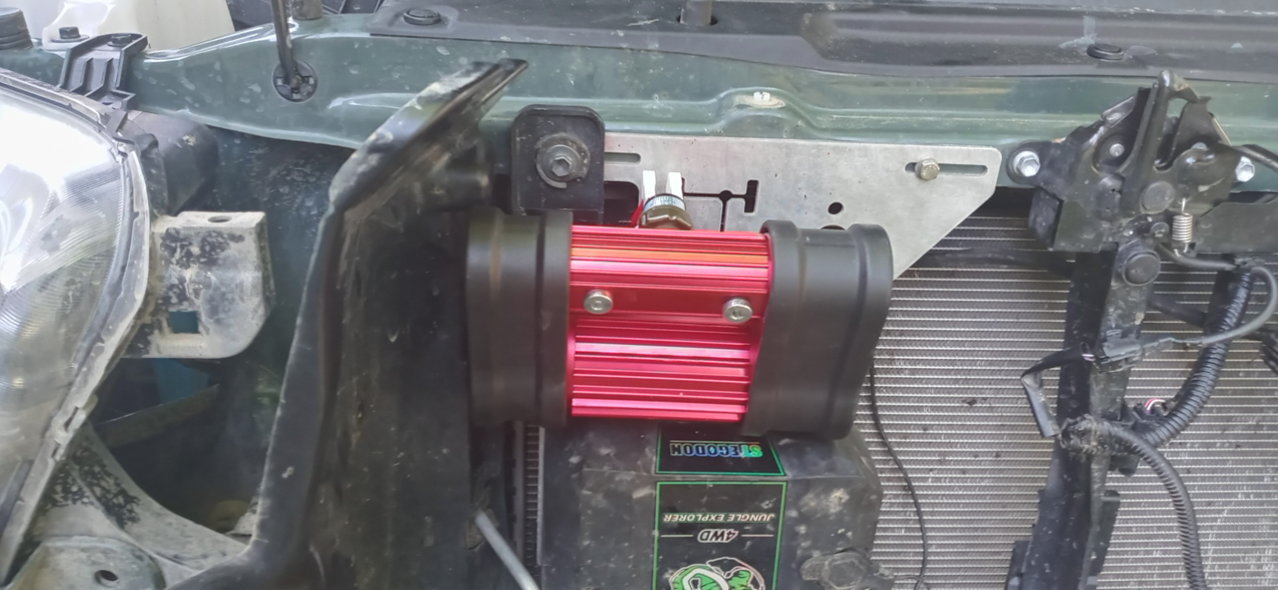

    Scrap steel (salvaged from the ends of the aluminum crash bar you remove to install the bumper) :

    Nice and clean. Thanks!

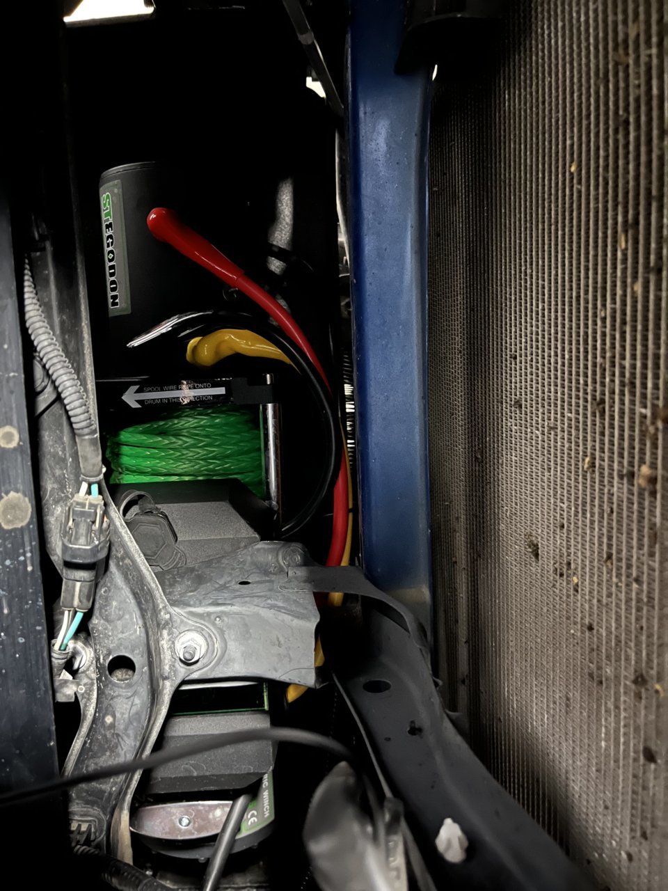

    double check if it really doesn't fit. i tried a few options for mounting points when i mounted a 10000pnd winch due to everyone on the forum convincing me it wouldn't fit without cutting or relocation. but got a wild hair to just see and it fit with at least 1/2 inch to spare.

    I had to bend that metal brace above the winch but mine just did fit in there above the winch.

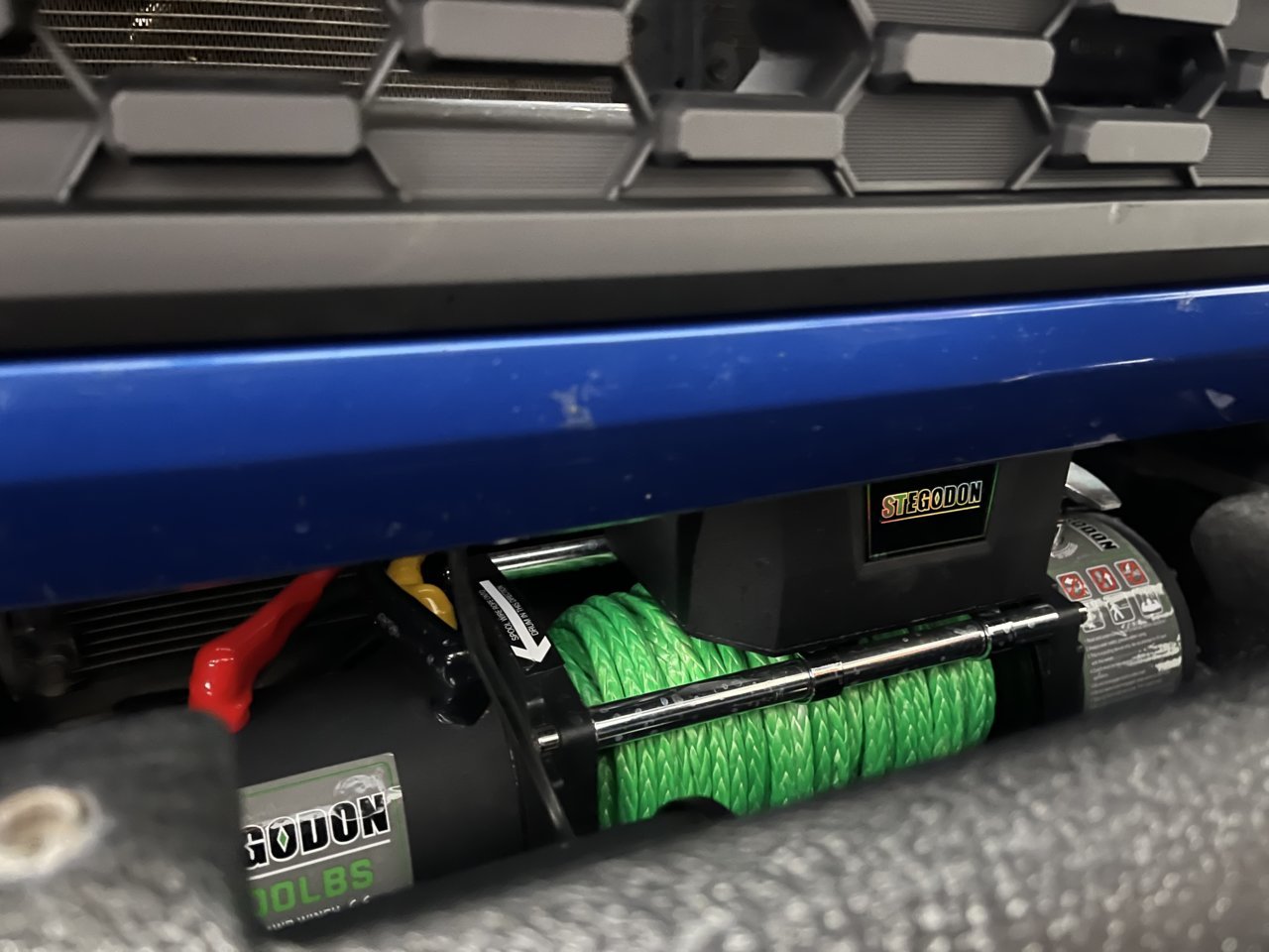

    Work in progress...
    It's hard to get a photo of the winch.
