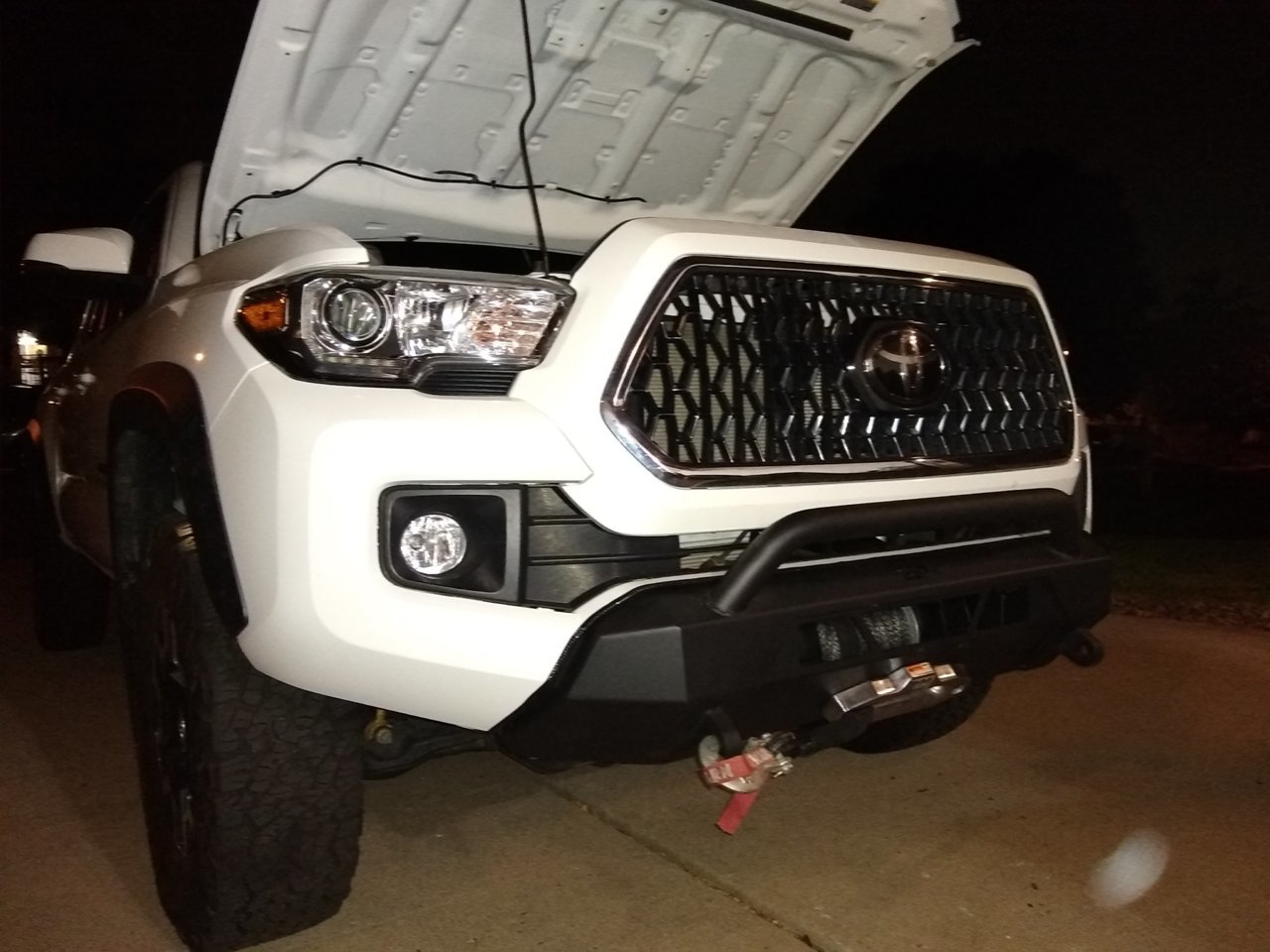

    Hey all, I just installed the Body Armor 4x4 Hi-Line winch bumper over the weekend.
    One thing I didn't think about ahead of time was how to control the winch when I need it.
    I'm looking for pictures and details around how people are either relocating the control pack or otherwise accessing the controller plug behind a winch bumper/grill.
    For context, I have a Warn Zeon 10-S. I will be removing the grill soon when I receive my light bar for the bumper, when that happens I am hoping to wrap all of this up and be ready for whatever.
    Thanks!

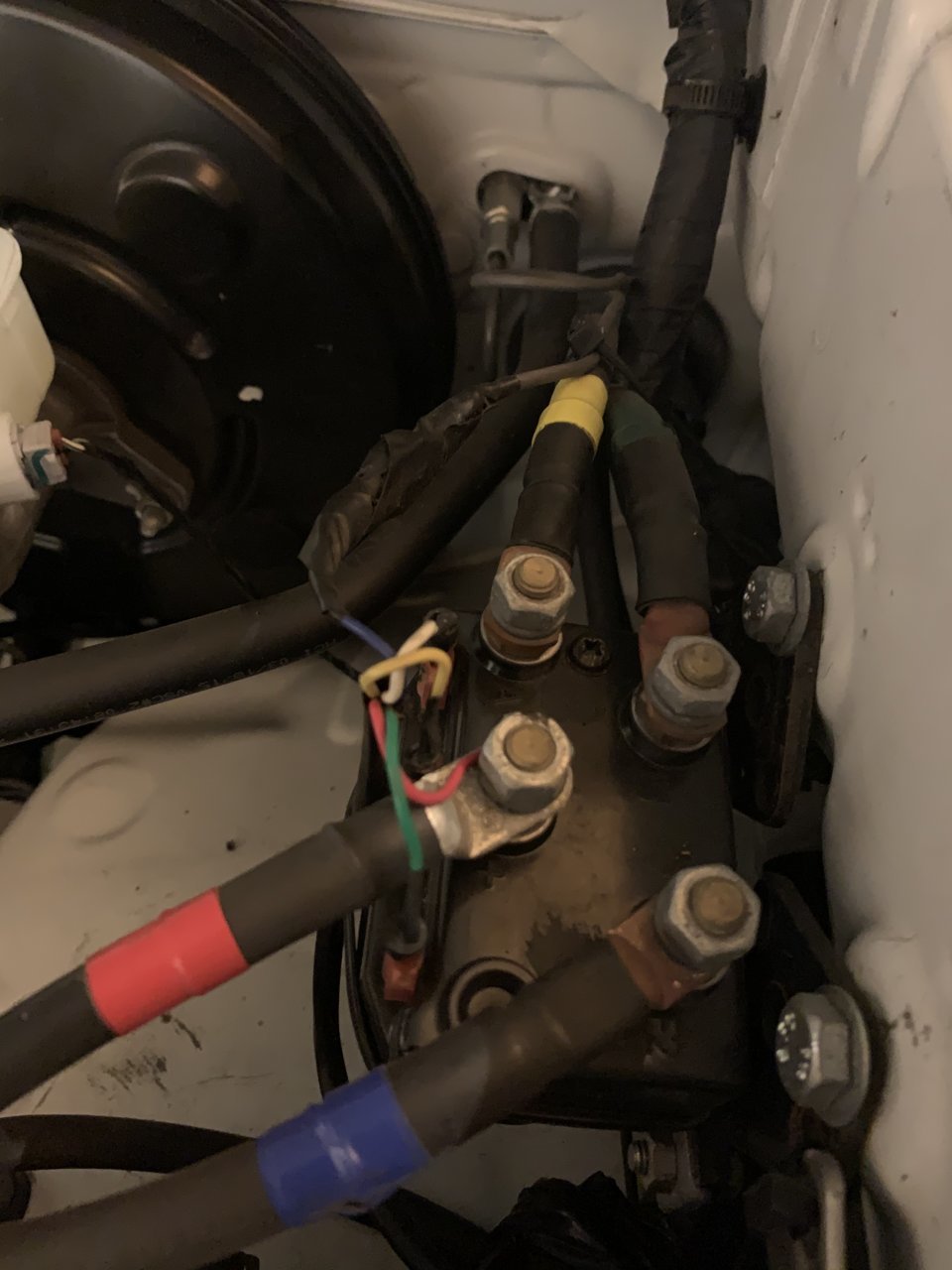

    I took the solenoid out of the giant box and bolted it to the fender up by the master cylinder in some factory threads there with a DIY bracket from a chunk of angle. I ran a piece of lawn sprinkler wire through the firewall for the controller socket. The solenoid is sealed (Warn). Painted liquid electrical tape on the controller wire connections.
