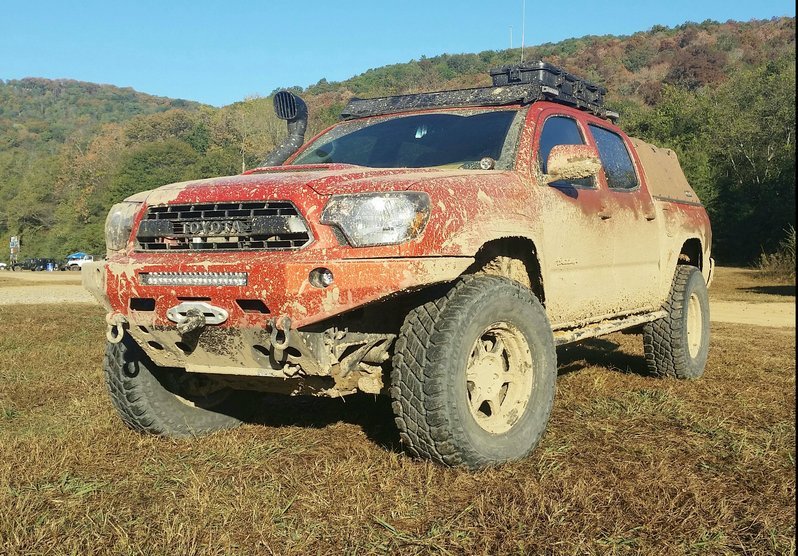

    Yours looks like a hidden winch. That's what I would like to get. Is yours the aluminum bumper replacement mount?

    It's a Pelfreybilt aluminum bumper.
