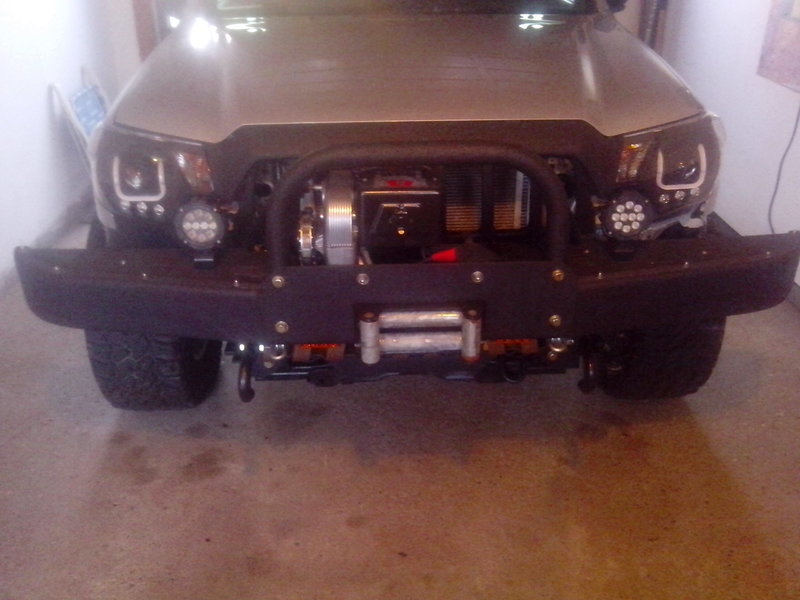

  17. Dec 29, 2016 at 8:59 AM
    #37
    MooseknuckleV22
    MooseknuckleV22 Well-Known Member
    Nov 12, 2016
    #202228
    230
    Charlie
    Clovis, NM
    2017 TRDOR DCLB - Quicksand
    Icon Stage 2, 275/70/17 KO2s, SSO slimline bumper, Warn Zeon 10-S winch, Rigid SR-20 light bar, TRD SEMA rims, Mobtown Offroad sliders, RCI skids, LED light conversion
    I like this idea...where did you mount the switch?
  18. Dec 30, 2016 at 5:46 AM
    #38
    rnish
    rnish Well-Known Member
    May 9, 2014
    #129450
    8,594
    Peoples Republic of Maryland (USA)
    Tacoma 2nd gen
    King's, Camburg UCA, Dirt King LCA, armor
    Mounted plate in front of brake MC. Made the plate out of 1/8 inch alum plate. Sprayed with bed liner. Note the Blue Seas switch is the 3002 model so I can select off, winch, aux (lights), winch & aux.
