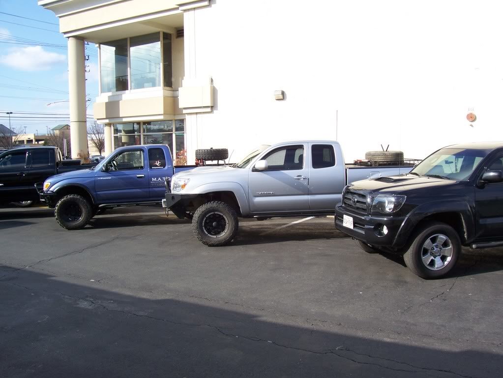

    I have the roller on mine it stick out a little bit but it works.
    Kind of see it here

    Thanks for the pic. I think I can just buy the one with the roller fairlead, then buy a hawse fairlead separately and it'll still be about $200 cheaper than the winch with the hawse...
