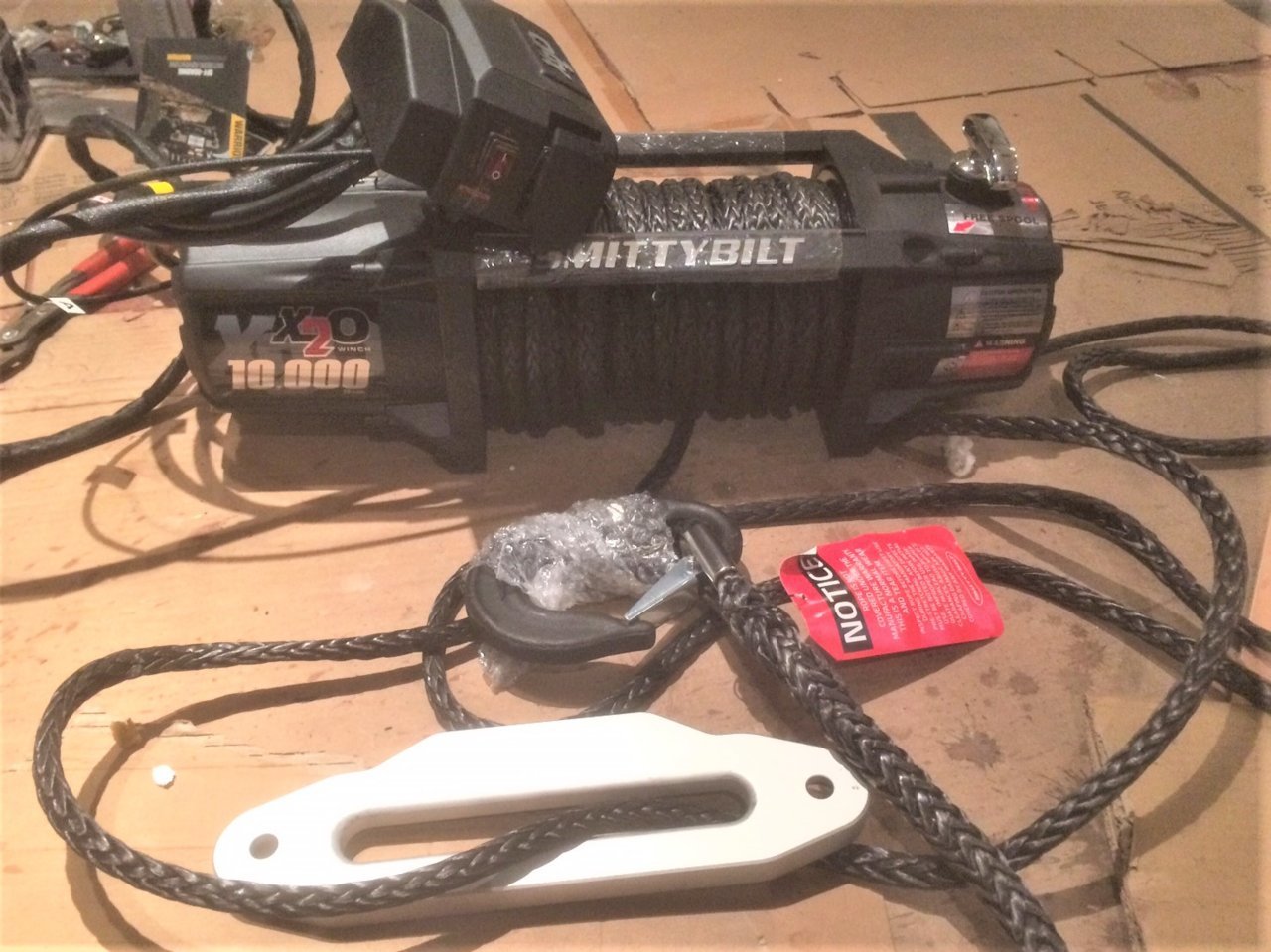

    I went with the Smittybilt X20 Comp this time around. Fits most of the aftermarket bumpers and with the aluminum fairlead and synthetic line , is about 32 lbs lighter than the equivalent steel line and heavier roller fairlead. Also the wireless remote comes in handy with the low pro bumpers. Thats quite a bit less weight hanging out over my front suspension. On previous trucks I have always had Ramsey's and Warns.

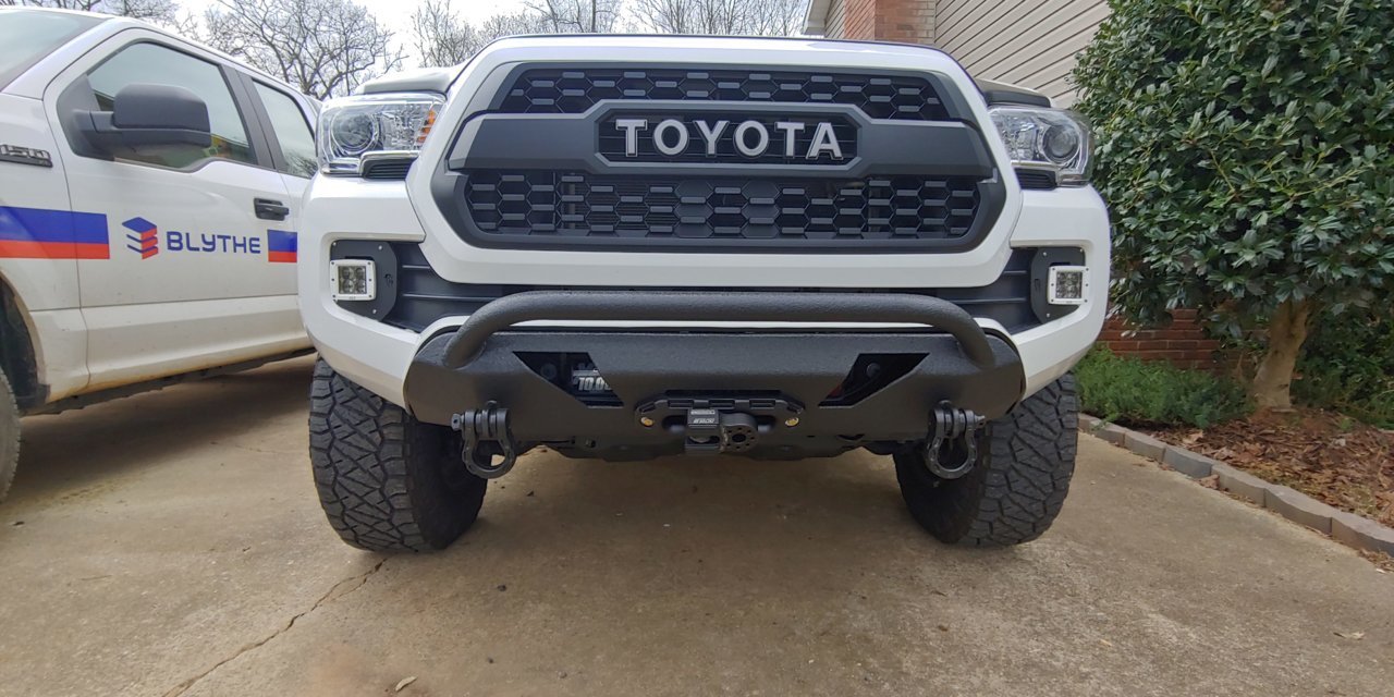

    I guess it depends on what you want. The nice thing about the SOS bumper is that you have access to the clutch lever through the opening in the bumper. You also can reach the plug if you want to used the wired control.

    20200315_164508_HDR.jpg I have the SOS slimline and its a great bumper, and reasonably easy to access the winch controls. The cutout on the left is for the wireless on/off controls or to plug in the wired controller, and the right cutout allows access to the clutch lever (smittybilt x20).
