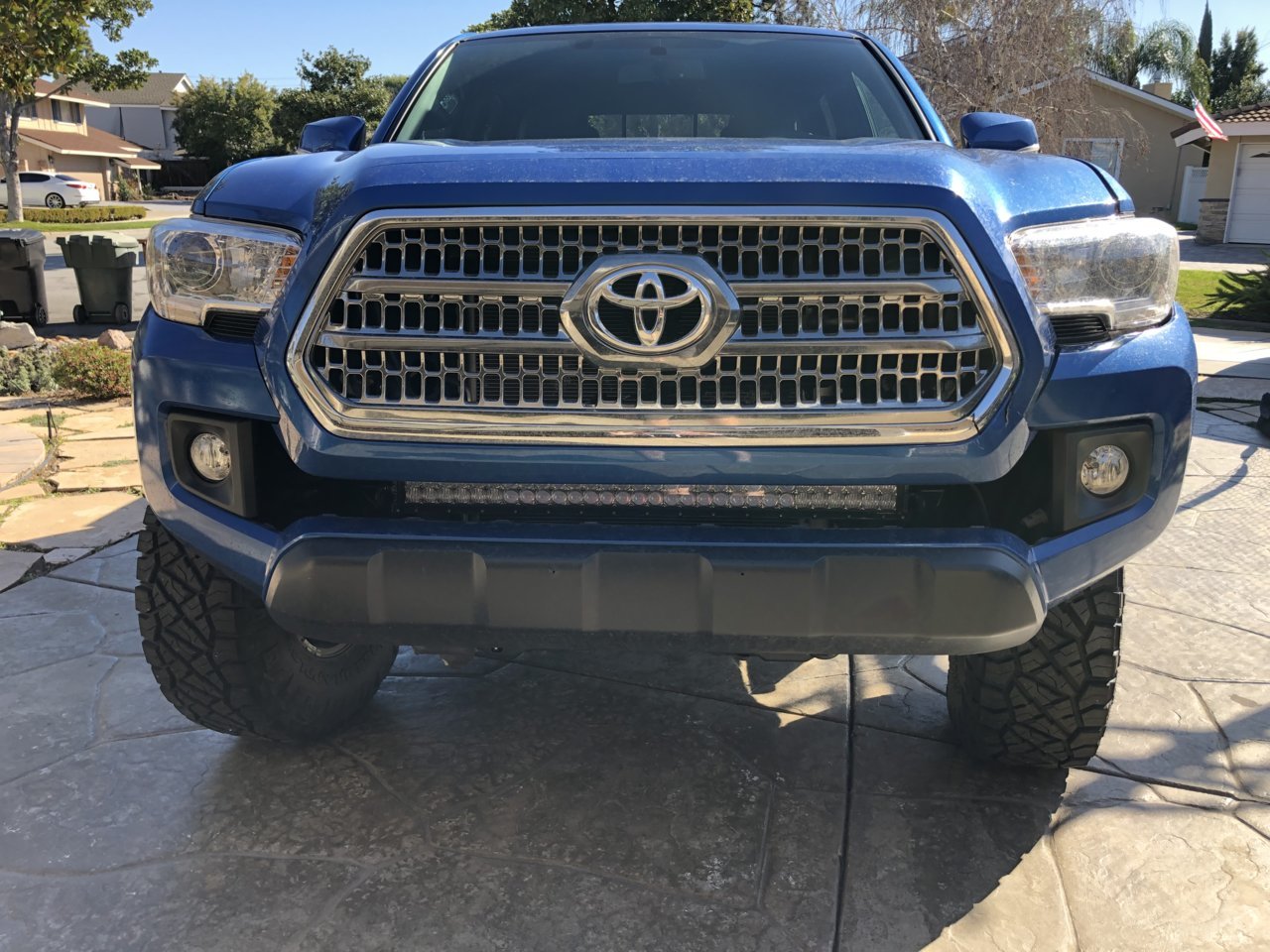

    A5326093-F79F-4499-9937-DD87560A370B.jpg Bashed up front nose on 3 inch thick ice puddle. So I need steel up front and a winch. Bumper has hidden winch and they recommend Warn VR series. What size, cable type, remote style do people use?

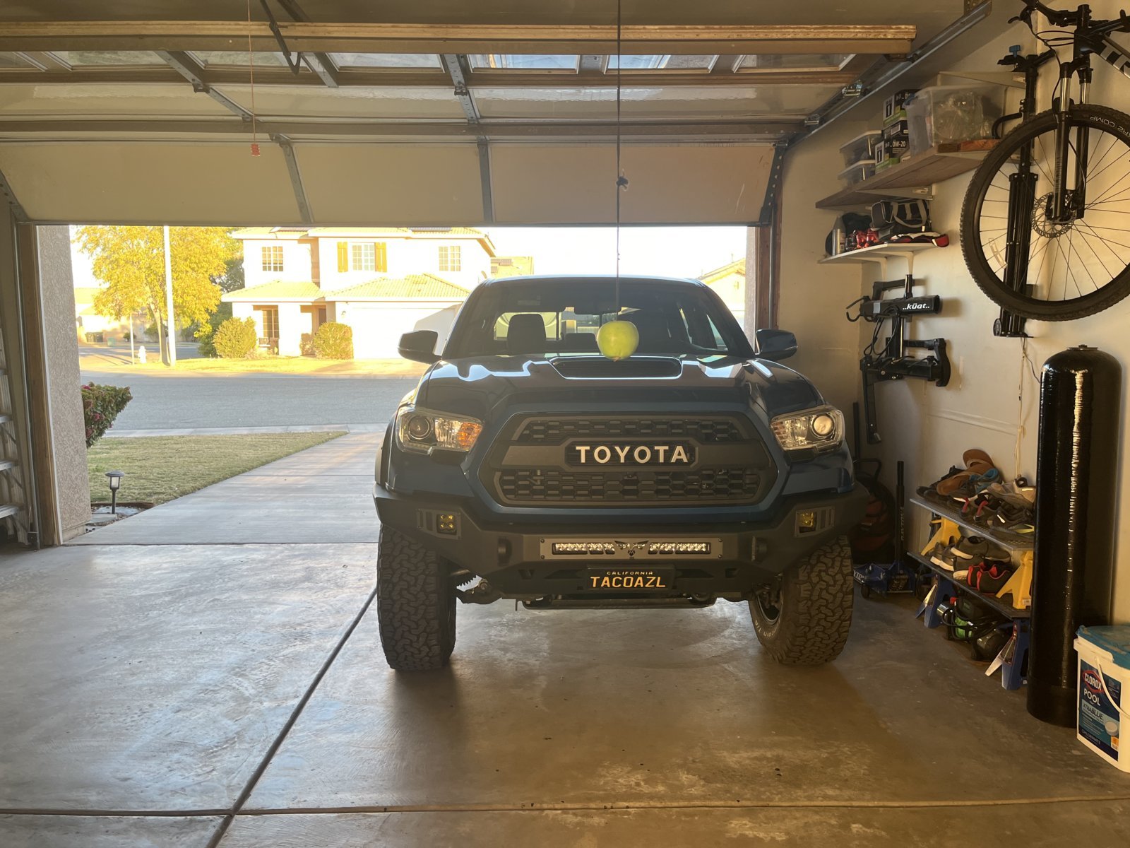

    I really like the Victory 4x4 Strike bumper. I went with the light weight, 48lb, aluminum. I haven't, and probably won't, install my winch on this bumper. I carry a come along with my recovery gear. People see you have a winch and "hey I need you to pull me out." You have a come along and you say "sure, now you ratchet this thing about 572 times and you'll be out in no time."

    Relocating a control pack isn’t too difficult. I used the brackets from the classy taco video and it went fine. Mine is a Warn VR EVO10sin a relentless bumper. A friend of mine put a badlands 10 in a victory bumper and had to relocate the control pack also.
