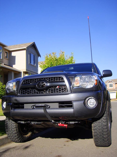

    Alright guys I have been looking all over the interwebs for a video on how to install a hidden winch and mount to my 2015 Tacoma. I have seen a lot of great pics but I need to know how to do this installation and not spend a stupid amount of money to have it done. Does anyone have a video on this? I want to avoid cutting my bumper or drilling holes. The pic below is what I want as a finished product.

    Forgive me if I sound ignorant. Though I am mechanically inclined I have never installed a winch mount before. Will I have to move anything like the radiator? Also, I like your set up. I was hoping to have the winch come out of the area shown in the pic on my post.

    I have a 2014 second gen. My winch mount is not a Hidden Hitch. So; I did not have to move anything, it did take some layout planning. The 10K winch was a tight fit. 10K is over kill for a Tacoma. You can theoretically get by with a 6K winch. The wiring does need planning. A winch can pull 450 Amps at startup. I added a Blue Seas switch and fuse block for the winch and LED lights. The people with super chargers had special considerations. I don't remember what I don't have a SC so didn't pay much attention to that thread, maybe intercoolers.

    No video but I went with the US Offroad bumper also. Pretty easy install, there are instructions on their site. The one you're showing probably involves some welding.

    the picture you posted is a 05-11 model and the bumper design is slightly different, the 2012-2015's have a removeable (clipped on) lower bumper section, that is what is replaced with the winch mount, which blends in similar to the factory plastic but is plate steel and has the tow points.

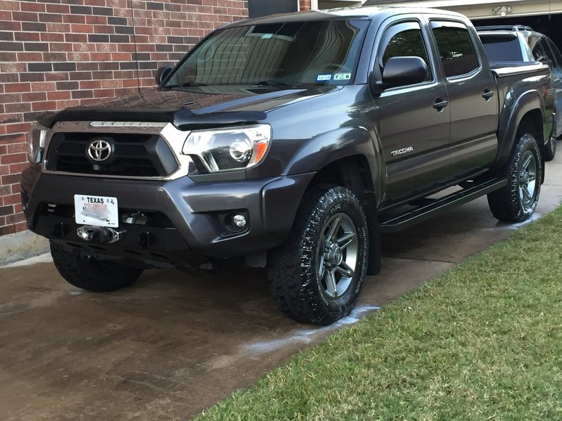

    I like how this is finished up too. Wonder who this belongs to?

    Ohh WOW, I really like that!!! I've been looking at different behind the bumper winch options and so far this is the best one I've seen!!! Getting excited now!!!

    Damnit!! :) I already have it! This should have been done last summer! :) Good luck, ya'll. I hope they hook you up... I am glad I got this for my Taco.
