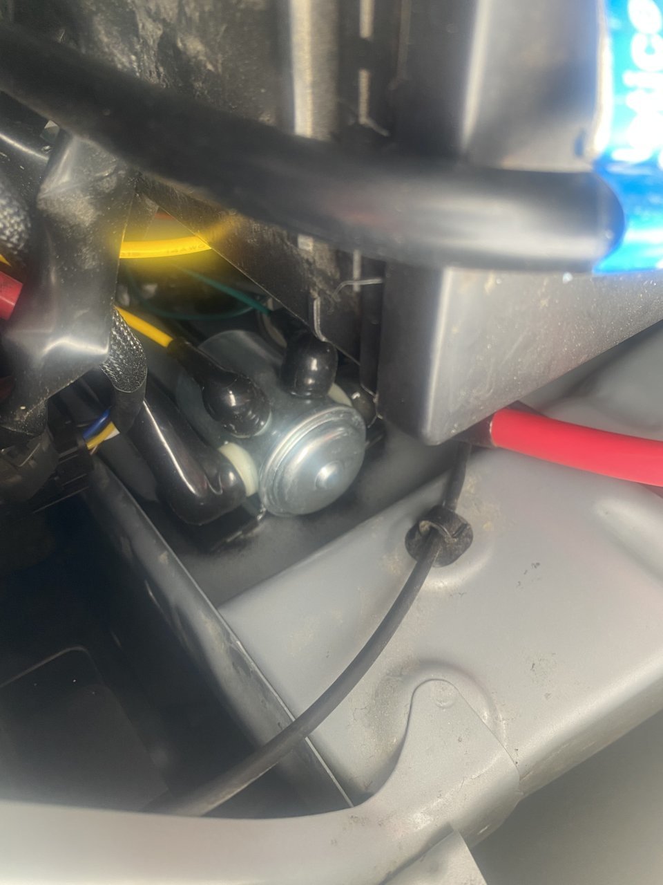

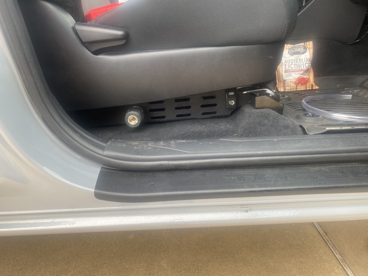

    You can go direct to your battery, add in a fuse, or wire in a remote switch. I agree with JoeCOVA, but I wired in a remote switch anyways with this F205BBBE-EB5C-4886-A550-BF4CD6A42696.jpga remote switch from warn. Mostly because now I can use my winch and not open the hood. Also finished this thing 145972F3-FC8D-4E80-9144-1BE0306F120C.jpg I’m waiting on a harness to wire that switch in. Ps sorry for the awkward camera angles.
