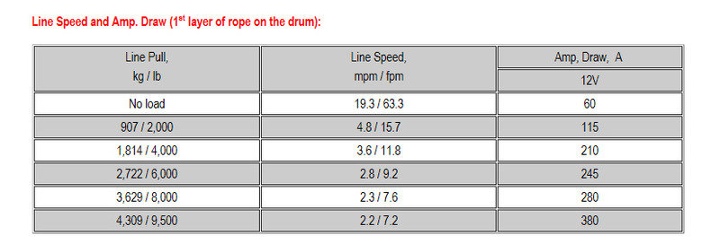

    Here's a similar table for our COMEUP Seal 9.5 winch. Excellent power with faster line speeds than the competition.
