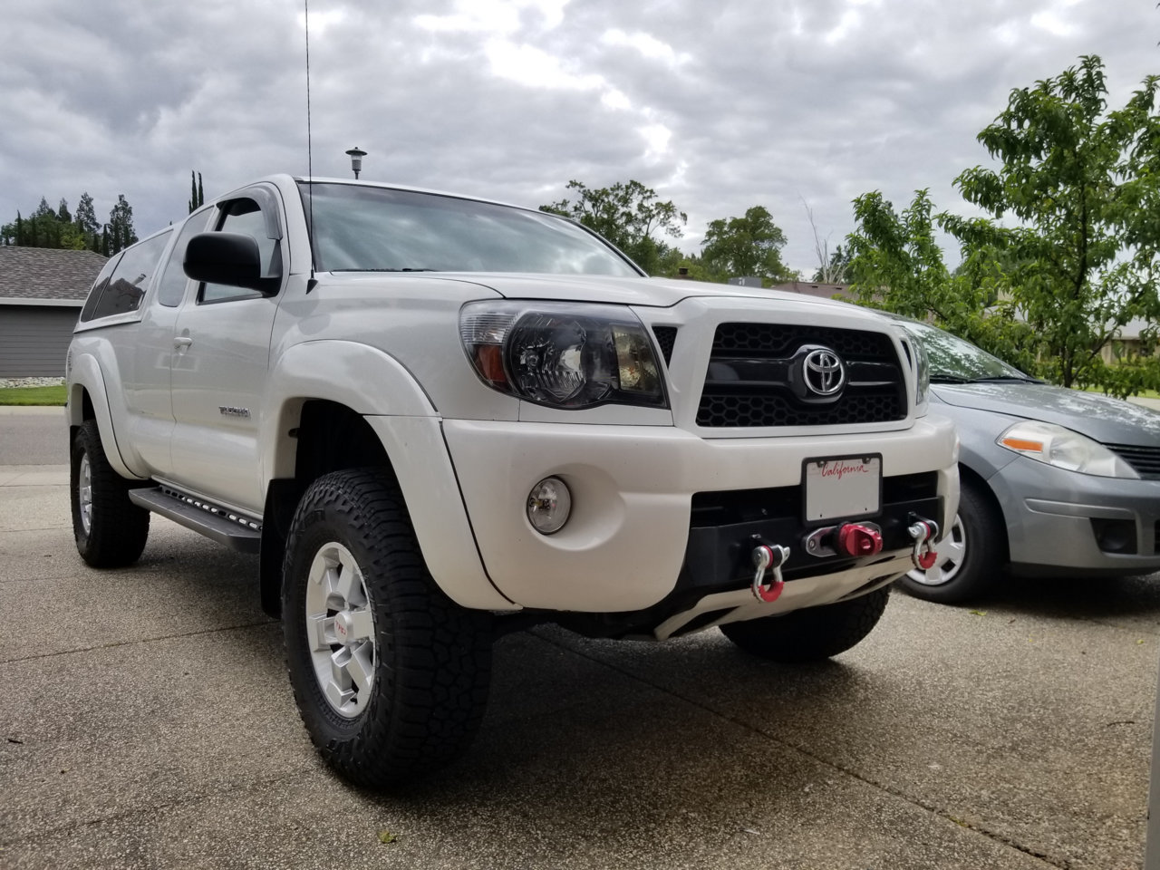

    Another vote for US Offroad...
    Grey 2015 likes this.
