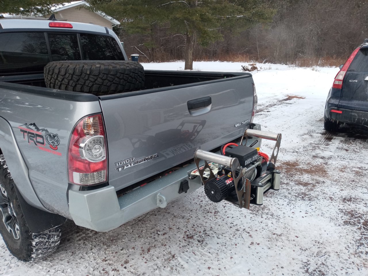

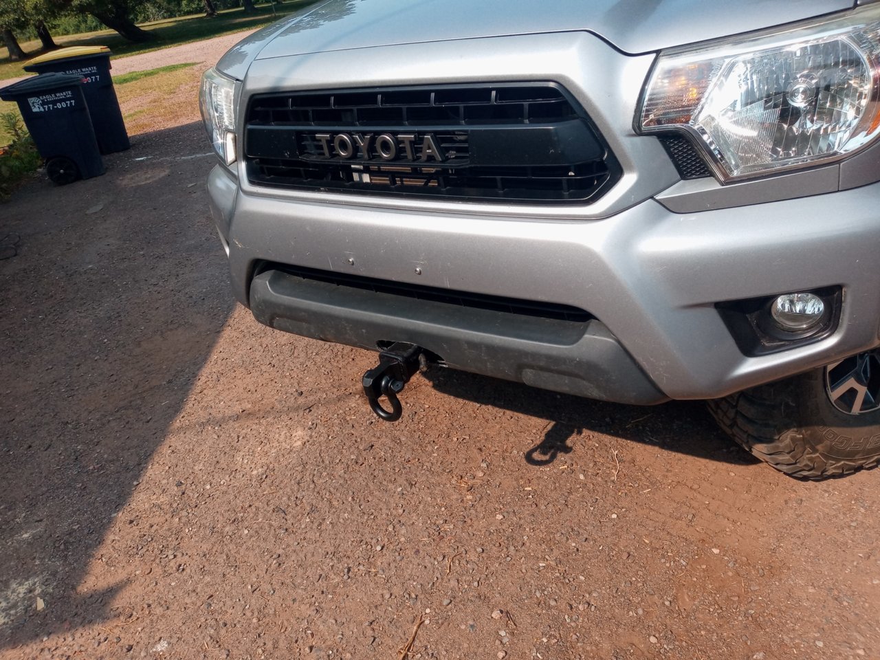

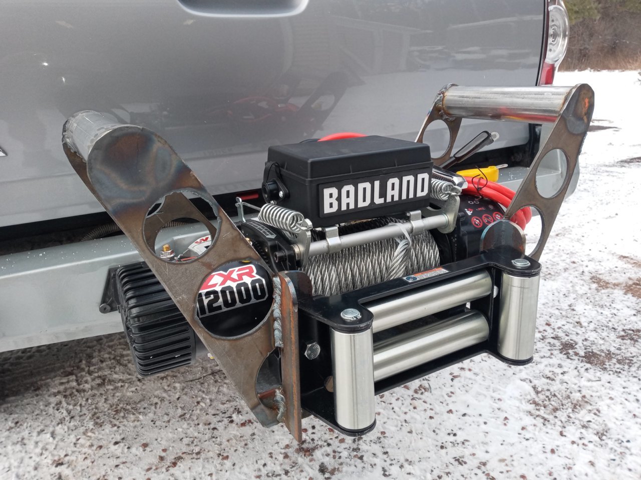

    I put a receiver into to bumper. Looks stock with plate there (sorry don't have a great picture of that...). Winch on a plate goes front or rear. An option.

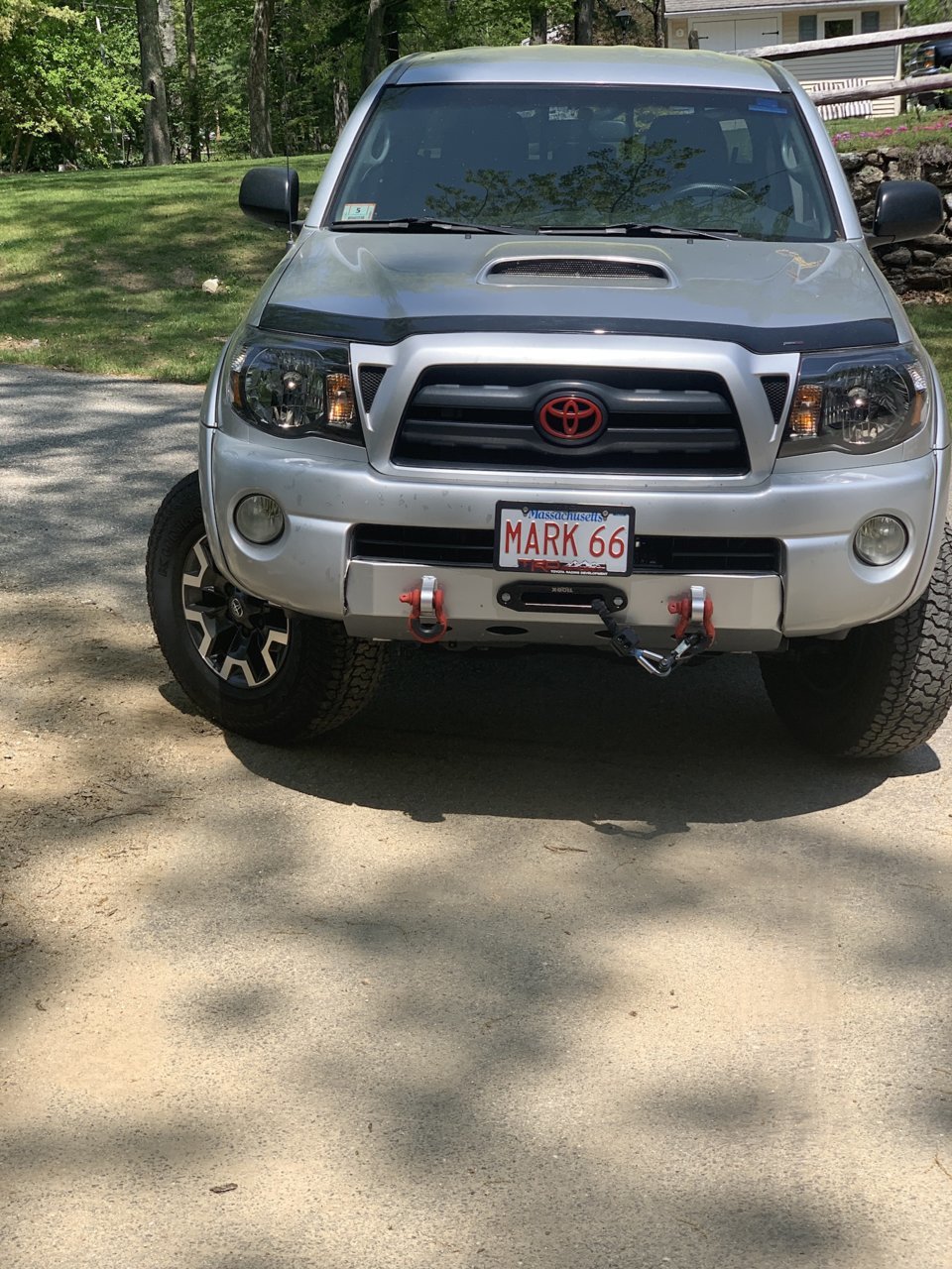

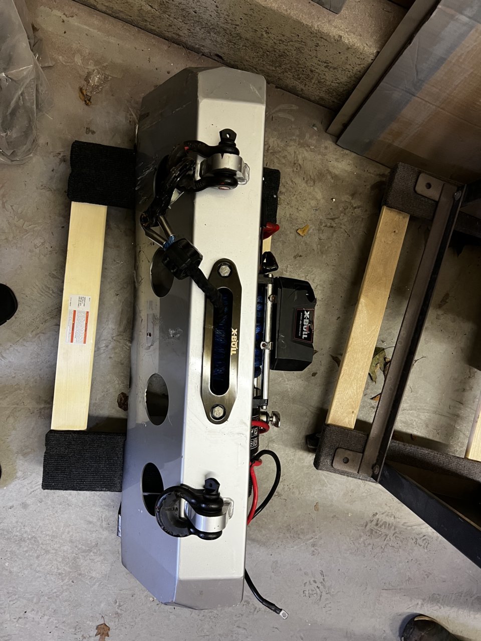

    I may have one for you
    Hidden winch bumper for 2nd Gen
    This is how it looked on my truck

    Does fit 07? Any modification required?

    I think those only fit the 12-15 bumpers. Would it fit an 07?
    At least for the front bumper....thought about rear hitch but already hit my knee enough times on hitch...lol

    Yes:
    2005 - 2015 Tacoma Front Hidden Hitch Receiver

    Loved mine You just have to trim the plastic part of the front grill to get out the winch release lever that is it you remove your aluminum bumper reinforcement and then this bumper slides right on and then your bumper cover slides right over it no issues
