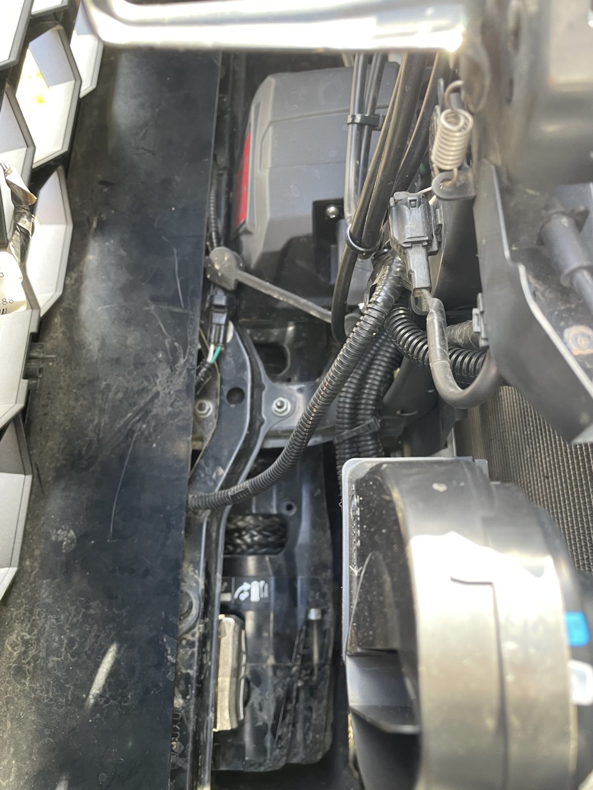

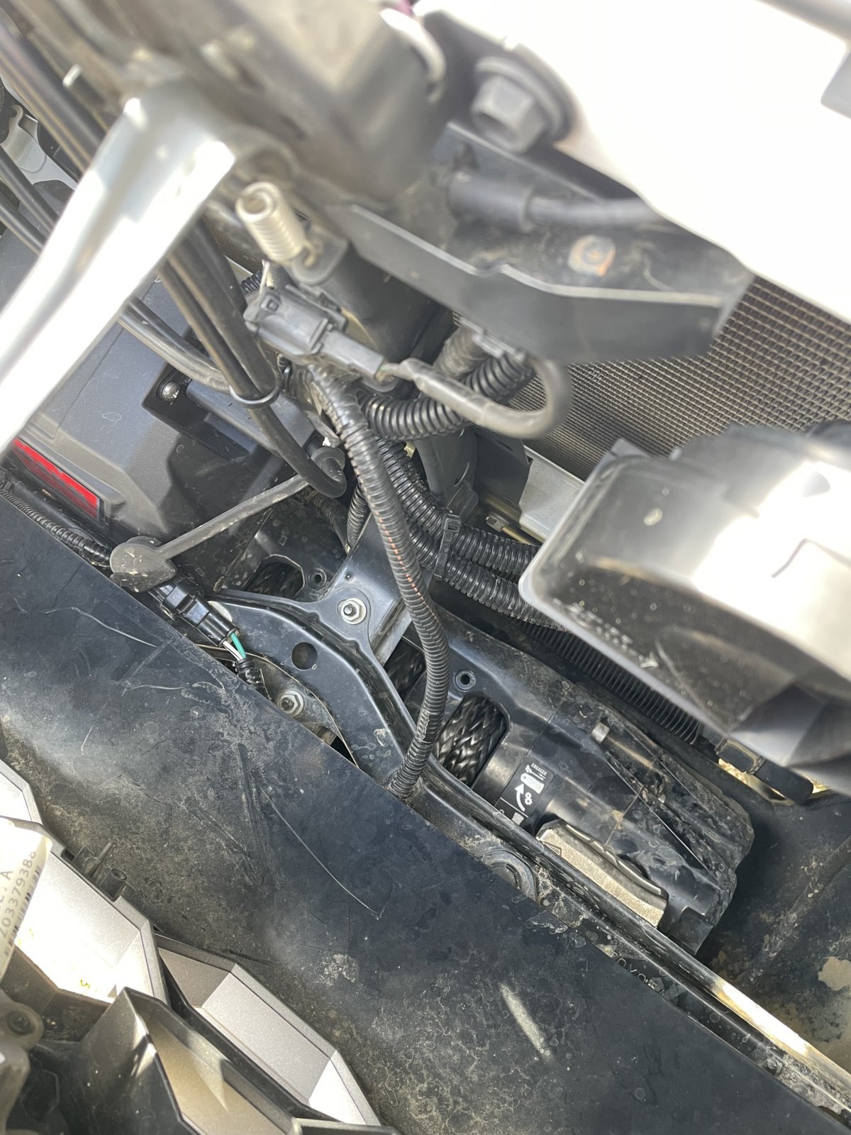

    I put a Warn Evo 10S behind my bumper, relocated the winch control box and didn’t cut any truck parts (for the winch install) and didn’t move the cooling lines.
    I’ll add some pictures in a bit, but in the mean time look up an install video by @ClassyTacos. I used the control box relocation that he came up with.
    ETA: pics
