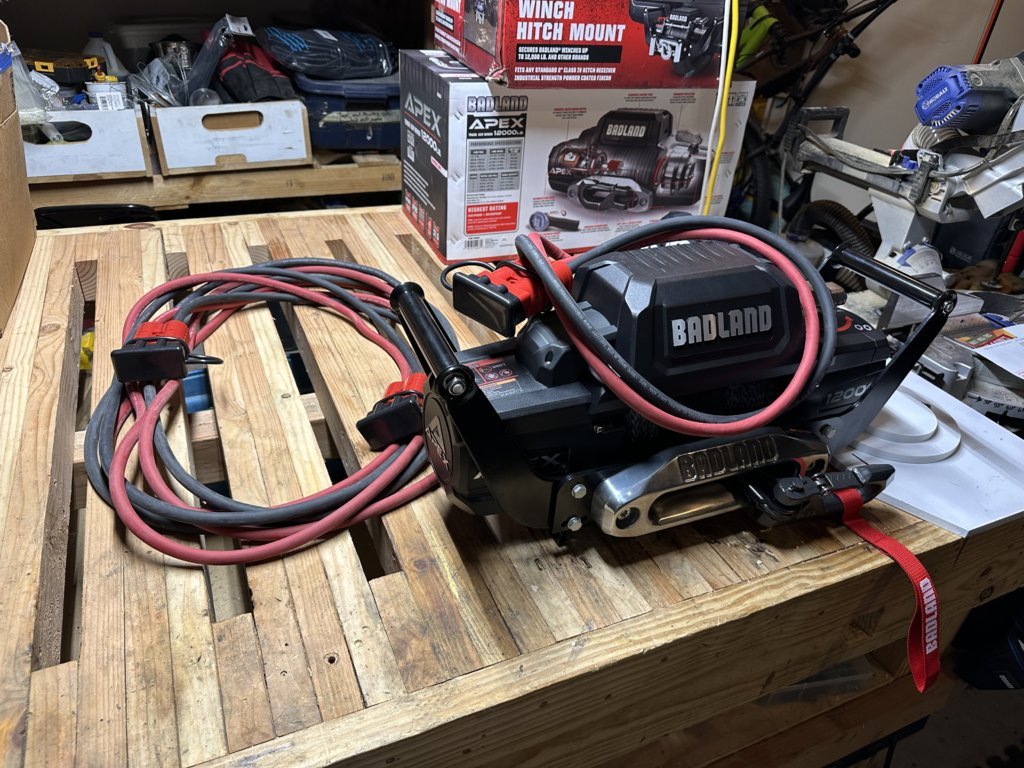

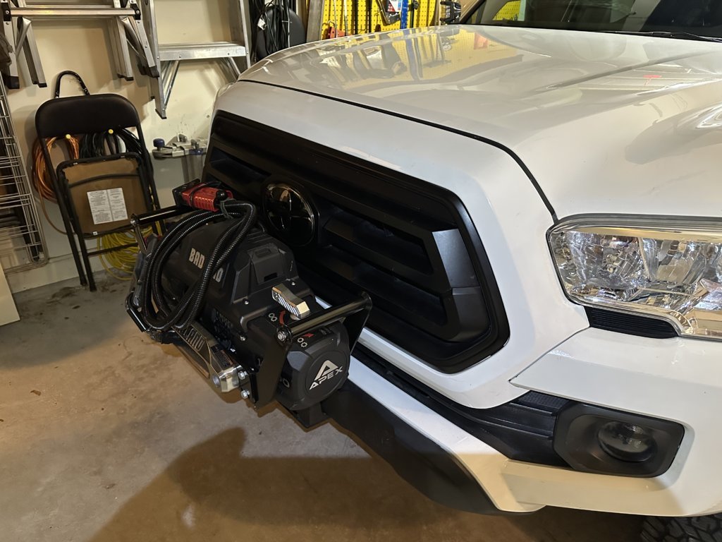

    Why do a brush guard and a bumper replacement? Why not just get a nice steel bumper?
    Edit: I did the 4x Innovations hidden hitch and portable winch cradle with the badlands winch, so I'm happy to answer any questions about that if you end up leaning that direction.

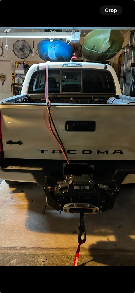

    I like that this could be used in front or rear. Many times the quicker way out is back.

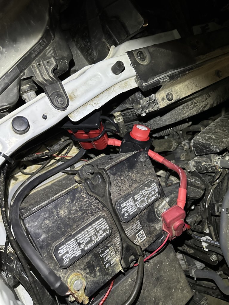

    How are you guys running power to the rear? Heavy gauge wire to the front? Spare battery in the bed?

    depending on how handy you are, there's also portable winches, or you could make your own portable winch, if you'd like to only keep it stowed in the back of the truck for the emergency instead of hard-mounted to a specific part of the truck.
    like this one that's rated to 4500 pounds. double up the line with a pulley and you're at 9,000 pounds pulling. triple the line with another pulley and you're at 13,500 pulling power.
    https://www.amazon.com/RUGCEL-WINCH-Electric-Integrated-Synthetic/dp/B0D12TXRVR
    but that's really not any more than a fancy mounting plate and a plastic case with some strategic holes cut into it. the winch is a bog-standard 4500 pound winch, just in a special case.
    the idea is there if you're handy. that's just a bog-standard 4500 pound winch on a different type of metal plate, with a fancy box around it-- you could easily re-purpose a 12,000 pound winch in the same way with a hitch receiver plate and a two longer soft shackles to the front a-arms. it would mean the winch plate would drag in the snow/mud once the line tension drops, which might mean more cleaning later, but would give you options for front and rear pulls without hard-mounting anything. and with a good number of soft shackles, you'd likely also find it useful for other movement opportunities with downed tree's.

    I have 2/0 wire and Anderson style connectors for everything. I have a run of wire coming off the winch (rewired direct to the winch to ensure everything is 2/0 because I'm not sure of the original wire gauge) to a connector on about 4 feet of wire, long enough to get to the battery where I have another connector on a disconnect switch wired permanently into the battery. I also have a 20 foot or so run of wire with connectors on each end that'll reach the back. I just lay it over the truck roof and bed if I need to run it to the rear. I may eventually mount the long wires under the truck, but they are so thick they would end up having to run close to the exhaust in a place or two, and I'm not sure about the heat or heat shielding options. Also hot wire conducts electricity less efficiently as I understand it, and keeping it unmounted just ensures it doesn't get harmed by the elements.
    Notoneiota[QUOTED] likes this.
