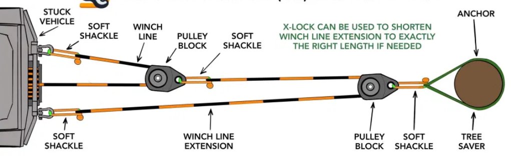

    We should probably stop trying to extract submarines from gumbo. If you can raise the truck you don't need more winch. Instead of the jib used in this video, set a hi-lift jack on a recovery board and run the line through a change of direction at the top. If no one has a farm jack, a 3 ft long sturdy log that is 12 inches square in cross section (aka. the size of a 4x4 piece of lumber) vertically supports more than 15,000 lbs. Up then over:
    https://www.youtube.com/watch?v=eZjqEC_FWqo
    That's not my video. I was going to also do that in the ATV winch video but since it's relevant now ¯\_(ツ)_/¯. These are just bastardizations of high angle and confined space rescue concepts.
    I suspect most people who do 4:1's for vehicle recovery use the spanish burton (see below), which is easy to learn and build, doesn't require a double sheave pulley, and is quick to set up. There are other ways to do it, which have advantages such as not needing multiple recovery points on the vehicle, or can be rigged at home then collapsed and stored in a bag, just depending on what's important.
