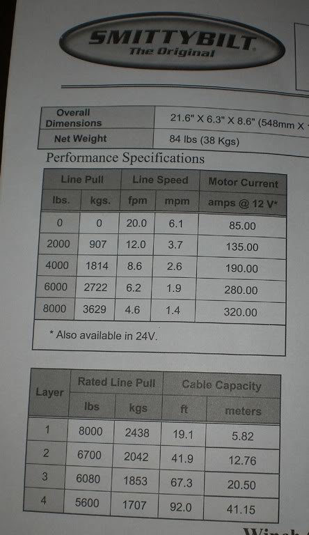

    Here's an example of the different pulling rates at different layers...

    yep i think i posted one for a Warn in my winching thread every one should have theirs, they are easy to get to. just google em. I keep mine laminated on a ID size card. but then again I try to be crazy exact when it comes to winching. Its part of my job and i like to use the formula so as to waste no time or unnecessary energy and rigging.
    you also have to think that the more snatch blocks you put in even if they are not necessary will require less force from your winch which will keep you on the lighter side of the pulling chart which will require less amps from your battery. just another thing for people to think about.

    This is true and of course the practice that has always been taught but remember that when your winch is at its most powerful it is also going to be pulling more amps from the battery. there are easier ways to get more power and stay at the low end of the amp draw like a snatch block.
    remember that just because youre line is run out to the last layer does not mean youre winch is pulling at it's best. what it pulls is based on the weight of the actually recovered vehicle. so dont go pulling all your line out just because you want more power, it may not even be necessary:)
    going to the next layer or two only ads a few hundered lbs of pull each layer any ways and i would think that a couple layers could get you one more snatch block which would double your winches pull, adding 1000's of lbs of force to your winch.
    1/9500
    2/8650
    3/7920
    4/7400
    5/6940
    This is for a Warn 9.5ti
    if i was recovering a load that requuired 9000lbs of pull, typically you would jsut pay out all your line right? NO!!!! Paying out your line to about the 3rd layer and adding a snatch block will give you 7920 X 2= 15840 so why pay it all out?????
    Obviously how close you can even get to the load that needs recovering may show that to even add a block you would be paid out to the last layer anyways but situation dictates. just want to clear it up so we dont have Novices out there paying all thier line out EVERY time they need to recover :)
    Dont for get respooling sucks so it is nice to have extensions like Timmer noted. and it will allow you to use snatch blocks while having the greatest amount of wraps on the drum thus leaving those perfectly wrapped layers still on the drum. Also the 5th layer (or the 1st layer depending on how you want to look at it) pulls 6940 so if i can use an extension and stay at that layer or the 4th one and add a snatch block then i am actually pulling 13880-14800 lbs. so why even pay all my line out?????? jsut something for you to think about.
