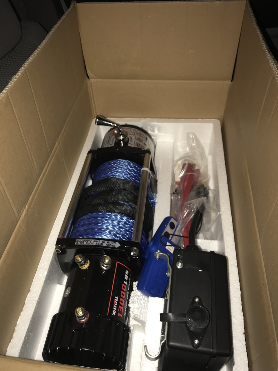

    I have a brand new HF 12000 winch I'm going to rework soon and take some 4000 grit to and polish up what I can.i know Lucas but I don't know power punch how is the quality.

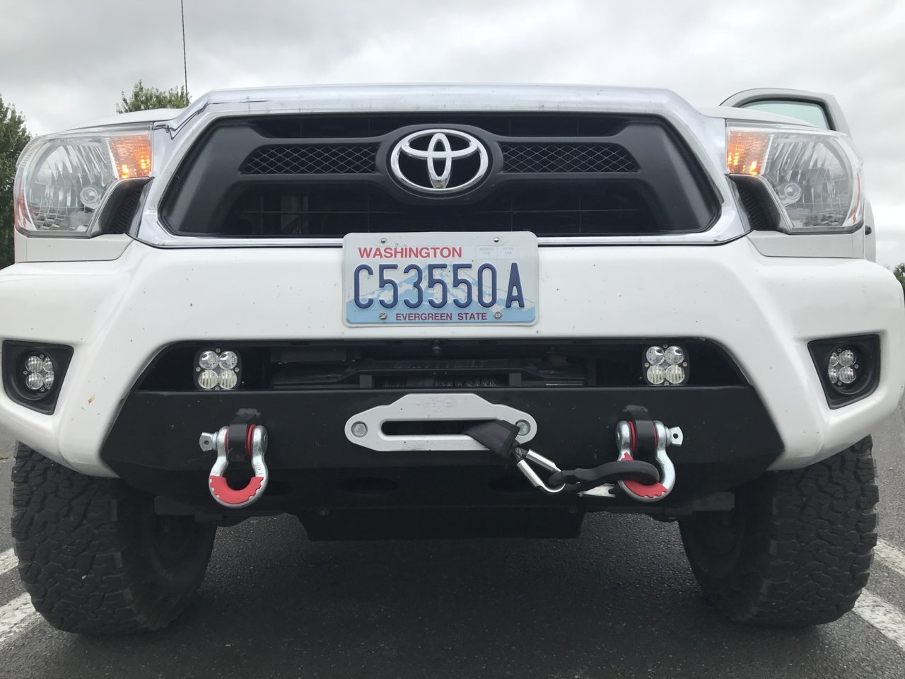

    Smittybilt x20 10k have only used it twice and have had no problems. I change the battery in the remote when I change the ones in my smoke detectors. I do unspool it twice a year just to help keep it lubed. I also test it out before i go wheeling to make sure it will work when i need it.
