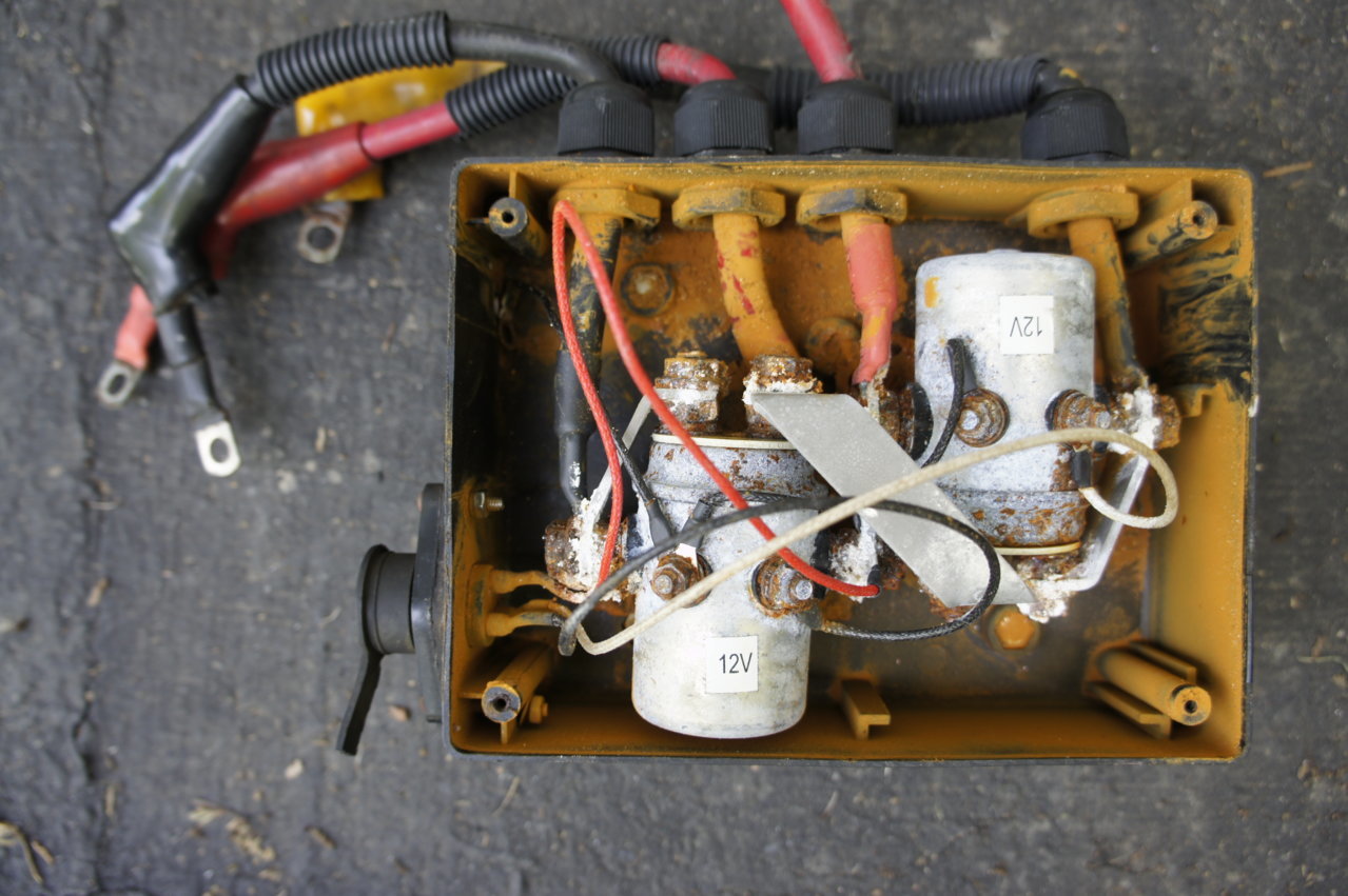

    $70 dollars delivered for a new solenoid box isn't bad.:notsure: I moved the new solenoid box to a vertical location, sealed the cover with goop and then taped it. I also added a drain/vent to the bottom so water can't pool over 1/4 inch.
    Original location:
    New vertical location:
