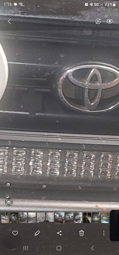

    Take it apart and make a new mount for it. The wires on mine were long enough to mount behind the bumper. I extended the controller socket wires, and flush mounted it into the grille.
    I don't take a lot of pictures of my truck, this shows where the controller plugs in.
