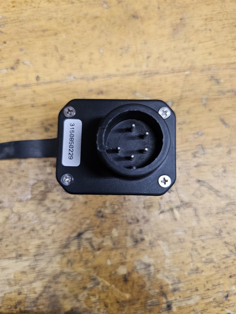

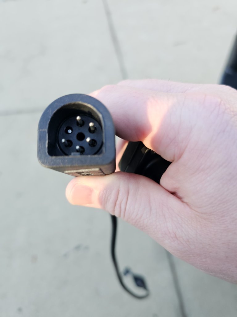

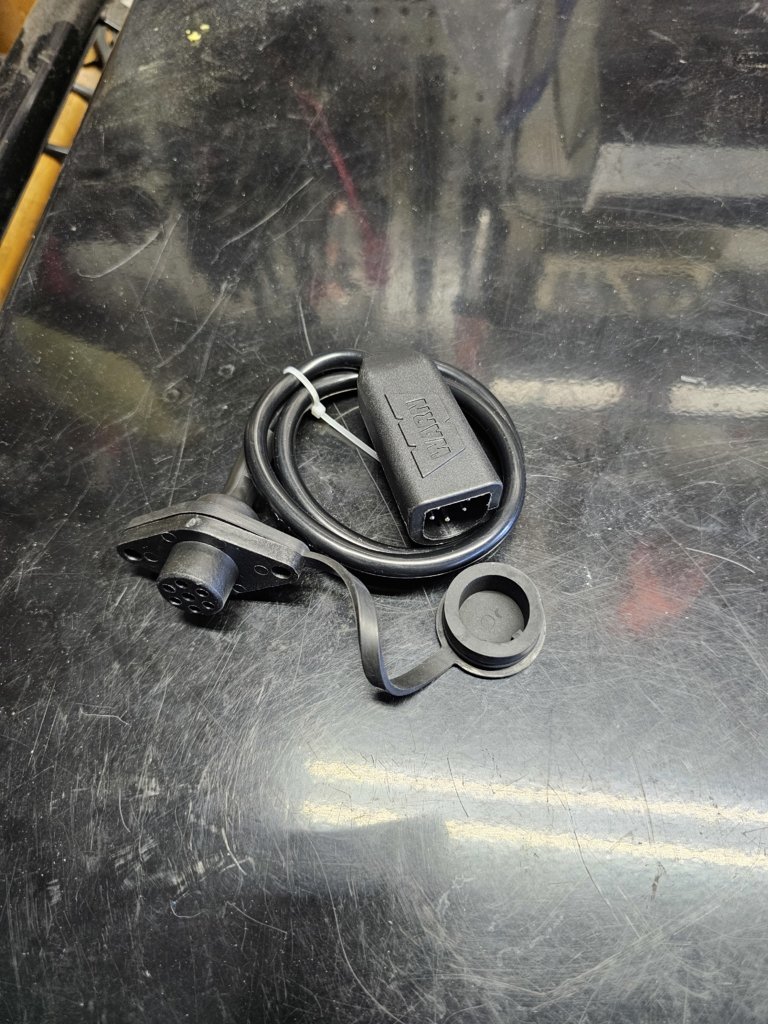

    Ok I solved this issue by using a warn remote extention. It was the perfect size move the plug where it was at the top of my grill. It's a six pin wire so I have to shove one pin back into the house. Hope this helps anyone else with a simular problem.20241024_170257.jpg 20241024_171024.jpg
    WARN 98348
    helix66, soundman98 and daveeasa like this.
