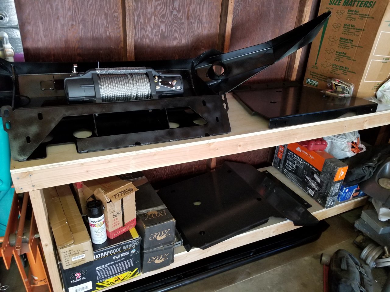

  17. Feb 5, 2020 at 3:23 PM
    #17
    Track
    Track Well-Known Member
    Oct 4, 2017
    #232013
    138
    Tuck
    Florida
    2017 TRD offroad
    MobTown bed racks MobTown sliders and skid ARB onboard air
    This is my setup with Warn’s 10k. To be honest I have used the straps more then the winch, but that said I still want that winch.
