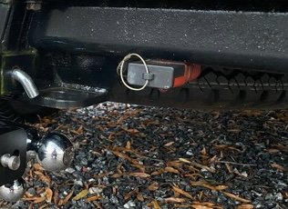

    Mine is like this, I ran these warn ends on the front and rear of both my trucks so I use it front or rear, and keep it out of the wether when not needed.
