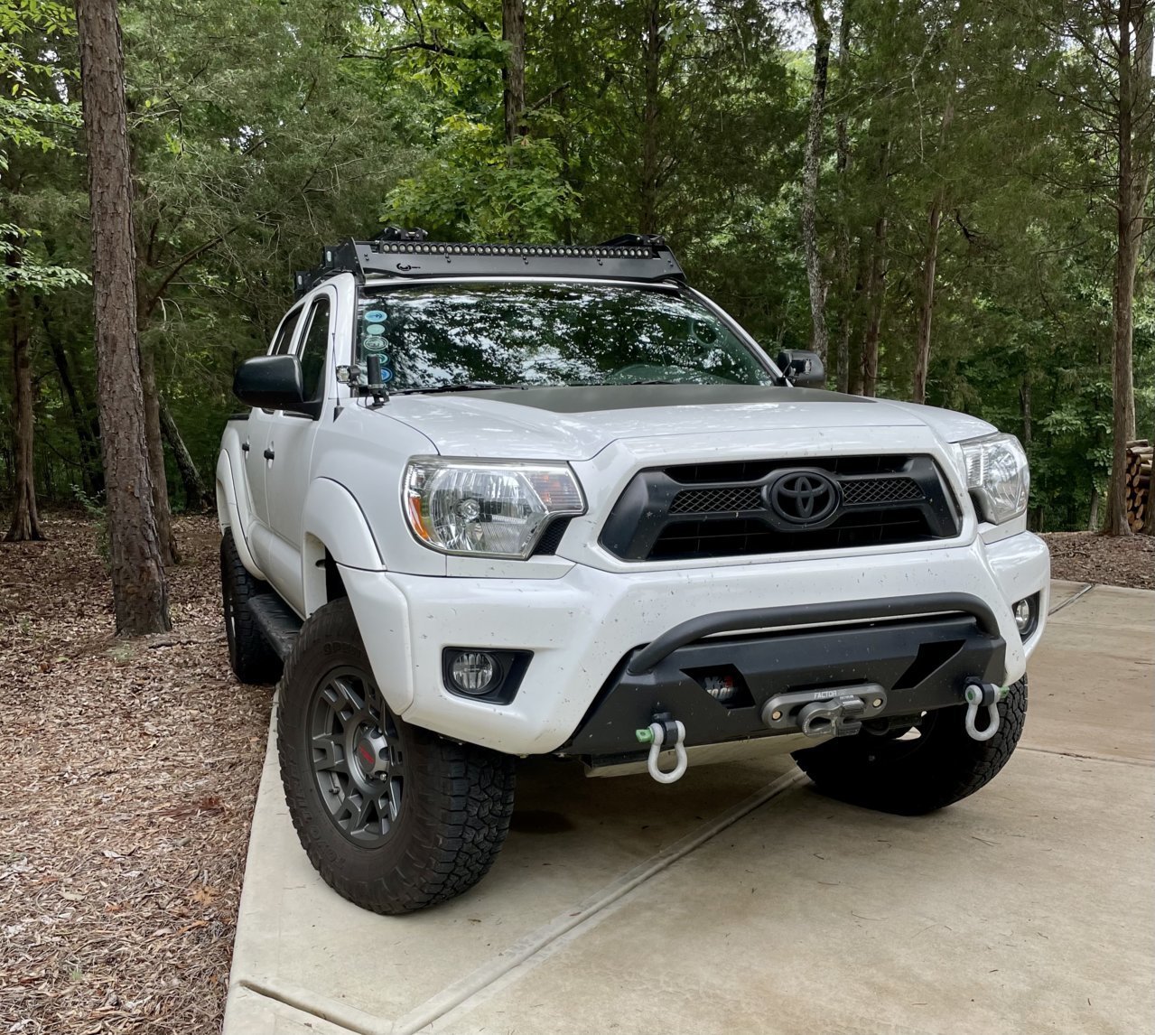

    22 Tremor 402A, 22 T4R ORP
    Most 10k winches should fit. Smittybilt X20 works for me.

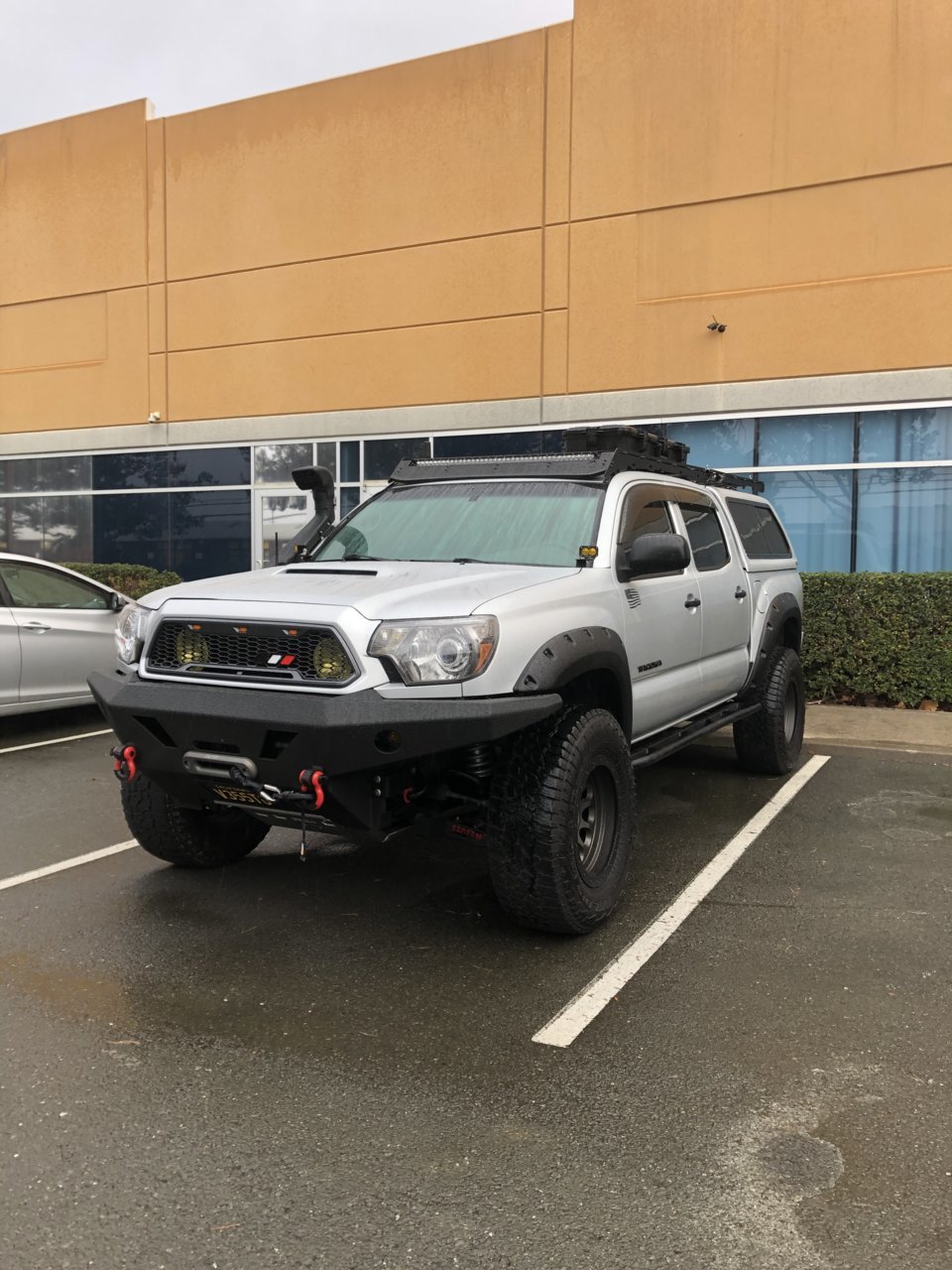

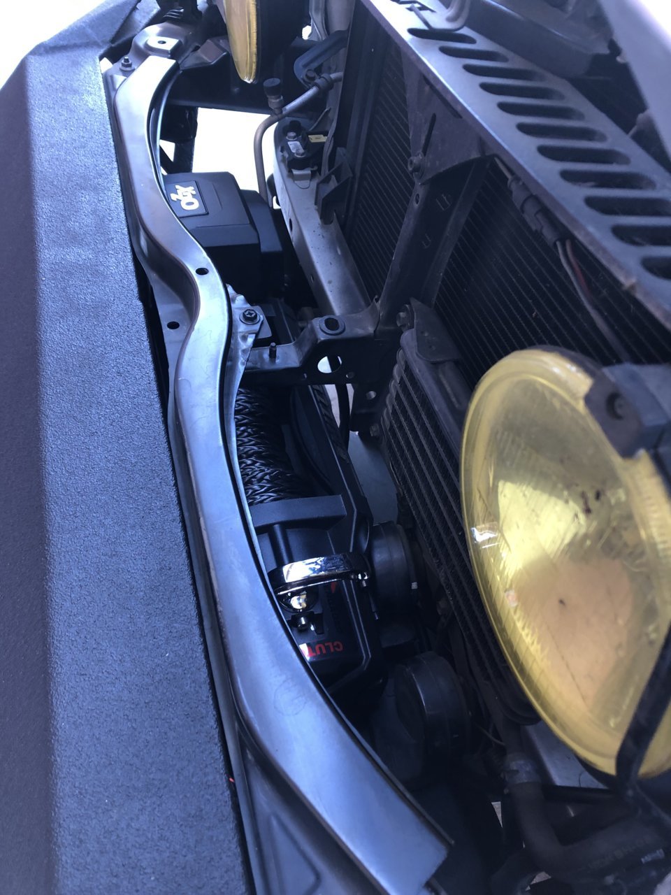

  9. Aug 12, 2021 at 12:23 AM
    outxider
    outxider Never stop exploring. Rest in Paradise Big Bro.
    May 9, 2010
    #36858
    2,081
    Sang
    East Bay, CA
    06 DCSB 4x4
    A few mods here and there and counting....
    Smittybilt X20 fits perfectly. Solenoid box moved to the left side w provided hardware.
    GOZER[OP] likes this.
