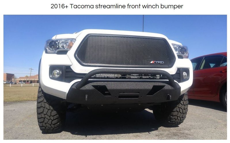

    this is a SOSOFFROADCONCEPTS bumper for the 2016+ [​IMG]
    scc[OP] likes this.
