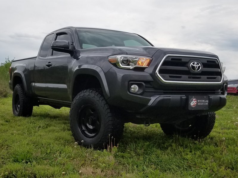

    Has anyone used a trailer hitch mounted winch? I don't like most of the bumpers that are out now and don't wheel a lot, but when I do I'm alone, so I'm needing a winch. Been looking at the hitch mounted one's where I could use front and rear. 20170429_102348.jpg

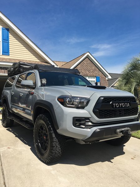

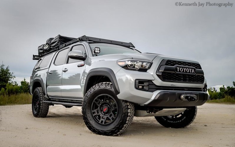

    Look at my front bumper. I have a @CBI Offroad Fab hidden winch mount run through a farelead in the bumper.
    Nice! Secure! And clean!

    It's pretty easy... it's all bolt on.... I run the Warn Zeon 8s, but you can easily get a 10k in there. There's so much room between the front bumper and your radiator. Just have to trim a little black plastic trim on the inside, but it's not there for anything

    If you go hidden winch, you'd need one with synthetic line to get a hawse fairlead like that. The steel cable requires a roller fairlead. Not a bad thing though because you save weight too.

    Wow, that is super clean!
    Was there much (if any) sag with the weight of the winch?

    I didn't measure it before, but I didn't notice any. Adding bigger tires made up for it though.
