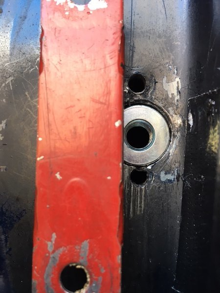

    I had the same thing happen, bent the top hinge. The door is bulged out a bit just below the window because of it. Also ripped the check (limiter) bolt out of the pillar. The nut (which was spot welded inside the pillar) is also gone, down inside the pillar. I have drilled the hole out with a step bit to the size of an 8mm flange nut, which will be welded in place. I don't have a mig welder, so I'm having the whole job done at a body shop I trust, estimate about $200, if he doesn't find any other damage. Ins. would cover it, but I didn't make a claim, cheaper in the long run.
    I had better luck searching for a door check, rather than limiter. Found an OEM on ebay for $80, comes from Tampa Bay Toyota.
    Photo is a flange nut held in place by a magnet, ready to weld. Two small extra holes are from a first attempt to attach a small strip of 1/8" aluminum w/8mm threaded center hole which worked ok temporarily, but the otherwise perfect truck is worthy of a better fix.
    Thanks all for a wealth of information on this obscure topic!
    Additional: Fix completed. R&R top hinge, weld in new nut and fill extra holes, paint touch-up, took 2 hrs. cost $200, then I changed the door check myself, by removing the door panel, pulling the check out through an existing hole, about 15 minutes, no more pop! Glad to have it fixed!
