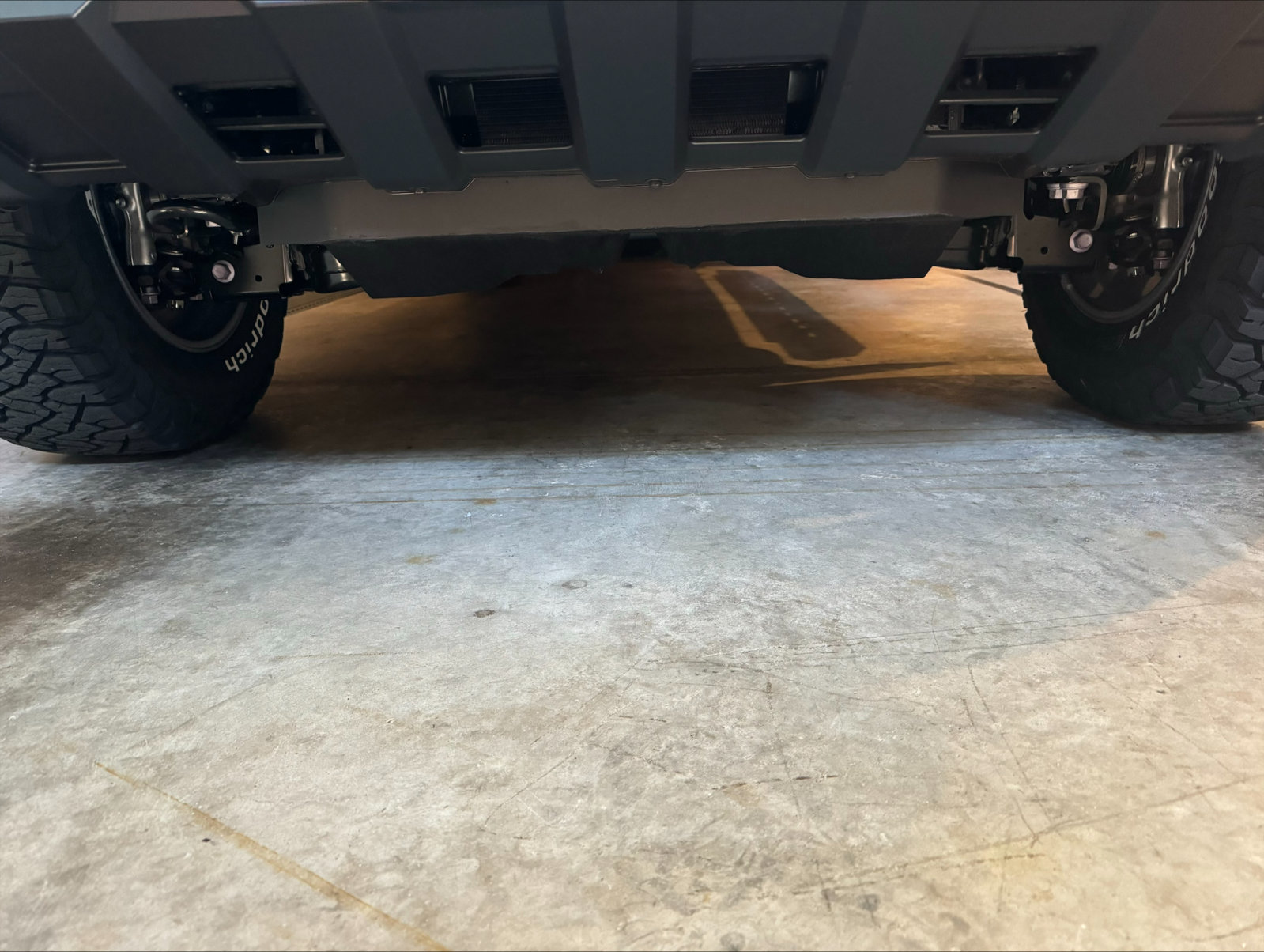

    I've noticed a howling wind noise when I reach 30 mph with my 2024 Sport Premium. I took off the ugly chin spoiler now the dealership says that's what's causing this issue... Anyone else with a removed spoiler get a similar noise? I used to have a roof rack with bikes and kayaks on my 2020 and never got the slightest wind noise...
    I somehow doubt something being under the nose of the truck would produce this loud of wind noise or we'd call it a siren!

    I added the main front section back in after cutting to cover the wind chime slots, also tucked in the felt liner into the bolted areas.processed-39225A86-C7F9-4CE9-B755-8809474C7FDC.jpg

    So I re-installed the spoiler this morning and it looks like it took care of the howling noise. That brings more questions now. I wonder why this doesn't seem to happen to others on here who have taken it off?? Would the reason Toyota have these spoilers to prevent this and help with gas mileage? In any event, this will be a debate over which of my senses I have to deal with; looking at that awful spoiler or hearing some howling sound caused by removing it...

    Interesting.
    Maybe you can find someone with an OR to park right next to you and compare specifics under the leading edge of the truck with your dam back off
    Barring that, crisp pics of that area on an OR at the dealer to compare with yours.
