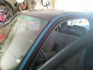

    so i found out where noise is coming from. ive looked at multiple threads and havent found answer yet, or havent looked in right thread. now i know where problem is, now not sure what/how to fix it. any help would be greatly appreciated. thanks in advance!

    Old bodyshop trick. Open the window an pull on the top of door (around he top of the window) and place your knee on the inside of the door to keep it stable. Don't crank on it too hard just a little tweak. Sometime that little bit is enough to fix a wind noise.:)

    Kk. Ill give it a shot. Both seals/doors are makin screaming mimi sounds right about grab handles.

    don't know if this will help, but if your door seals are dirty, or have dried out, or before you got the truck had dried out and are stiff, a ol trick is to rub some Vaseline on the seals and see if it stops the noise.
