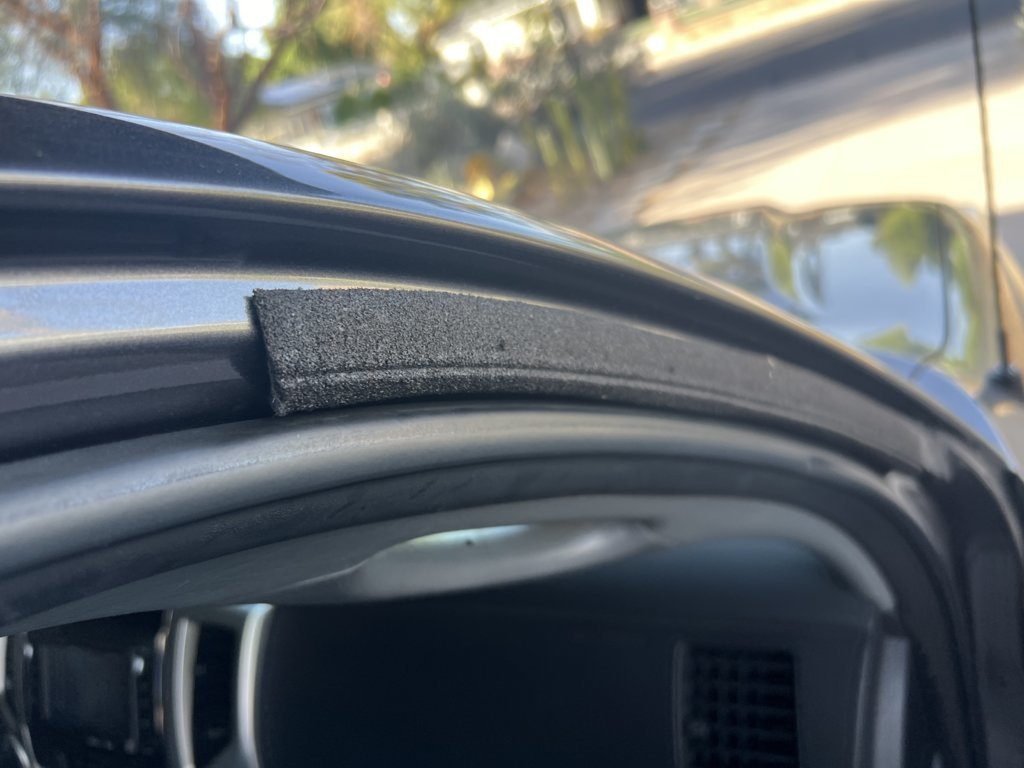

    I have a 2015 Tacoma. I found at highway speeds (and typically only when there was a crosswind) my rider's side window or door frame made this loud whistling sound. It took me forever, but I finally figured out that it was the door frame, and was able to fix it. I bought a roll of foam (with a sticky side) from Home Depot and ran it inside the door frame between the door and body.

    yes. Everything is aligned. This is a super common problem I have read on this community. I finally figured out how to stop it and so I wanted to post my solution here.
